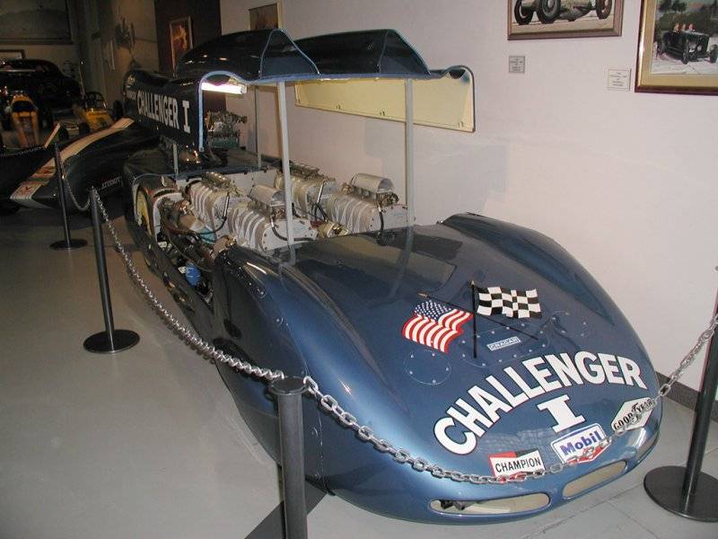

Mickey Thompson, in his biography, said that he had no use for engineers. While they plodded along and figured out every scenario, he had already tried five or six different experiments and found what he needed, and moved on to a different problem. :)
