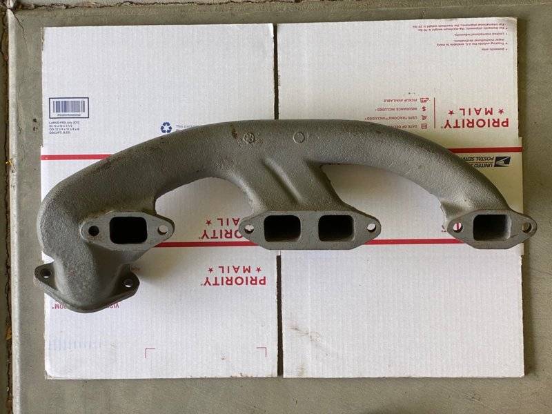

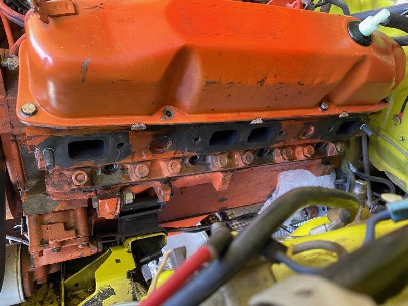

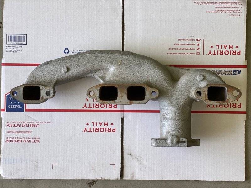

Did you make sure your header exhaust port surface was totally flat. Mine has some of the paint worn off of it, and carbon deposits here and there. I wonder if the Remflex would seal to my surface as seen in the photo, of if I will have to try scrap all of that off with a razor blade or some other scraping tool?
My existing exhaust pipes bolted up to 3.5" header collectors and are welded to the input side of Flow Master mufflers. I will need to have new pipe run from the manifold exit flanges to the mufflers. I hope the existing pipes can be un-welded from the mufflers and new pipes welded back on to them.

Yep I've got a 383 and am in the minority of preference of exhaust manifolds over headers. I used felpro flange gaskets with a generous bead of ultra copper.
One of my manifolds is flat and the other was slightly warped. The remflex sealed great. Don't over torque.
