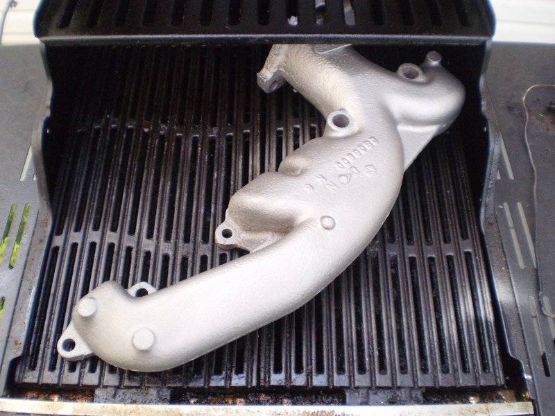

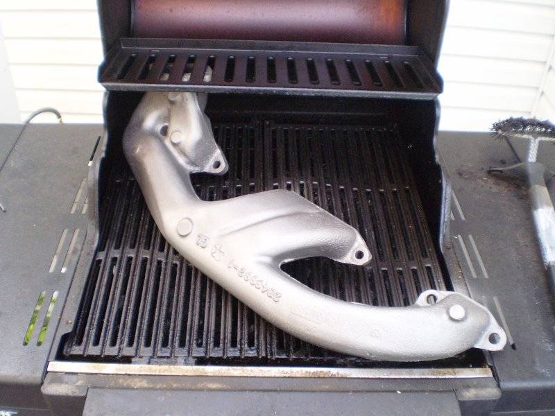

Did you blast them clean and then bake and cure the paint before install. I have over 3500 miles on mine now and still look fine...
I used VHT cast iron high heat paint and baked and cured it on my Barbeque per instructions on can. My wife doesn't let me use her oven any more. LOL
What these guys ^^^ said. Shake and bake. Shake the can, bake the manifolds.

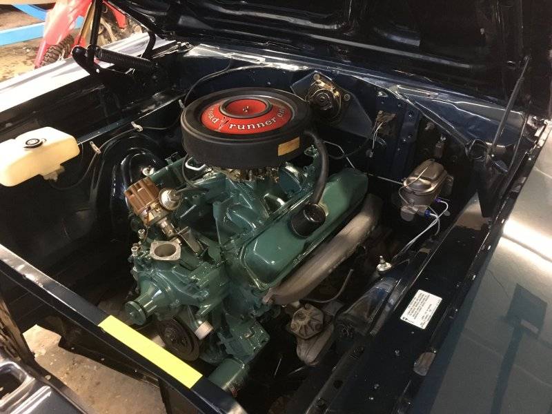

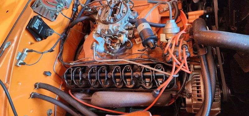

A lot of guys on here don't like POR 15 products, but I bead blast my manifolds and use their cast blast brush on coating. Once the engine is cranked the manifolds will smoke and cure with the engine heat. The manifolds on my Superbird have been done for 23 years and still look as good as the day I first started the engine.
What he said above ^. Been using this for ten plus years and never had a complaint.
A lot of guys on here don't like POR 15 products, but I bead blast my manifolds and use their cast blast brush on coating. Once the engine is cranked the manifolds will smoke and cure with the engine heat. The manifolds on my Superbird have been done for 23 years and still look as good as the day I first started the engine. View attachment 1520195View attachment 1520196
Thanks, your manifolds look great after all those years.
