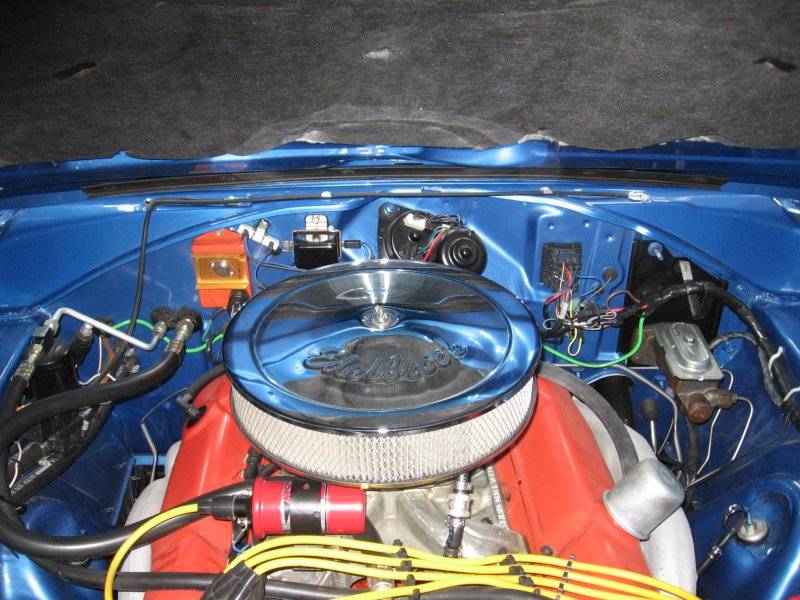

Also use the East wood exhaust and manifold treatment. Cured on the motor. Got the engine to running temp. Then let it cool did this several times. I did sand blast mine before doing the paint.
