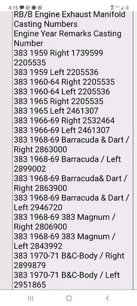

No idea why they would bother saying non ac for a hp manifold description . Same part number whether on a 383 or 440 when it came with dual exhaust. 2 barrel engines had log style manifolds. Manifolds have a date and a casting number. Year one has also been reproducing them, or at least selling them.
The casting numbers are 2806900 for the left side and 2843992 for the right side.
