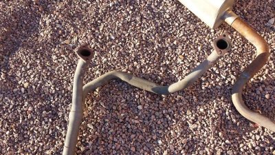

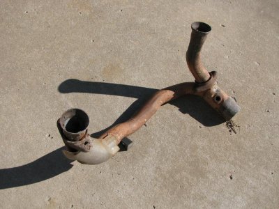

Here are a few pics of the factory exhaust. The straight pipe connecting the two collectors runs straight across the rear of the oil pan and in front of the bell housing.

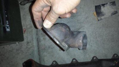

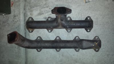

Here are the factory 318 Poly exhaust manifolds. The one on top is the pass. side, bottom is driver. The end view pic is the pass side and shows how it dumps straight down.
