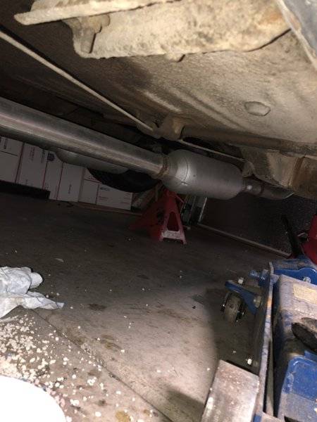

Thanks KK what mufflers are those and what did you weld prior to installation and what did you wrld during installation? Did you tig it?
Cheapest muffler you'll find, $30.00. They're holding up ok so far.
https://www.jegs.com/i/JEGS/555/30220/10002/-1
I just mocked it up while under the car. Made my measurements and cut where I needed. Then just tacked everything together, removed each section and welded it up on the table. All mig welded.
