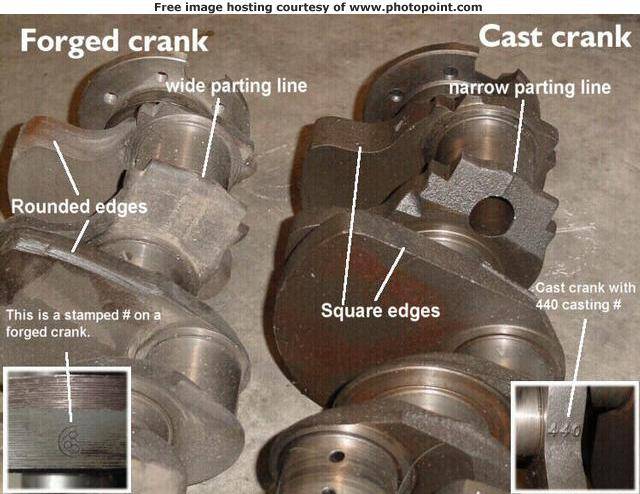

Pics of your balancer, flywheel, & converter "might" help determin if you have mix-matched parts, but it really depends on what crank is in your engine( & if it was ever balanced for replacement parts)...
The more info the better.
Do you have any build specs(or know for certain the crank is forged or cast)?
