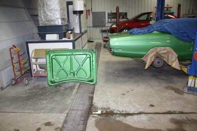

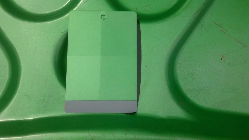

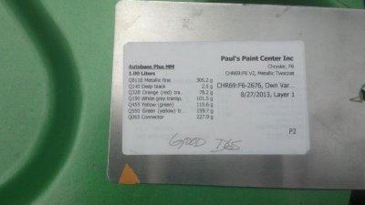

When I did my F6 Bee I color mapped the bottom of a Lynch Road deck lid to get the exact match. A picture is posted below showing the results along with the recipe for a base clear coat application.
I think the reason you see so many different hues of F6 is you can vary the appearance of it by varying the pressure of the application.

Thanks I like it as well. What do u mean by the pressure of the application????

The picture below is the recipe from above just at different pressures and with the clear applied to the top half. You can see the difference from left to right. I chose the right side.
I think they said it has something to do with the way the metailic lays down? That is all I know, my paint guy under stood it.

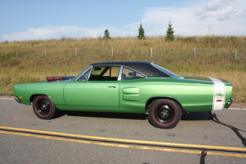

I have posted a picture of the car as well so you can see the color over an entire vehicle. You know, we want pictures as soon as you have your car painted!

F6 is "bright green metallic"
Spring green or rally green was a 999 code color which was used on camaros. It is a darker non mettalic color
F6 is a Dodge color.
Code 97 is the Plymouth Rallye green, which is GM formula that Plymouth used. GM had it first.
The Plymouth/Chevrolet color is a bit darker, and almost candy looking. It is metallic, although not as metallic as Dodges F6.
I owned a 69 1/2 A12 Road Runner, code 97 green for 26 years. It is an impressive color. Much more intense than the Dodge F6 color.
