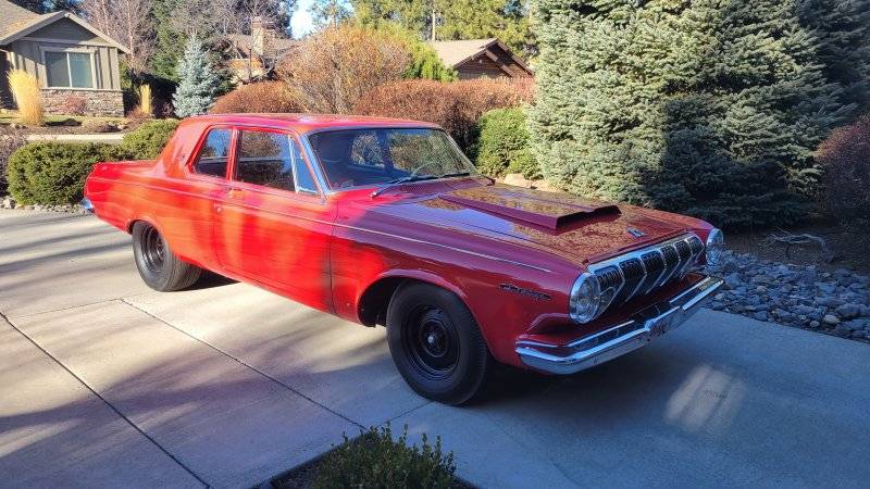

When I got my 63' 330, the prior owner gave me the numbers matching 383 with it. The car currently has a 69' 440 in it along with the original BW T-10 4 speed. The 440 was installed by the original owner back in the 80s
My question is, since this wasnt a Max Wedge car, does having the factory 383 add any value at all? I realize this question is subjective. I'm just trying to determine whether hauling it around and storing it is worth the trouble. I have no intention of ever putting the 383 back into the car. In-fact, I'm searching for a 63' AAQA block to build and make this a tribute car.
But from a desirability standpoint, does the 383 add anything?

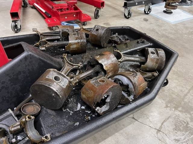

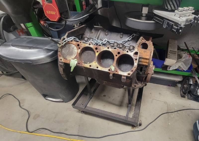

After months of consideration, I've decided I'm going to rebuild the original 383 for this car. The 440 that's in it currently is awesome, but I think it would be pretty neat to put the original engine back in it mated to the T10. I'm not 100% sure if I'll keep it stock stroke, but the first step was to get this thing disassembled after 40+ years of living under a work bench.

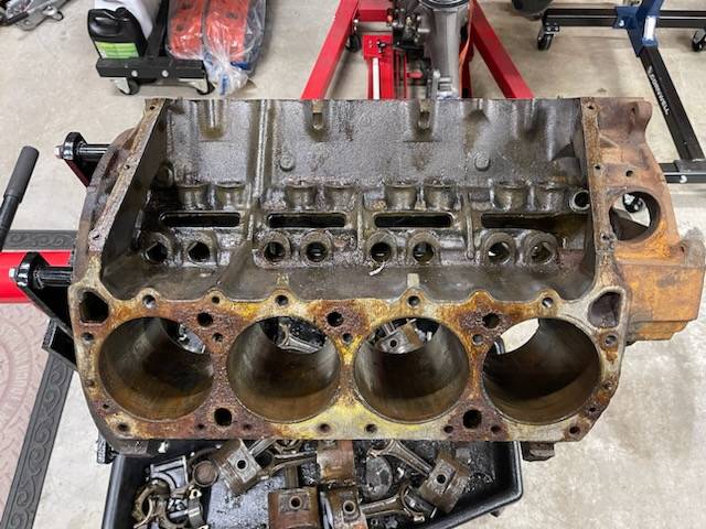

Sucker was rusted big time! I tried leaving penatrant on the pistons for over a week. Didn't move. I tried adding a bit of heat to it. Didn't move. Then I busted out the BFH. Didn't move.
Finally it was air chisel time. I was as gentle as I could be, but the pistons/rings were fused together. Eventually after punching a few holes in the crowns, it started to slowly come apart bore-by-bore. It took about 5hrs to remove 8 pistons.
Block is now off to the machine shop to be cleaned, magged, and sonic tested. Really looking forward to this journey.

I just took the original 383 out of my 64 Belvedere 2 dr and 4 speed. Three valves were missing and three cylinders had mouse nests in them. The 383 need a lot to rebuild, like sleeves in most cylinders. I am keeping the engine but I have a newer 383 to install for now. I my 383 would be a costly rebuild.

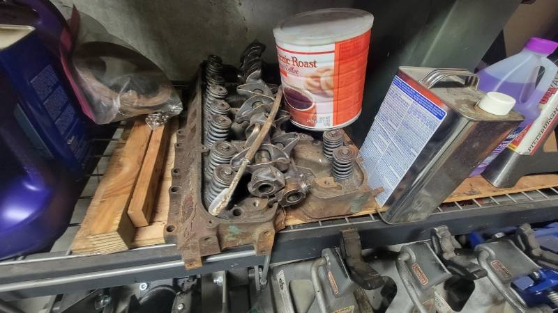

Man, I've toiled over this for months. I have a set of nicely ported 906 heads and Vic intake on my shelf that I've considered using. It's tempting. I just don't know...
The thought of having a high RPM screamer is very tempting. But so is making it a quality driver that I can comfortably take to shows. Very conflicted.
