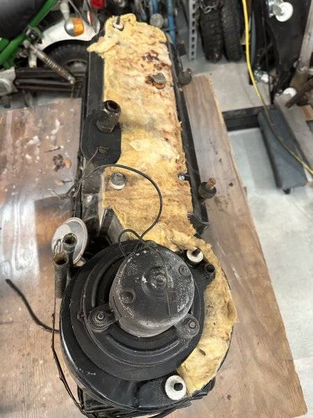

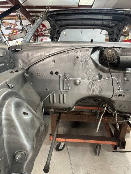

Here’s an update: Fire wall has been modified to accept the A/C / Heat assy. Wasn’t real easy but after making a template from an A/C car it was just a bit of work. After car comes off the rotisserie I’ll install the unit. I have the wiring harness to modify the existing harness and need to install the compressor relay. I do plan on installing the Saden unit.
