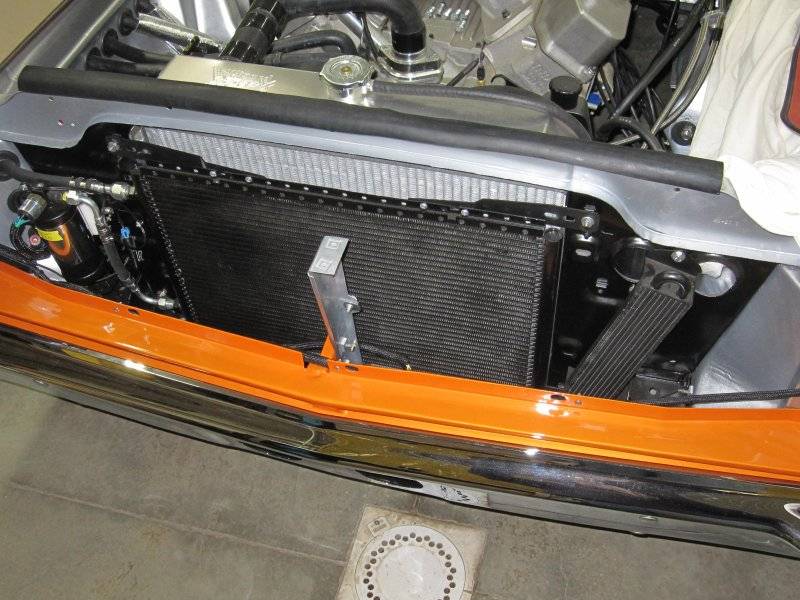

I installed that product but, have yet to charge the system. I will let the forum know next season.

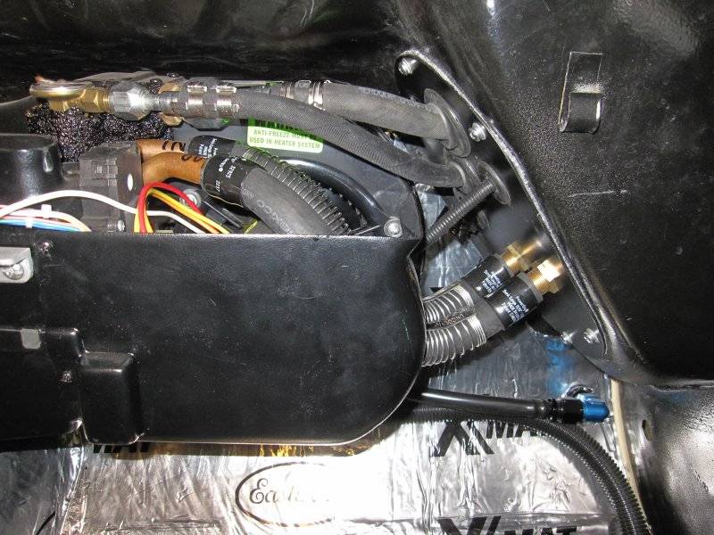

I've had the EZ Clip hoses on one of my hot rods for years. They rock. No leaks. Uglier than a fat, crimped rubber hose? I don't know about that. There are some things you can do to the hoses to make them better looking on a show car if you want.
BTW, the only A/C hose that ever leaked on my three cars with Vintage Air, was one of VA's factory crimped hoses.
