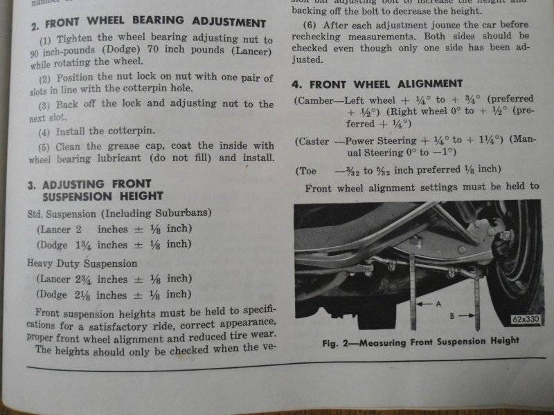

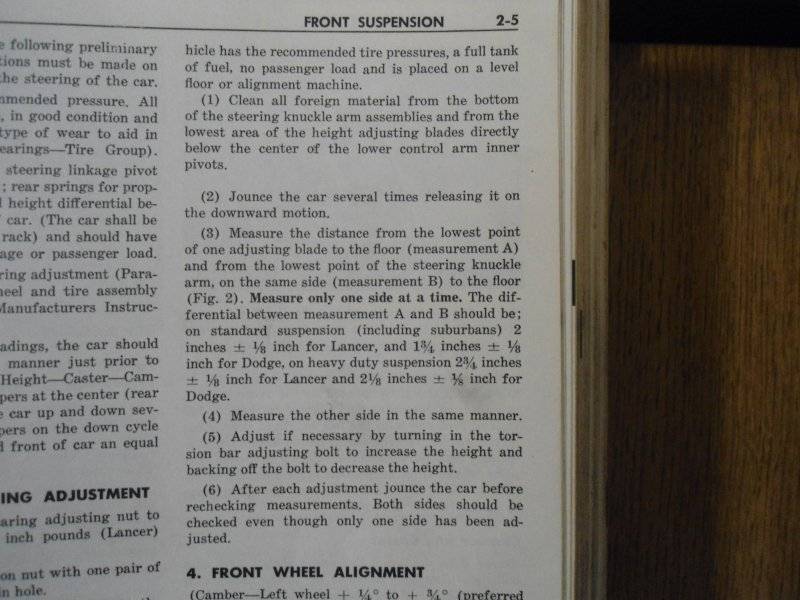

I have a factory 62 Dodge service manual & it probably has the measurements in there as well as where to take the measurements from. I can look & see if you want.
This is what the factory service manual says. It doesn't say anything about the rear. Hope you can read this OK.

i use the factory service manual for front suspension ride height. i don't there's a rear ride number. you'll have to decide if you want level or raised in the back.
Glad I could help out. If you need a factory service manual, I've been trying to sell mine for a few years now.
