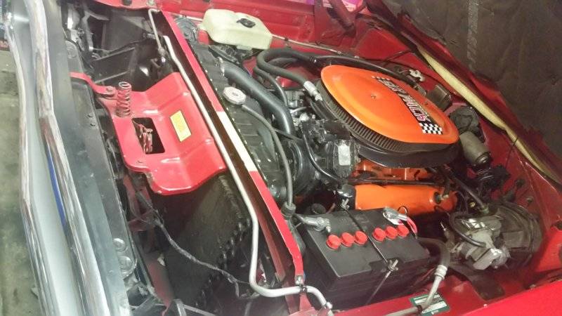

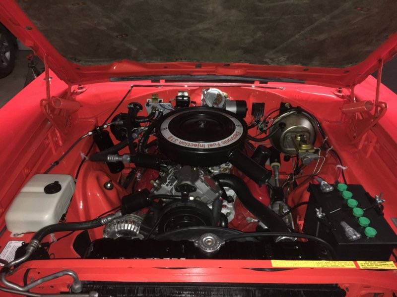

If someone were to use a fake topper, do NOT use the type of battery cables in that first picture! What is the point? Why try hard to fake one thing only to have a totally wrong set of battery cables next to it???
X2 ...The universal clamps are cheesy. I am not picky about chalk/paint marks but on a nice resto I really don't like some weird universal battery. At least spray it black to make it blend in. Someone spends 10K on a engine rebuild and then installs a cheesy Walmart battery, really? If the battery cover fits really nice and is pretty much undetectable then yes I would use one. Just my 2 cents worth.

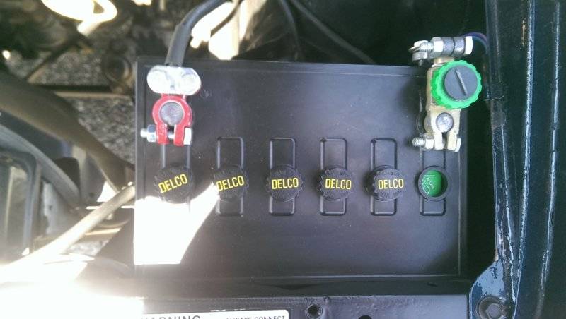

If they can't be gotten, I'd not feel bad about using an aftermarket appearance unit. I'm not really worried about what others think of my own car(s), I want better-than-stock performance. But for a car whose owner's goal is a perfect stock resto - using something like that would be a put off for me. Like using the fuzzy dash pad cover vs. the right part. If you look quick enough it looks "ok", but it's still trying to fool the eye.
