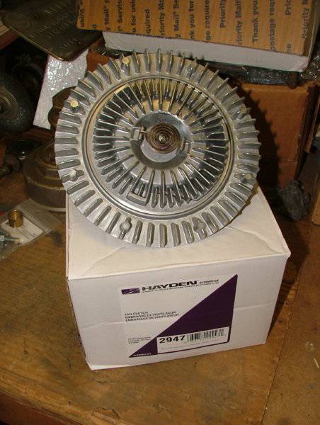

The centrifugal clutch rotates slower than the pulley. The thermal has a bi-metallic spring in front which adjusts the rotation based on temperature.
This is the thermostatic type
