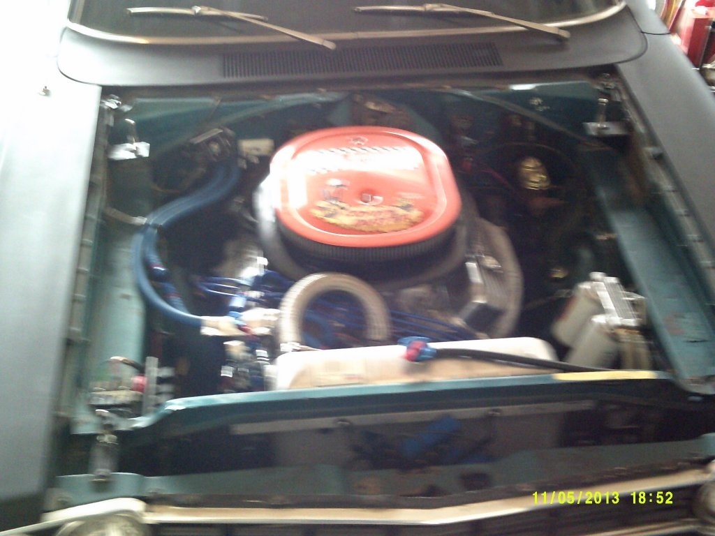

I have 2 Perma-cool alum. electric fans
& a Pro-Comp #66219 38gph elect. Water Pump,
no thermostat just a 5/8" re-stricter S/S washer instead,
in a MP chrome Them. housing & MP alum w/p hosing
fans are on a Alum 4 core down flow Mancini 22"
1) #19115 16" 2950cfm 1750rpm/9.8-amp draw
in a shroud as a puller 1/2 off the rad surface
{offset down slightly & to the drivers side to help clear water pump,
extremely tight quarters}
sorry photos kind of suck :lol:
Perma-Cool Electric fan 13 in. alum. in 3000cfm prm-19113 $153.05 Summit.jpg
1) #19113 13" 2,650cfm aux. 2500rpm/8-amp draw
pusher with "no" shroud
{slight offset upwards to the pass side/opposite from the puller inside}
in front of the rad. spaced out about an 1", held on with 2) 1/2"x 1/8"
flat alum. stock, from side to side over the core support,
added the 13" pusher just in case it gets hot, but really never has,
even in 100*f+ summer temps...
& an electric water pump
all my electronics, pumps fans etc. are ran thru relays &
an override/arming switch system
I went to a Powermaster dual field 75amp alt.
to help handle the extra amperage draw
all on my car/68 RR 479ci-6bbl "Thermal Nuclear reactor"

Busy engine looks like that in the photo it's not that bad really
With a org. style rad./thermostat/pump/fan/pulleys etc.
{if it had a 26" rad & core support maybe it'd worked, but it doesn't}
