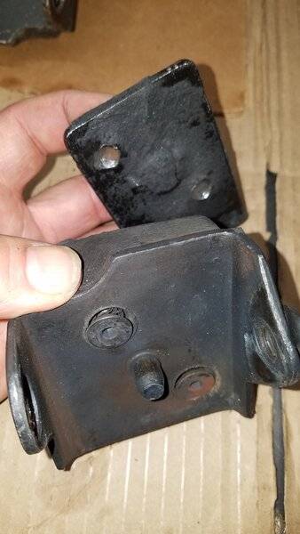

I personally have zero confidence in Mity-Mounts, especially for what they charge....
Mine failed on a 440 with less than 500HP, after just shy of a year of street use.
You already have them, so that's fine, but I would definitely make sure they aren't the sole means of retention. Any reinforcing you can do is a plus.
