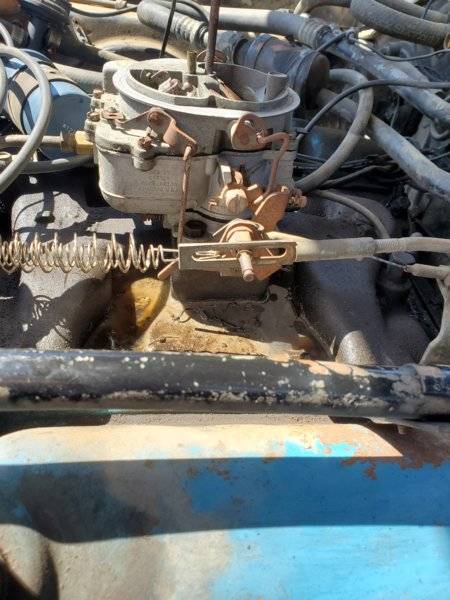

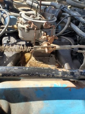

I do have a follow up question as I cant find a very good picture online: is the original kickdown supposed to have some kind of spring retention to the throttle linkage? Mine sits about 1/2 way in the adjuster linkage at idle. Always been this way as far as I can remember. I can physically pull the linkage forward with no effort and pushing it back I feel immediate spring pressure..
Picture attached for clarification. Ignore the water spilled on the intake.
yes there should be a spring connected from the kd arm to the throttle arm keeping it pulled forward. not a heavy spring , just enough to keep it snug

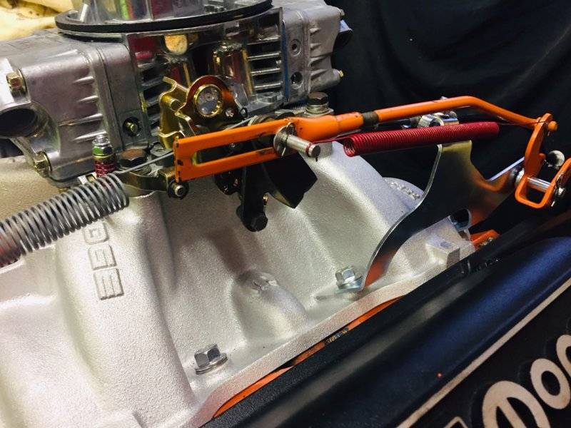

See my linkage, this is on my '69 440, yours will be similar though.
The red spring keeps the throttle pressure linkage pulled forward.
If you have a service manual check the procedure to set it up properly.
Once set, check that the carb throttle can reach WOT position and it is not restricted in stroke by the throttle pressure linkage.
If that is ok, also check that when the carb is at WOT position, the throttle pressure linkage is almost fully bottomed out.
If you can still push the throttle pressure linkage further before it hits the end of stroke with say 1/4" or more, you need to re-adjust the linkage to make sure that it provides maximum pressure at WOT.
My transmission was lazy as **** because i still had another 5/16" to go on the linkage when the carb was at WOT.
This delays the shift points over all stroke and causes the tranny to shift like a grandma.
I'll check around at work to see if I have a spring tucked away in my toolbox somewhere that will fit it, or maybe check napa tomorrow in their misc hardware section. It's always shifted like a granny since I've had the car about 10 years now but then again I dont drive it hard. Shifts at 20 and 30 most of the time, although a ton smoother since I adjusted the bands. I'll stick a light spring on it and recheck my adjustment tomorrow afternoon. Thank you for the picture as well.
