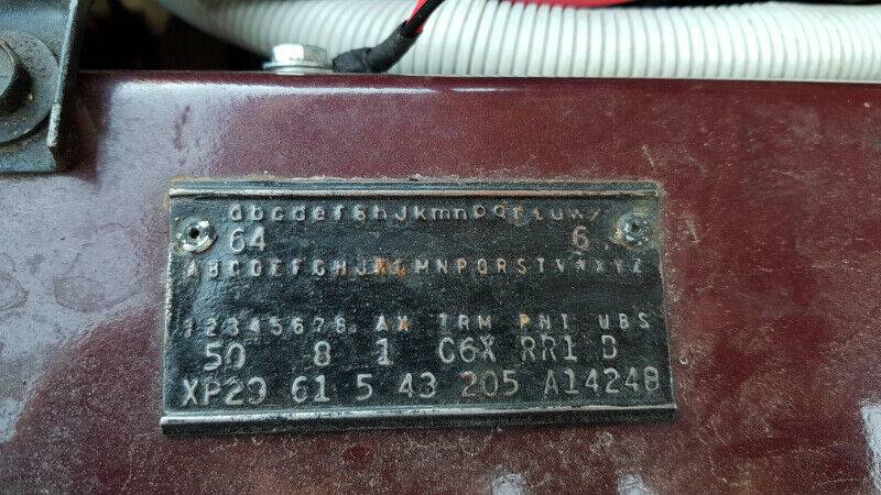

any help appreciated .. thanks
383 2bbl, automatic, burgundy metallic, bucket seats, console, Feb. 5 build date. Open rear end not sure on the ratio. That's all I can do from memory. I will have to look up other information.
I also see black upper door panels. No strip, 22 " radiator.
C6X black interior
7.75 14 WSW tires
There is no radio code so I say radio delete.
" from memory" ....I like that, I can't remember where I put my keys.. thanks, trying to by it..
Radios are not standard therefore cannot be deleted. Radios were optional. This car was simply built without a radio.
Keys are a different matter altogether. If I don't put them in the same place every night I won't find them in the morning. I've lost my trailer keys to many times to mention and have even lost my car keys at a show.
Best of luck on the purchase, hope it works out.

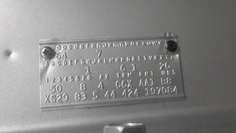

No the stripe is the S in UBS
U= upper door color
B = Buffed Paint only applicable to Silver
S = Stripe
so my car is silver upper door is black and it is a stripe delete.
View attachment 804896 so my car is silver upper door is black and it is a stripe delete.View attachment 804896
Exactly... Nice Charger!!
X=Charger
S= Special=R/T
29=Sport Roof
83=440
5=727
44=F70-14 redline tires
April 24th 1968=Scheduled Production Date
197084=Shipping Order Number
2 with a 5 below it=Drip Rail Moldings
3 with a 0 below it=Belt Line Moldings
7 with an 8 below it=Wheel Lip Moldings
A with an 8 below it=3.23 open axle
T with a C below it=Charger
R with a 6 below it=Bucket Seats Vinyl Premium Grade
M with a X below it=Black
And So On...

There is no stripe coded on a '68 XP29 tag.
So the original post is correct...no stripe coded. Not stripe delete.
68 XS29 Charger stripe codes are a little different.
Sometimes the standard black stripe was not coded on the tag. The absence of an S code probably means the car got a standard black stripe, which would be appropriate for an AA1 car.
S/9 on the tag signifies code 319 transverse stripe delete.
