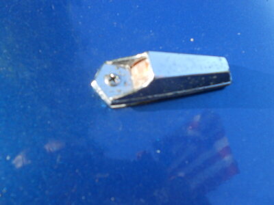

I have a 67 Coronet with the fender turn indicators. Pass. side doesn't work. I pulled the chrome housing, but I can't figure out how the pigtail come out of the lens to replace the bulb. I'm afraid to twist and pry too hard for fear of breaking the lens. Need someone to drop some knowledge on me. TYIA.

Close, but no. These have a flange with a screw that holds it to the fender. Also, there is no knurled cylinder on the pigtail wire,

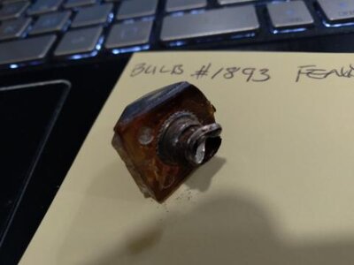

Okay, I was able to get the lens and bulb removed from the pigtail. It looks like the bulb is captured within the lens. The lens and bulb unscrew from the pigtail as a unit. The service manual (provided by 69Bee) shows the replacement bulb as #1893, but #1893 bulbs are standard type bulbs. The bulb looks to have serrated teeth and the lens is molded to the teeth on the bulb. I ruined the small, soft, brass, socket of the bulb trying to remove it from the lens.

The bulb metal base is rusted to housing. As mentioned Krusin Moons has bulbs, you maybe be able lens with threaded that holds the bulb. They sell housings $40 a pair and $5 for two bulbs. +S&H Maybe pigtails?

Thanks, 69Bee, but I don't need the whole assembly and $250 for one is too steep for this cheap. Scottish Bastard. For that kind of money, I'll stick the regular #1893 bulb in the pigtail and drill out the old bulb from the lens I have. Also, don't need the pigtail. The wire and socket are fine and not rusty. My issue is removing the bulb from the lens.
