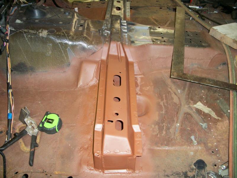

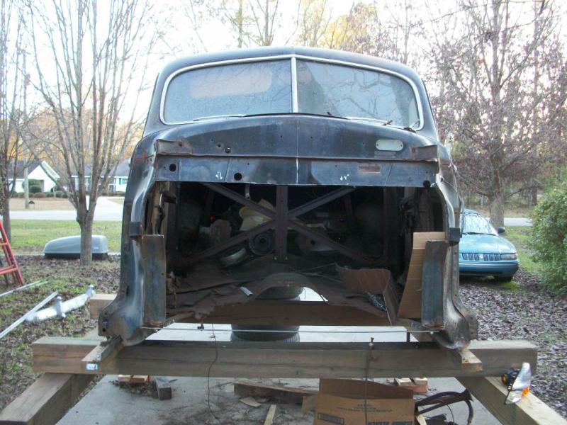

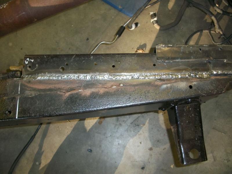

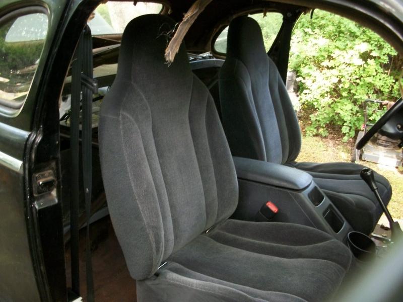

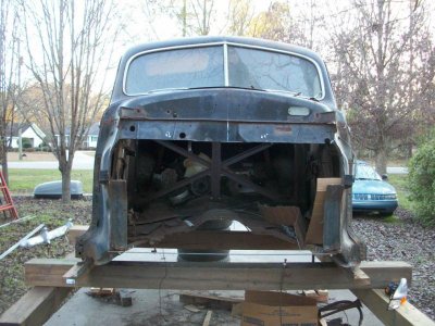

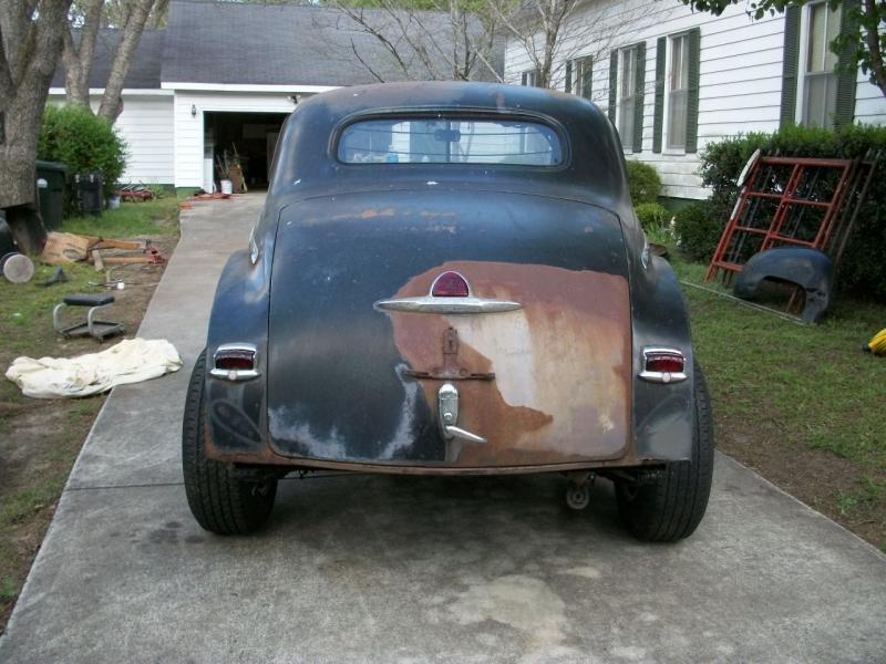

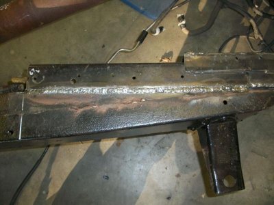

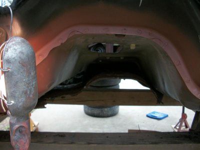

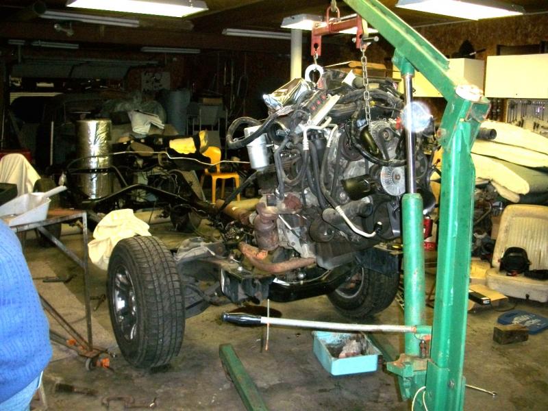

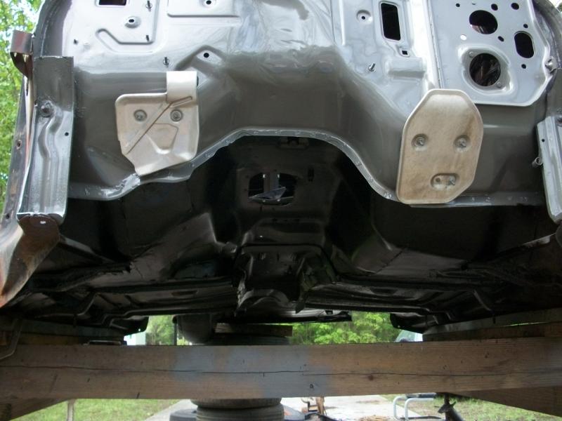

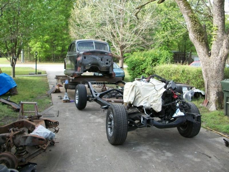

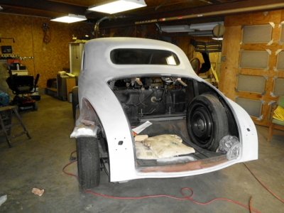

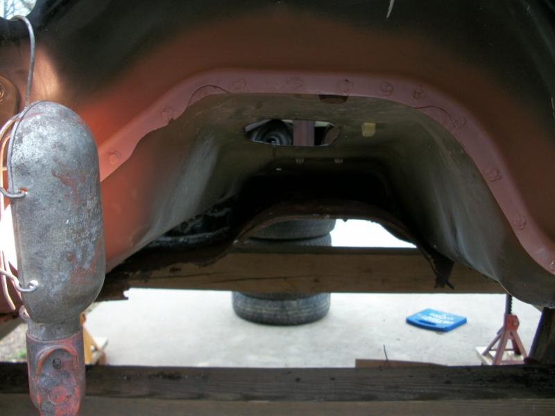

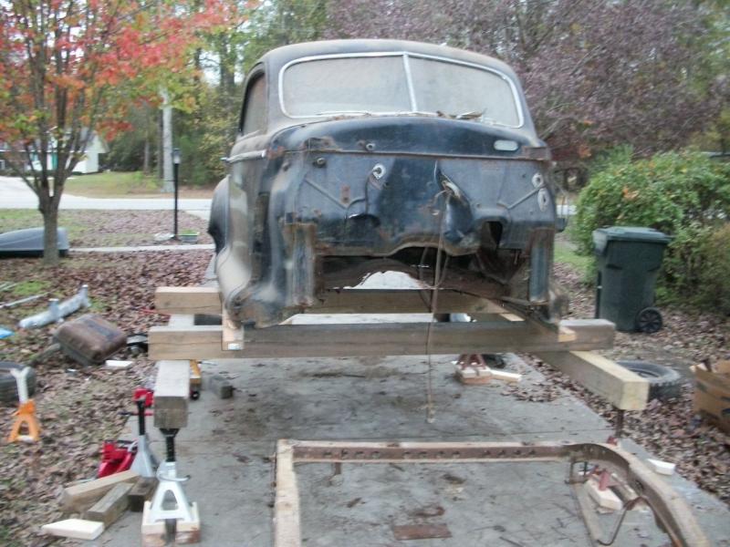

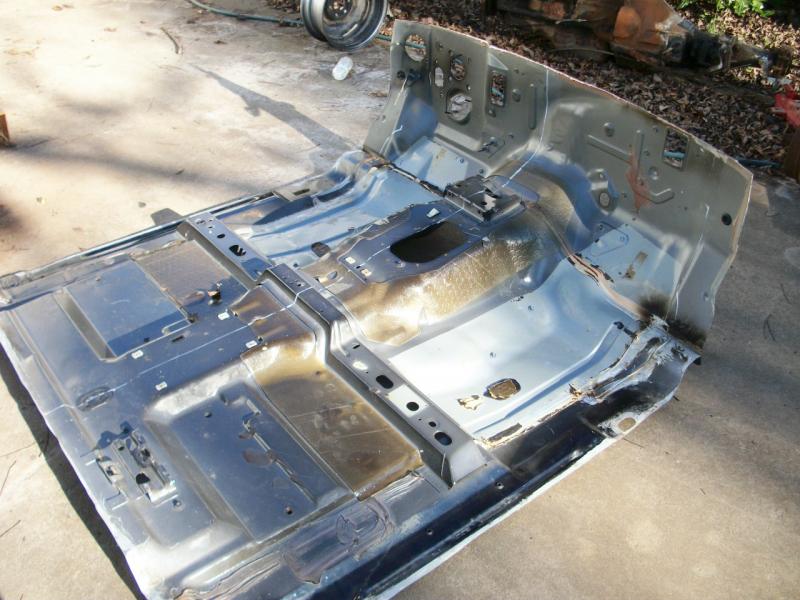

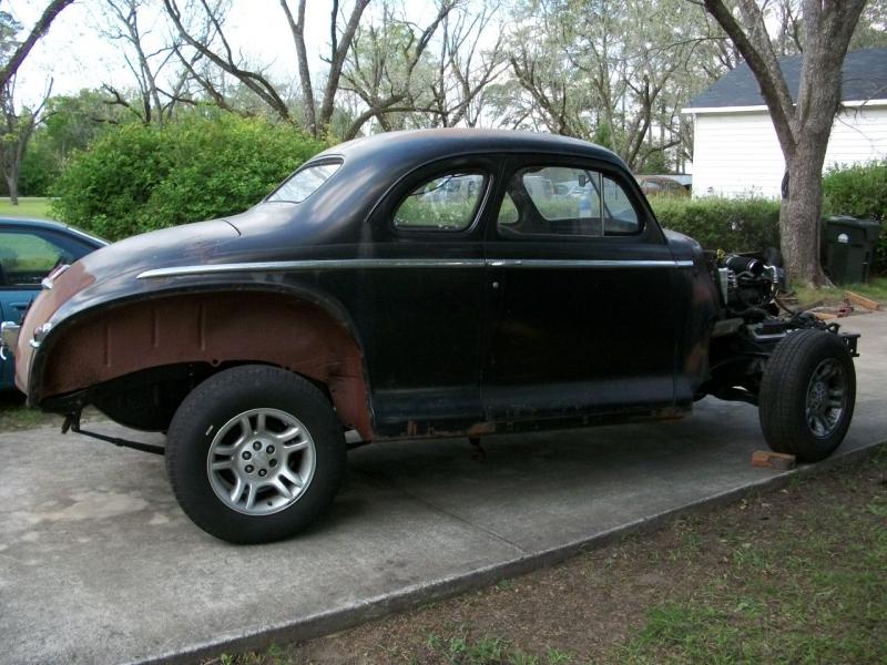

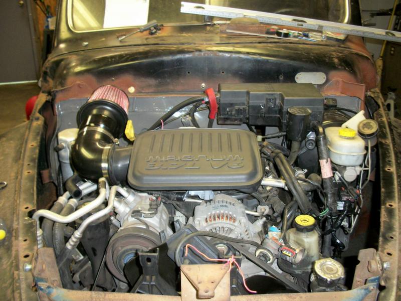

With apologies to the B-body forum I post this by request..Thanks for your forgiveness..the photo documentation and daily log of activity for time spent on the '48 project is quite a lot of blurbage and many many photos..this however does leave a paper trail and creates it's own build sheet and wiring diagrams changes made along the way. This vehicle is sitting quietly in the spray booth, I say quietly, I swear I hear it growl at me as I walk by. The process to get where I am at required removal of the body from the frame...frame cut and spliced with the front clip of the donor. Engine moved back 7 inches from original cradle mount. Installation of the firewall from the donor and the floor pan and trimmed/fabricated to lay flush and full perimeter weld to the original floor and all cross braces modified to accommodate this change and retain body integrity. I used all the donor parts excluding radiator (Griffin) and the wiper motor, did not like the vacuum model so do my own modification there. Its been fun and I am anxious to get this going as it will be my daily driver. Couple pics...remember..work in progress...the pic loader has these out of order..sorry..
100_1380.jpgSANY0265.JPG100_1700.jpg100_1664.jpg100_1628.jpg100_1560.jpg100_1559.jpg100_1552.jpg100_1546.jpg100_1492.jpg100_1469.jpg100_1467.jpg100_1430.jpg100_1425.jpgSANY0398.JPG

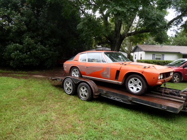

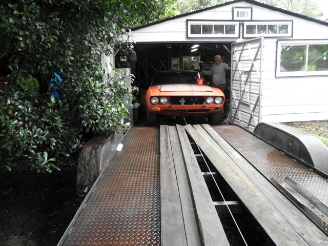

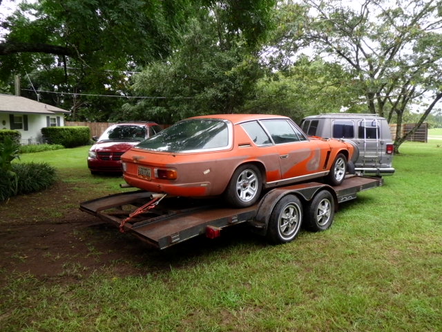

Reluctant to show as the beast if not ready for prime time...but a couple members have asked for a shot of the car....remember been sitting 20+ years....couple shots as I snag it from its lair to go home with me...the parts are in the trunk..good intentions by the PO to strip for paint..and as you can see..that is about as far as it got...
Not to hi-jack someone else's thread, I'm just curious... cool old Jensen Interceptor... is it 440ci 7.2ltr powered {they didn't make a 400ci 6.6ltr did they ??} what year ??
sorry I just saw in an earlier post, it's a 440ci III Series 4...
Didn't they also offer a 383ci 6.3ltr in an earlier year ?? I seem to remember them... I could be wrong...
I also apologize for the hi-jacking..I made a response to the origninal thread and hav e since tried to repond to a couple questions of interest, but yes Budnicks, you recall correct, the 383 was the engine of choice but as Chrysler started the phasing out of these ..late 71 Jensen made the move to the 440..there were also 232 of these in six pack versions...all with AC...
wow never heard about the 6bbl versions, I learn something new here everyday, thanks for the information... back to our regular scheduled programing now...
cut to commercial...........also 15 years prior to the Audi Quattro the Jensen Interceptor FF (4WD) was also equipped with antilock brakes...there were 320 of them made...
