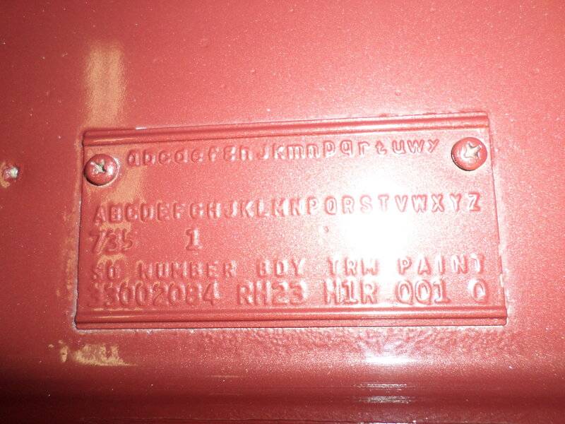

Here is my new to me GTX and fender tag.
Any help with this is appreciated
Thanks
Not sure I'm 100% accurate but those decoders are a little odd to use.
CAR: Plymouth GTX 2 Door Hardtop
ENGINE: 440cid 4-bbl HP V8
TRANSMISSION: 4-Speed Manual Floor Shift
TIRES: 7.75 x 14 WSW
MODEL YEAR: 1967
BUILD DATE: May 17.
AXLE: 3.54/3.55 Rear Axle Ratio (Dana60 or 8 3/4), Sure Grip
INTERIOR: Premium Trim Grade, Vinyl Bucket Seats. Black Interior.
PAINT: Ruby Metallic (Imperial).
OTHER: Black (Dodge, Plymouth), Formal Black (Chrysler, Imperial) Upper Door Frame Color.
MOLDINGS:
15: Unknown Option
ABC OPTIONS:
A1: 26in Radiator
F5: Special Body Style, GTX only
R1: AM Radio
Y6: Black Vinyl Top
abc OPTIONS:
a5: Center Front Seat
j4: Moulding - Body Sill Narrow
3.54 Dana.

Crap I typed in 771 ... I mistook them for 7's. Fixed... Oddly enough ZZ1 still came up as gold. Axle code originally came up as unknown. Using the 3 which would be I think a 8.75 but, since this is a GTX it should have a Dana 60 with a Suregrip. The ratio would be optional I guess.

thanks for the help, that appears to be what i have, what is the code for black stripes?
Sure grip
Nice car! A buddy of mine has almost the exact same car but it is 881 (metallic blue) instead with a white interior.
The 4 speeds (which got the Dana) seem to be pretty uncommon compared to the automatics. I don't have any official numbers in front of me, but it seems a majority of 67 GTXs were made with automatics.
3.55 would be an optional gear for a 8 3/4, but since this 4-speed car would have a Dana, the 3.54 would be standard.

the ones I know
AB73 = Hemi
C5 = auto
G1 = 26" radiator
330 is SBD - March 30th
02084 is the SO number. should be stamped in rad support and behind the rear bumper
H1R is red interior, with it being a Belvedere it should be bench seat , dont know if cloth and vinyl or all vinyl
QQ1 is a metallic red exterior
Q is red upper door frame paint
Thats a pretty stripped down basic car
