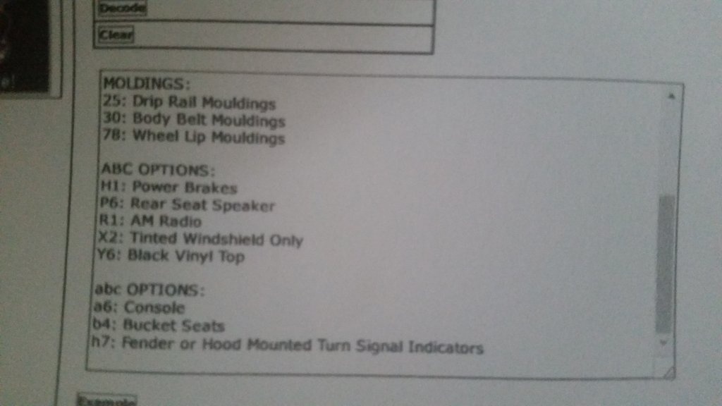

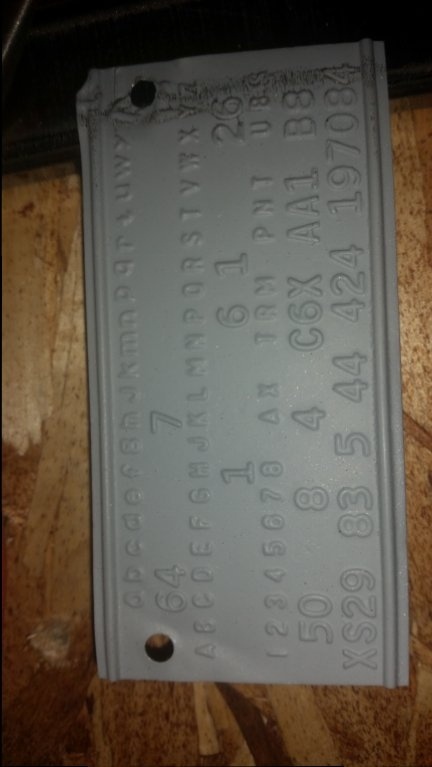

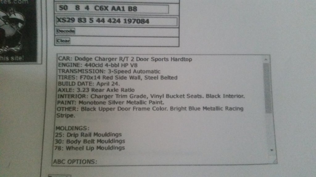

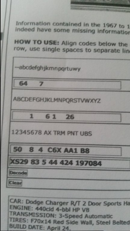

decoded my fender tag (no build sheet) at mymopar fender tag decoder. came up with an option on my silver 68 charger under the UBS letters B8 8 meaning bright blue metallic racing stripe. never saw one on any charger mine being silver, might look cool. haven't found any sticker decals in that color, So i guess what I'm asking is that i did this right? was gonna have stripes painted on in a few weeks. looking to stay mostly origin
Regarding "UBS" - The "U" is for the upper interior door paint color - the "B" is for "buffed paint" (only Silver Metallic cars would have a code for this which makes sense because your car is AA1 Silver Metallic) and the "S" is for the stripe or accent color. Looks like you have no letter code underneath the "S"
Coding varies by year and plant. The standard black stripe is not coded on a 68 Charger R/T. There is no code under the S so this car needs a black stripe. It would match the interior.
