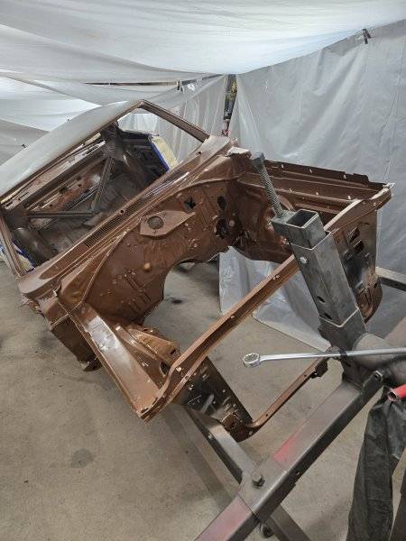

My RR is missing the tag. Even if I located the BS I would not re-pop the tag. But now if I found the fender tag I would party like 1999 :fool:
Does anyone know when during the manufacturing process the partial VIN were stamped onto the body parts?
1) detail part?
2) subassembly part?
3) major subassembly part?
4) complete shell just before installing the drivetrain?
After the previous 12 cars went by with the partial VIN being stamped and the line worker sobered up from his 40 ounce Old English lunch. Grew up in Detroit seen it everyday.

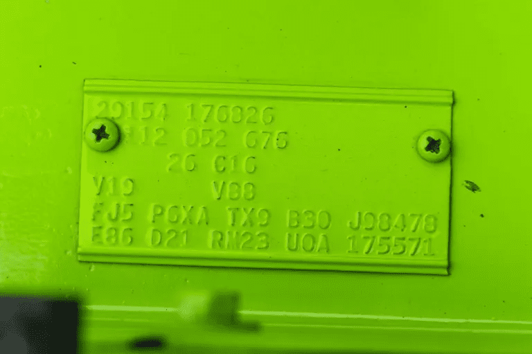

Did anybody see the 'bird on BAT recently? tag showed both a hemi and a 440!
  • 29 – Lynch Road Assembly Plant gate-sequence number
  • 154 – Lynch Road Assembly Plant base-sequence number
  • 176826 – Lynch Road Assembly Plant line-sequence number
  • 112 – 426ci V8 with two four-barrel carburetors, manual transmission, and heater
  • 052 – 8.75″ Sure Grip rear axle with 3.55:1 final drive and 10″ rear drum brakes
  • 676 – A833 four-speed manual transmission for 426ci and 440ci V8 engines
  • 26 – 26″ radiator
  • C16 – Center console with woodgrain trim
  • V19 – Special-order black vinyl roof
  • V88 – Transverse-stripe delete, add Road Runner nameplates
  • FJ5 – Limelight Green paint
  • P6XA – Premium trim, vinyl front bucket seats, charcoal and black interior
  • TX9 – Black-painted upper door frames
  • B30 – November 30, 1969, scheduled production date
  • J98478 – Vehicle order number
  • E86 – 440ci Super Commando V8 with four-barrel carburetor
  • D21 – Four-speed manual transmission
  • RM23 – Plymouth Road Runner two-door hardtop
  • U0A – 375-horsepower 440ci V8 with four-barrel carburetor; 1970 model year; Lynch Road Assembly Plant
  • 175571 – Serial number

The only thing that I see that talks about a Hemi is the 4-speed transmission, which would be the same between the two engines.
I'll be the first to admit, I know zelch about tag #'s, but this seems strange to me?
From the "Aero Warriors"
112 083 676 row 2
112 426 8-bbl, Four Speed 113 426 8-bbl, Automatic
114 440 4-bbl, Four Speed 115 440 4-bbl, Automatic
122 440 6-bbl, Four Speed 123 440 6-bbl, Automatic
E74 D21 row 6
E74
426 8-bbl
E86 440 4-bbl
E87 440 6-bbl
The tag in question should have 114 instead of 112
