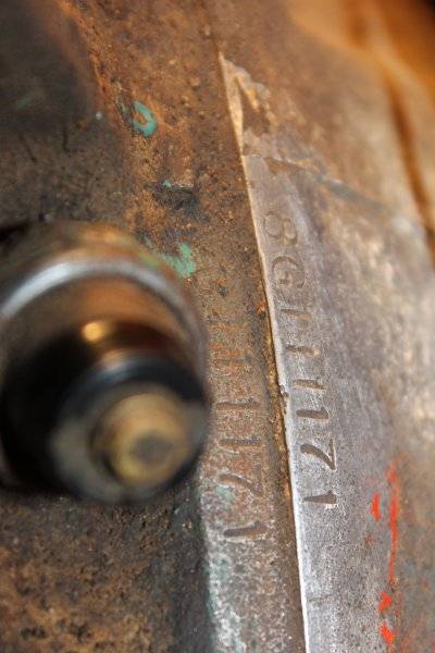

On my 1968 Coronet R/T
Under the truck seal on the left side.

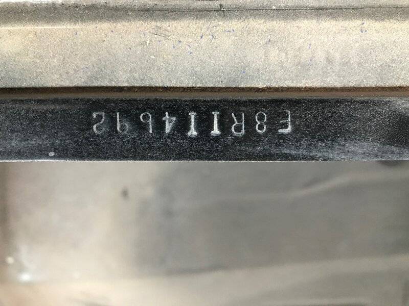

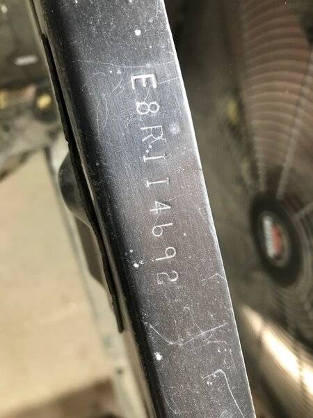

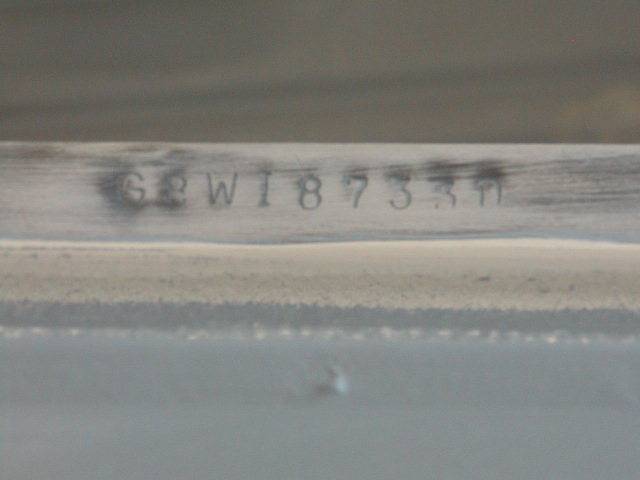

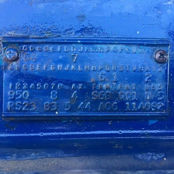

Numbers from my '68 GTX
You'll notice the last six numbers match the Fender Tag.
Trunk lip:
Radiator Support:
Fender Tag:
Trunk lip:
Radiator Support:
Fender Tag:

So it looks like from your pics....the St. Louis plant stamped the numbers on the engine side of the support and LA stamped them on the top of the support.

MY LATEST HANG UP IS THE "MISSING FENDER TAG". DUE TO CIRCUMSTANCES BEYOND MY CONTROL, THE BUILD SHEET AND FENDER TAG ARE LONG GONE. I'VE RECREATED THE TAG, ALL BUT THE LAST 6 DIGITS. THEY ARE OF COURSE THE SEQUENTIAL BUILD NUMBERS. I KNOW THE DATES OF THE MOTOR AND EVERYTHING ELSE, WHEN IT WAS ORIGINALLY PURSCHASED AND WHERE, BUT RATHER THAN FORGING A NUMBER...HOW DO I FIGURE THEM OUT??
The body number/s/o number will be stamped on the radiator support and trunk lip on the 68 also on the fender tag and noted on the broadcast sheet also. (no vin of course til 69 on the body stamps and fender tag). If it is a road runner with an HP motor, the vin should be stamped on the engine block right behind the oil sending unit 8B165722 etc. with the tranny stamped butted up to it exactly the same. If it is an early build 68 then the motor may not be stamped and you can then only go by the build date for the engine which you do not have since there is no fender tag etc. If you get a repop fender tag without already having a rusted one to go by, then most people know it is a re-stamp and in my opinion it causes more harm than good because then people start questioning the integrity of the whole car. I would just search to see if someone may have your broadcast sheet or fender tag and they show up all the time and maybe you will get lucky.
