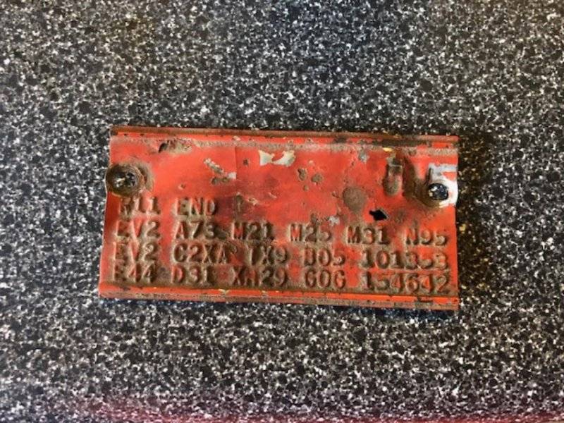

On 1970 and later fender tags that I have seen, it looks like they always list the engine, trans and the VIN on the bottom line.
The next line up seems to be exterior color, seats, interior color, build date and a 6 digit number that I suspect is the VON (Vehicle Order Number) ?
The next lines are where I get confused. Looking at build sheets, I see that not all the options that a car has appears on the fender tag. The example above is from a 1970 Charger. It is a base XH model that looked to be very basic.
My red car has no fender tag but I am having one made by a guy that makes 3D printed versions. His have a deliberately different appearance to avoid the impression of fraud. I want to have one made to reflect the equipment that my car has, many of the codes are made up to suit my needs....E95 to denote the 495 engine, D25 for the 5 speed manual, etc.
I'm trying to determine which option codes are expected to be on the tag and which ones they didn't list.
This car is clearly not a clone, a tribute or any recreation of a factory package. This fender tag idea is just for my own fun.
Next Gen Designs
I have a few of the Galen Govier white books and even in them, he states that not all equipment is listed, even on high optioned cars. He didn't elaborate on what was expected to be there and what was not aside from the bottom 3 lines.
From what I understand, the “body tag” as it should be referred to as, will list options that need an alteration to the body, such as a radio. A radio needs an antenna, the antenna needs a hole in the fender, it’s on the body tag. Same with paint, it doesn’t need a hole, but it needs to be on the tag because it’s an option that alters the body. Console?? Needs brackets. Light package? Needs holes all over the place. That’s the way I understand it.

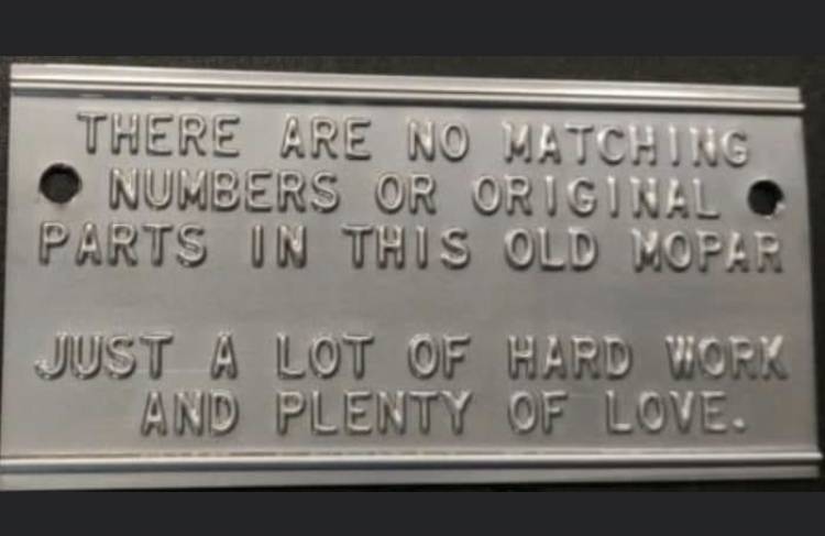

Unfortunately my car didn’t have its tag, which is bummer, because I think it has s6n interior, which according to Mark Worman is rare
I want to make one like this for my car. Or one that says “nosey bastard”
I appreciate the off topic commentary, I really do.
Could the answer to the original question be as simple as Cosgig stated in post # 3 ?
I believe power steering was not stamped on fender tags even though there is a code for it. I could be wrong but my 69 has PS and looks to be original and it ain’t on the tag.

That's what I understood, too. Of course, it also depends on what plant built the car. Lynch road is notoriously cheap with options info, but has drivetrain info that doesn't appear on LA or St Louis tags.
You're printing the tag for fun. Put whatever you want on it!
IIRC H52 is a real code for a D body that has rear AC.
