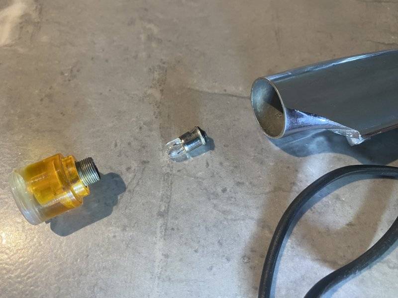

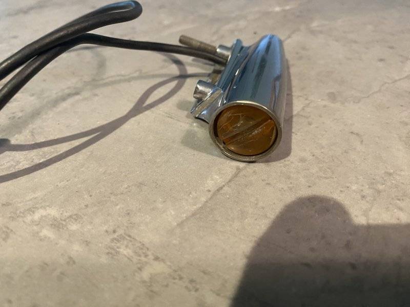

I got a 69 satellite with fender turn signals. The bulbs have blown and i can figure out a way to to them to change it. I was wondering if any one can help me

They have 2 nuts on each and the factory undercoating covers these.

None of the 67-69 bullet fender mounted turn signal indicators had bulbs that unscrewed. Some of the lenses looked as if they did, but you would only break the lenses. They have to be removed from the fender as @R413 said. Then there is a small allen screw that needs to be removed to start getting to the bulb. Not a easy task on 50 plus year old parts, but they do come apart and.
I remember taking them out at junkyards. The lense has a rubber O ring and held the bulb in. Idk… my daily has them and one is out so, I guess I’ll find out.
