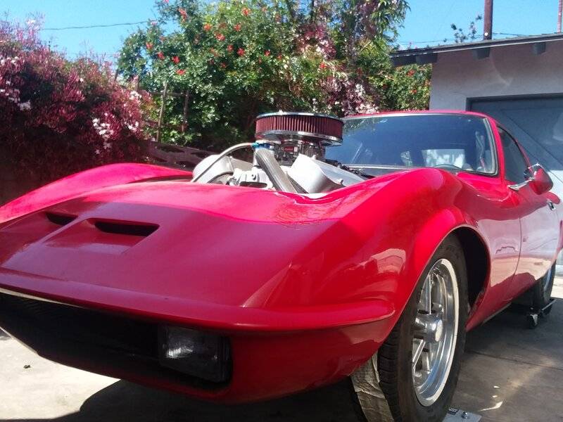

Ahh a unibody car.. Hey lets cut out the integrity of the front end and stuff some goofy headers in there.. The picture you posted shows what butcher job they did installing those headers. Unless you are building a drag car I'd stay away from them. But to each his own.
Replace windows much? I heard that if you V8 an Opel that the torque twists the body and pops out windshields.
Haven't had that problem. It's a fourlink chassis car, with a straight front axle. Coilovers, front and rear, and a cage tied to the tube chassis.
Ex mid-eight M/prod car, now on the street, with a BIG radiator.

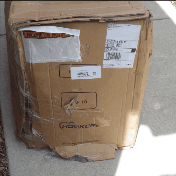

Last fall Holley had these FWs (and the black equivalents) as low as $360 on clearance. Mine are aged so I couldn't pass 'em up.
They didn't tell ya' this on the website.............
Here's how UPS left them at the door.............
The gaskets were damaged, surprisingly the headers look fine. Holley sent another gasket set, NC.

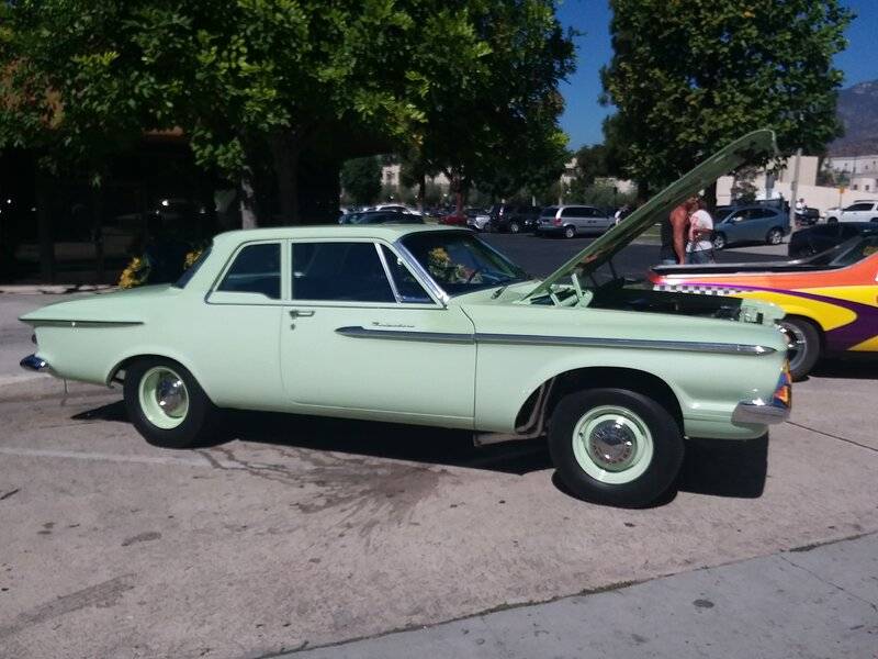

Lol, probably not on FBBO as my car is a Abody. Surprised to see a Bbody owner actually interested in them.
Could easily have been on the a-body side, lol. I have a 67 barracuda, and am over there often too. (I just avoid n&p there, get enough of that here, lol)

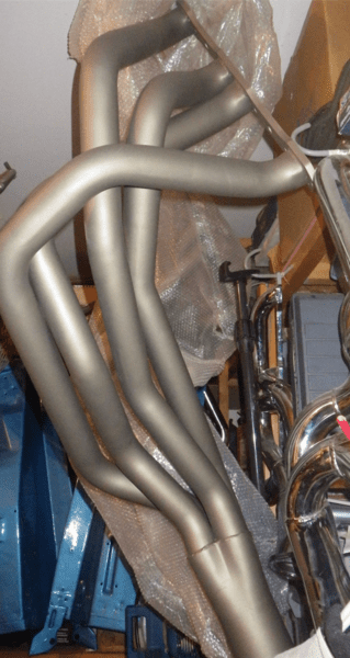

I have a brand new set of Hooker fender well headers up in the attic for a big block. I'm in central Kentucky. no shipping. if interested call 1 859 229 3517
