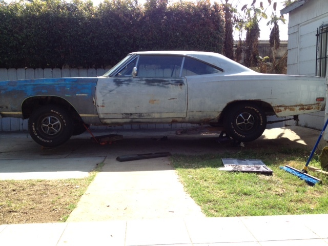

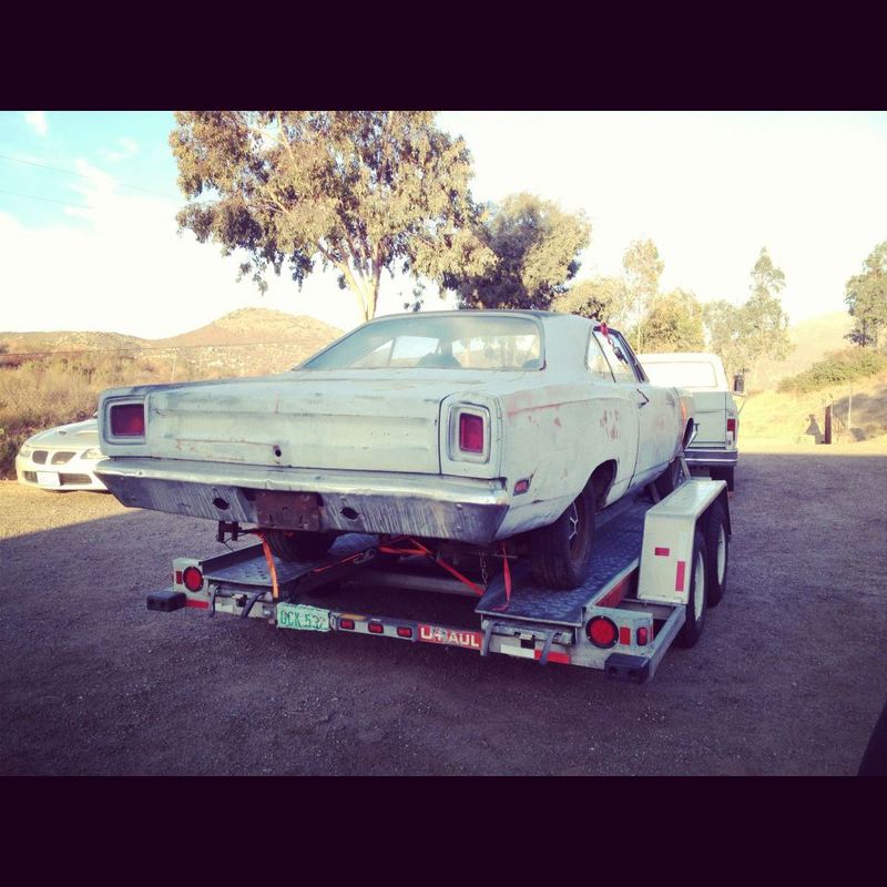

So on to mine. I just bought this girl about two weeks ago. Apparently she was saved from the crusher and/or turning into a parts car two or more times before I scooped her up and saved her. Originally a 383/4 Speed car. I plan on going with the same color as my dads (Sunfire Yellow) Because I have dreamed of having his car forever(Minus the post.. I like the Hardtop with the roll down windows) I dig the old school look so I'm going for keeping the car mostly original looking other then having some decent audio, disc brakes, and some other small stuff. So I will most likely go with rally wheels, redline tires, and some caps. Young guys like me who like the old stuff are a dying breed. Guess that's what happens when you grow up around cars/motorcycles. Gives you a bigger appreciation for the good stuff.

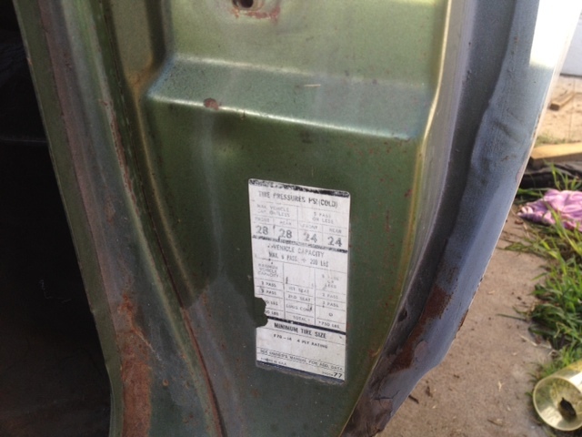

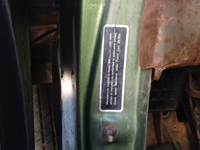

The car has a 3.91 8 3/4 with the sure grip Unit. I was told that the car is believed to be an A31 Option car but cant verify that due to the lack of a fender tag or a build sheet(Which I looked all over for)

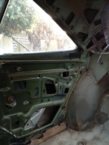

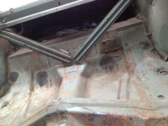

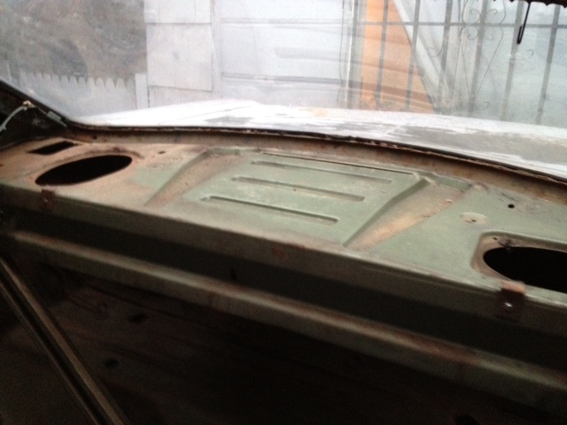

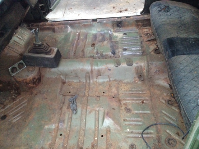

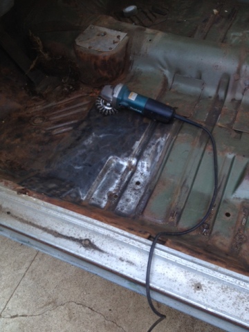

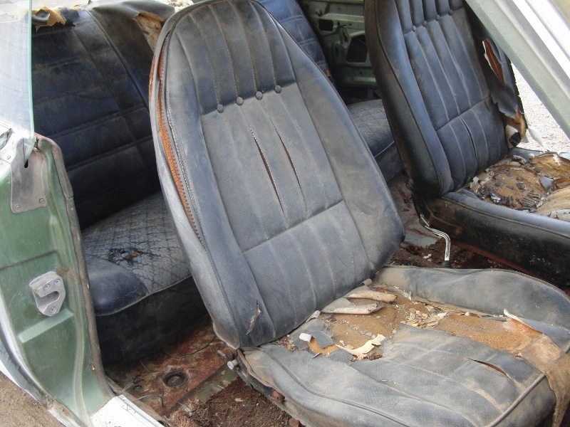

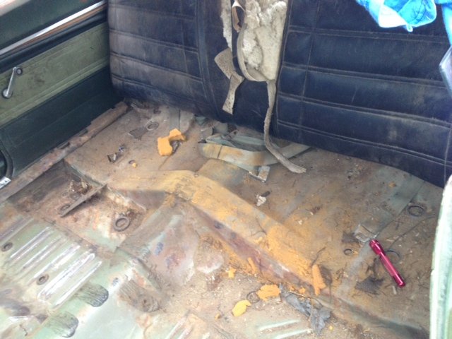

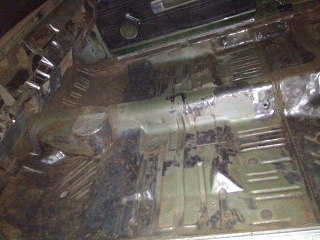

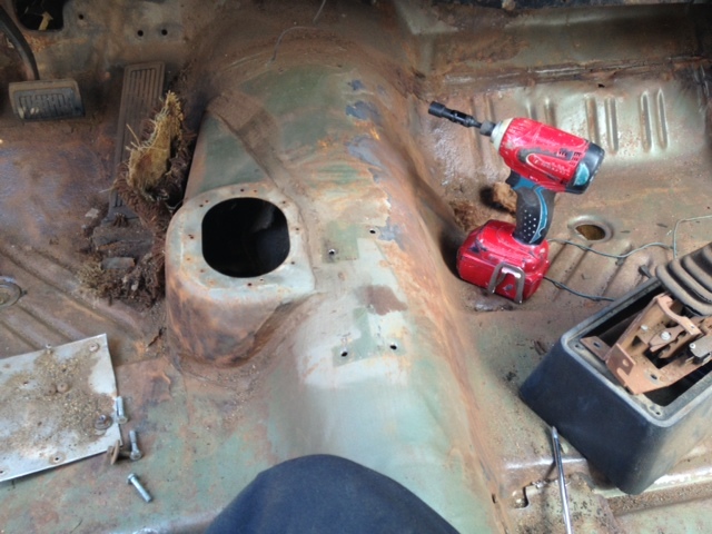

I stripped the car of it's interior and begun cleaning and finding spots I have to patch (Which I'm glad to say the floor pans need no replacing other then 1 or 2 puncture holes from god knows what)

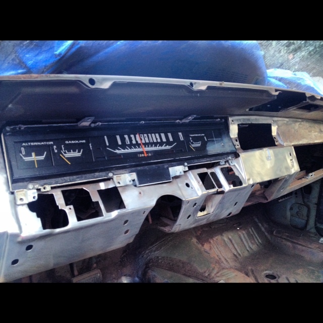

Cleaned up the Dash and bought this cluster for $30. Tempd it up for a picture and back in the box it goes.

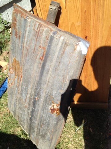

Dropped the gas Tank. Its going to get scrapped

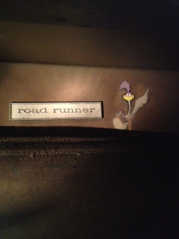

Cleaned up the dash decal

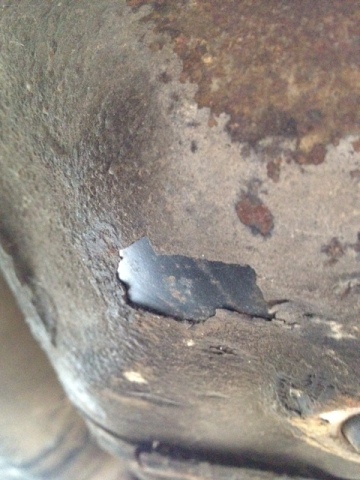

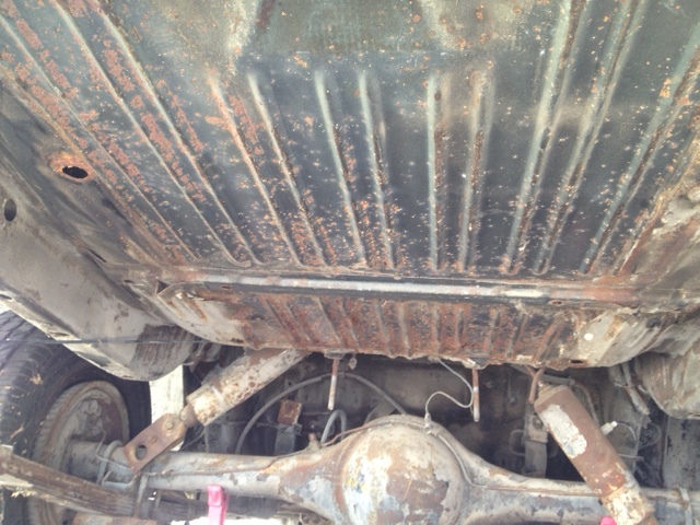

The whole underside of the car is covered in what I believe is a factory undercoating. Everywhere I peel the undercoating off it is nice shiny black

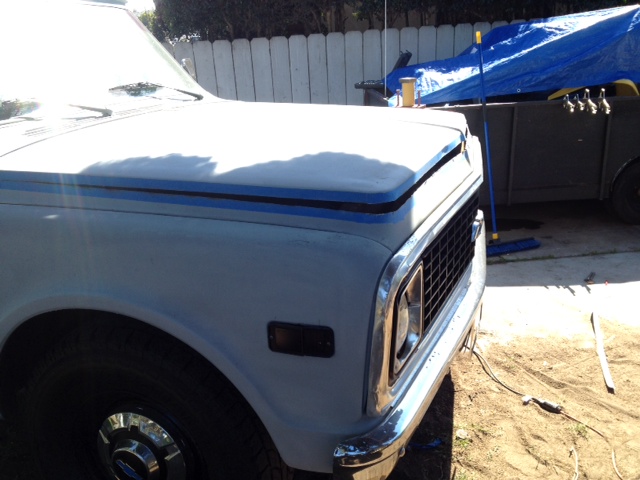

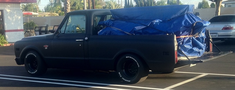

Oh and bonus picture of my c10 that I've been working on for around 2 years
Will be the main hauler for parts for the runner

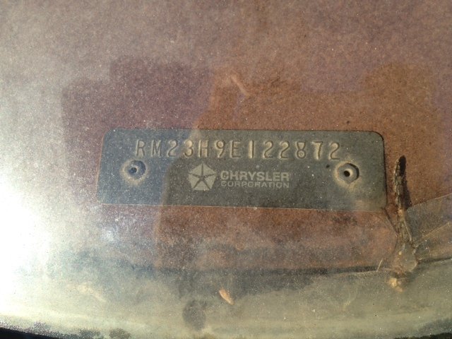

Our cars are from the same plant! LA woohoo been looking for another 69 LA car. Make sure you send it to the registry to immortalize it for ever!
Yours is # 122872 Off the line
mine is # 136923 Off the line
http://road-runner-registry.homestead.com/index.html
Contact Mac aka Mark to send your info and pics to
http://road-runner-registry.homestead.com/About-Us-3.html

also a suggestion if you haven't found it contact the guy who sold it to the guy ... he may have your fender tag in his toolbox or somewhere ... happened with me on previous purchases :)
Thank's a lot! I actually did some back tracing for awhile. One of the guys on this forum actually owned it before I bought it. He bought it from a shop which the name escapes me. I contacted them and they bought it off someone. They said it was going to be used as a parts car but they hadn't really taken any parts off of it. I got the ladys name who owned it before them and found her address's and what not. But never got a response back sadly.

On your initial post, you said "The car has a 3.91 8 3/4 with the sure grip Unit. I was told that the car is believed to be an A31 Option car but cant verify that due to the lack of a fender tag or a build sheet(Which I looked all over for)"
With an A31 package, you will get heavy duty cooling, and Hemi suspension (Plus the already mentioned 3.91 Suregrip). A HD radiator is easy to spot; it has the return hose on the passenger side. The standard duty radiator has the return on the driver's side.
In looking at your pictures, it looks like your car has Hemi leaf springs. Count the number of leaves. Hemi leaf springs have 6 leaves on the driver's side and 7 leaves on the passenger side.
Bottom line is I think you have a good chance that your car DID come with the A31 package - Very Nice!

Gonna be buying another nice size can of rust bullet later this week to finish up the areas I never got to. (The Pillars and the floor of the car) . After I pull the rest of the trunk out I'm going to give cleaning up the frame rails with some various wire-wheels/methods a shot. If that works out I'll rust bullet it. If not I'll try to find a way to get some of the car blasted.

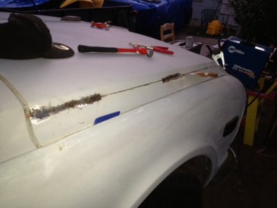

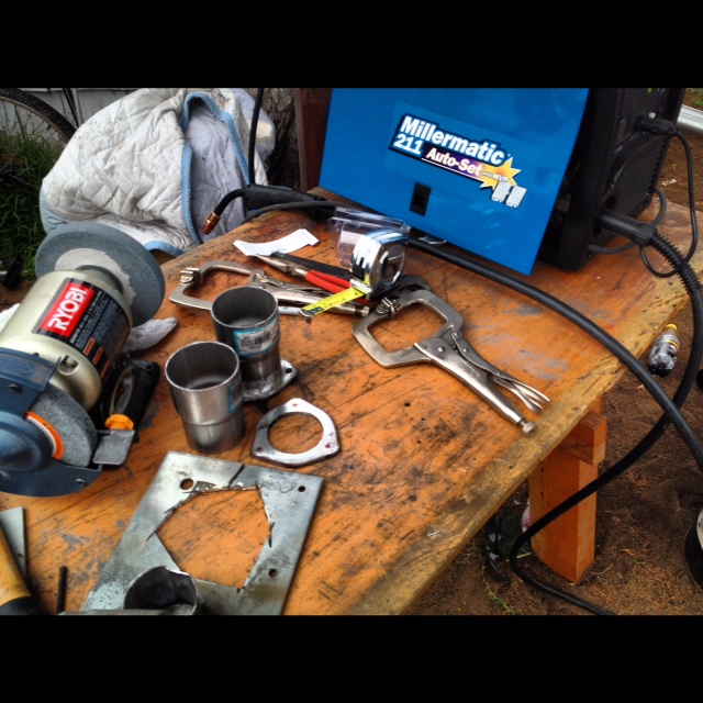

Got to practice with the welder some today for the first time. Here's my first try at messing around with sheet metal. Have had this extra c10 hood laying around for awhile and decided to pancake it, figured a project like this would make for some good practice.
Also fixed this broken chair I had laying around. I love welding! hahaha

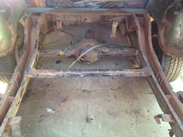

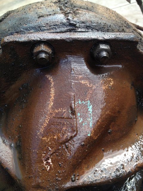

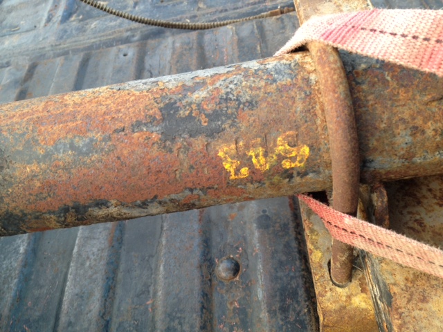

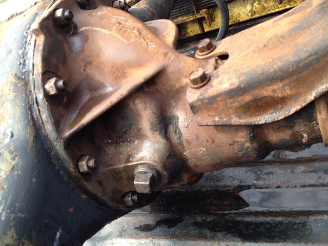

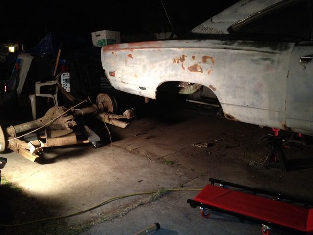

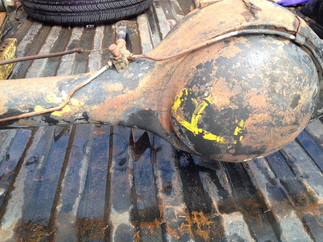

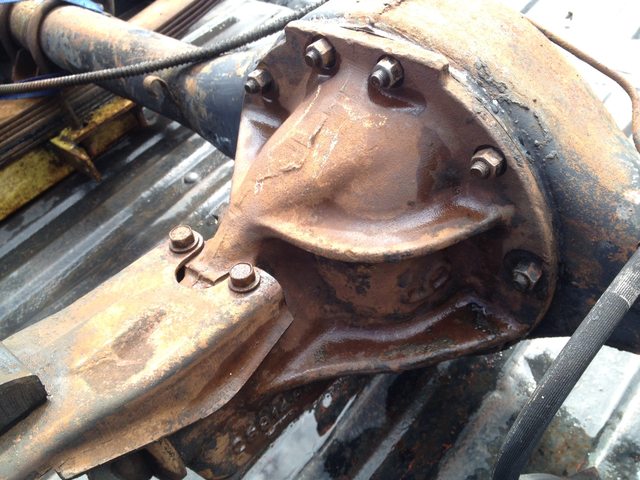

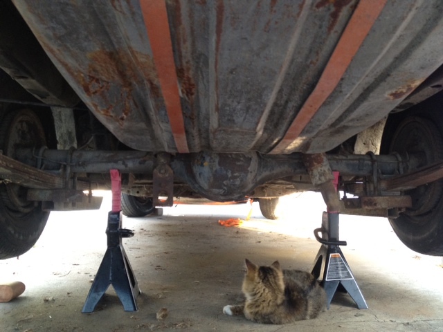

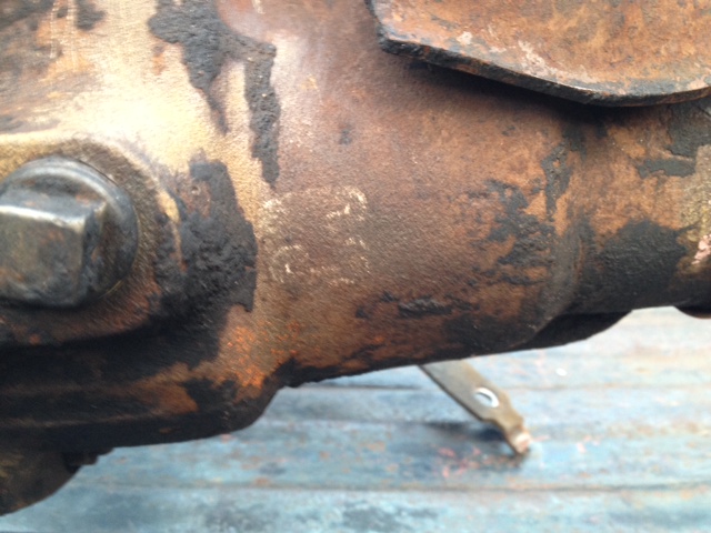

Got a little done on the roadrunner this weekend. I found that the rearend was getting in my way when working on the car. So I decided to pull it out (But left it intact in-case I need to move the car in the next couple months). While I had it out I pressure washed about an inch worth of dirt and grime off it.

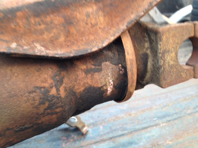

Looks like there's some marks on it. These Inspection marks?
Bottom is covered in orange splotches
Good progress man! I pulled, stripped and painted my rearend last weekend cause I knew I'd have some metalwork coming up under there soon, the extra space definitely helps. And those markings are cool stuff, found the same ones on mine. Got pictures over on my buildthread but it's cool how similar they look.
Some were inspection marks, a lot were date codes from what I could find out. The big sideways "B" on the backside is for B body. All those layers of dirt pretty much turn these things into time capsules I guess lol

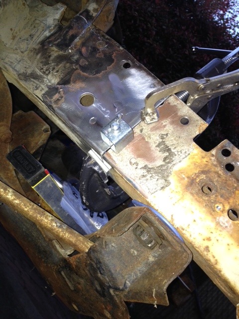

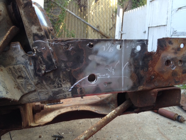

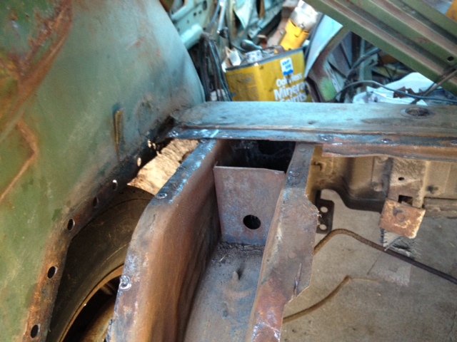

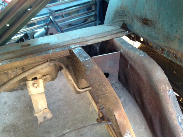

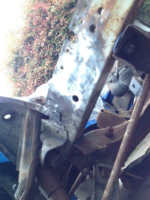

Made a pretty big leap for me as I tackled the bent frame rail this weekend. I must of double checked my lines about 20 times before taking the cut off wheel to it. Then one more time while I had the grinder in my hand :laughing11:...All turned out great! It couldn't of honestly came out better. I got it on the money and everything went super smooth. All that's left is to put the cap back on the end of it that was cutoff when the frame rails where parted from the other car.

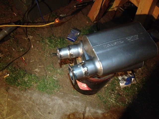

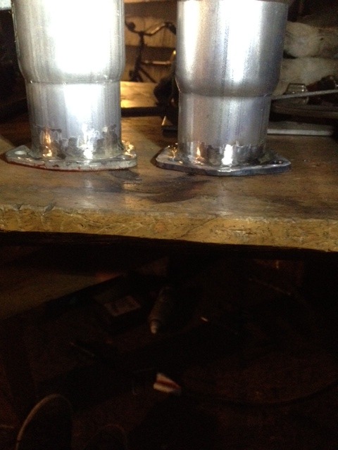

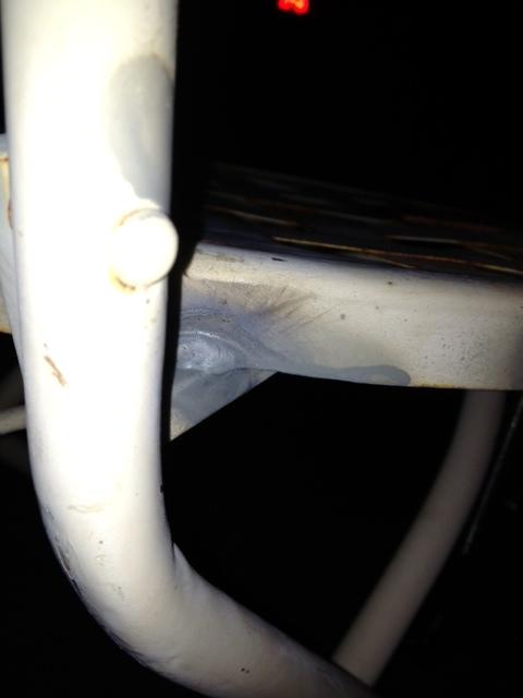

Not relevant to the roadrunner but I also made my buddy a set of custom collectors. Then he wanted his mufflers right after them so I welded them together. We must of stopped at about 10 places before I finally just said screw it and made the collectors myself. Never knew it was so hard to find 2.5 into 3 collectors :blob1:
I was also thinking of bracing the frame rails with some 10-12 guage on the outside with some custom designs in it. Would be a subtle but cool little personal touch. I plan on doing all the extra bracing I can because I want to be in the 500hp range.
Great work on the frame rail. Bet you're glad that hurdle is done.
Good work....Neat idea on the metal designs incorporated into the stiffener material. Best/quickest way to stiffen her up is a decent set of subframe connectors. Keep up the good work.
Well I've been fairly busy lately but I took care of a couple loose ends. Got the whole trunk floor out today

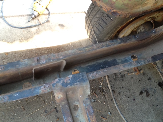

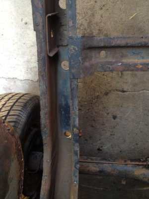

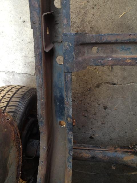

I want to clean the inside of the frame rails that go underneath the rear floor as seen in the picture below but I don't want to cut up the actual floor if I don't have to.(Floor is in perfect shape). Any Ideas. I was almost thinking of cutting a strip out of the floors where the rails are so I could have a blaster get in there and blast it all. But not to sure if it's worth it.
I'm really happy with how the frame rails look on the inside. No pitting of any kind just some light surface rust. So the outside and inside of the frame rails are perfect.

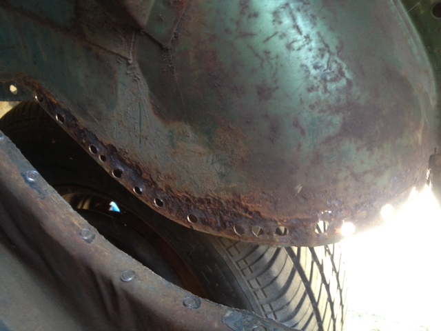

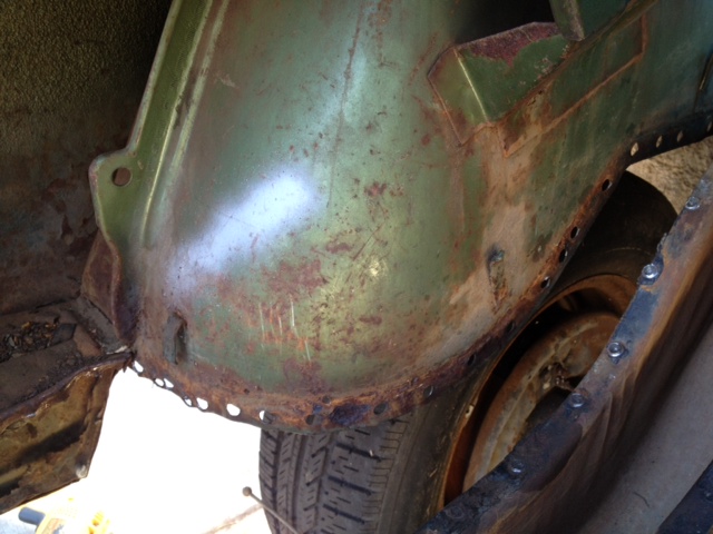

Inner wheel houses need some love. But I will patch the areas that need work.

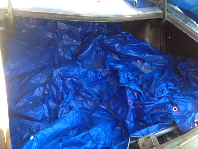

Took me a minute but I got the new trunk floor in. Hows it look! :tongue:
This will be the last of any work done to the car for the next couple weeks until I get my housing situation worked out. Should have a nice cozy garage for the roadrunner soon. Then we will see some real work start on the car. So if your wondering why the RR is on all fours again and "put back together". It's because I'm getting ready to move it.
Frame rails look good but I think your trunk floor has afew wrinkles you need to work out.
