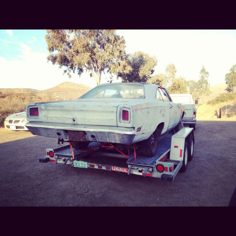

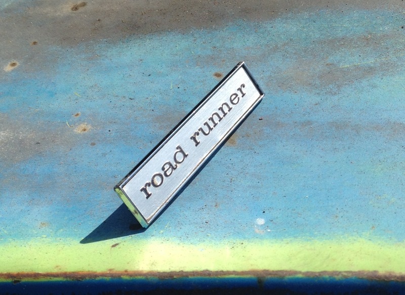

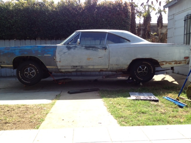

So on to mine. I just bought this girl about two weeks ago. Apparently she was saved from the crusher and/or turning into a parts car two or more times before I scooped her up and saved her. Originally a 383/4 Speed car. I plan on going with the same color as my dads (Sunfire Yellow) Because I have dreamed of having his car forever(Minus the post.. I like the Hardtop with the roll down windows) I dig the old school look so I'm going for keeping the car mostly original looking other then having some decent audio, disc brakes, and some other small stuff. So I will most likely go with rally wheels, redline tires, and some caps. Young guys like me who like the old stuff are a dying breed. Guess that's what happens when you grow up around cars/motorcycles. Gives you a bigger appreciation for the good stuff.

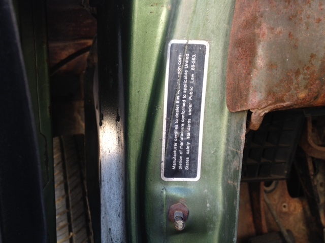

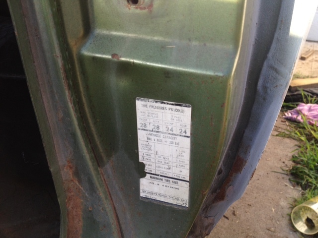

The car has a 3.91 8 3/4 with the sure grip Unit. I was told that the car is believed to be an A31 Option car but cant verify that due to the lack of a fender tag or a build sheet(Which I looked all over for)

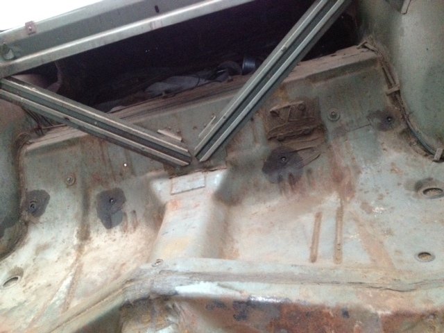

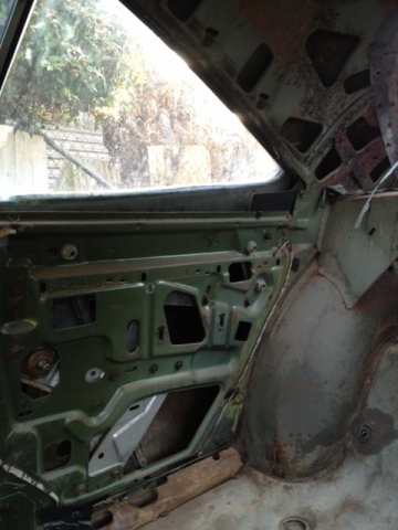

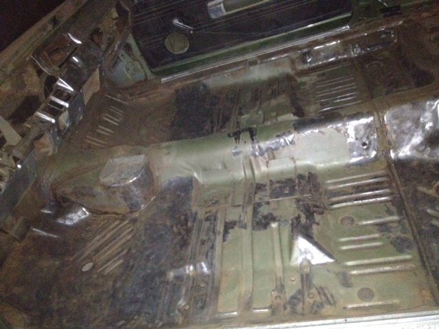

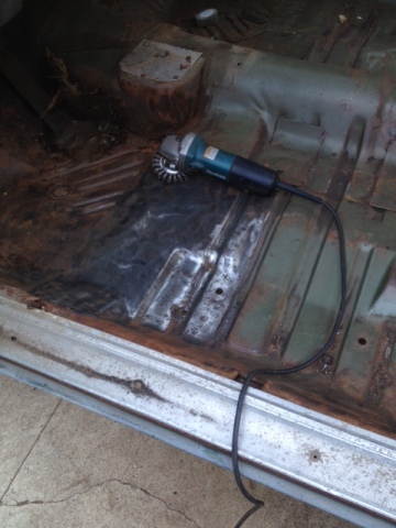

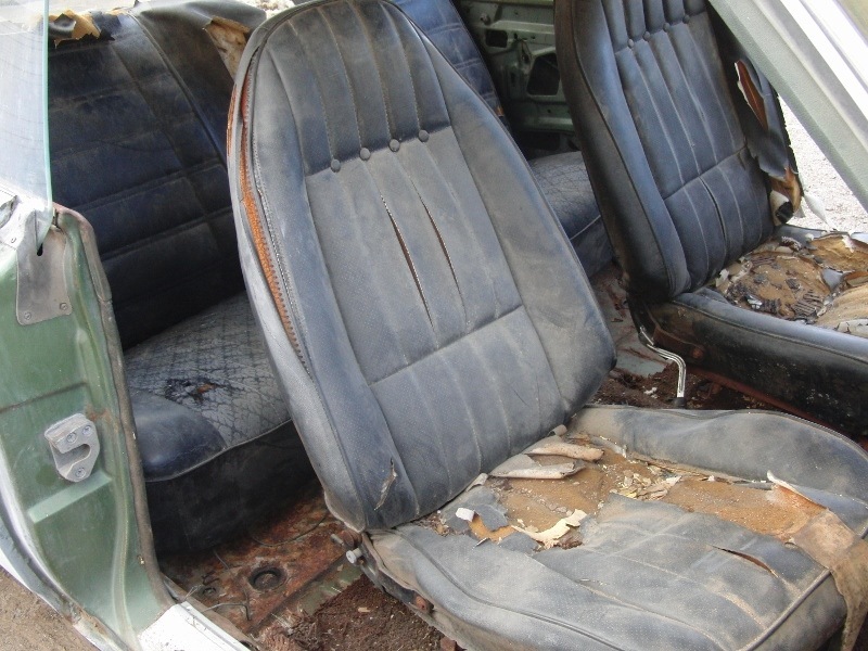

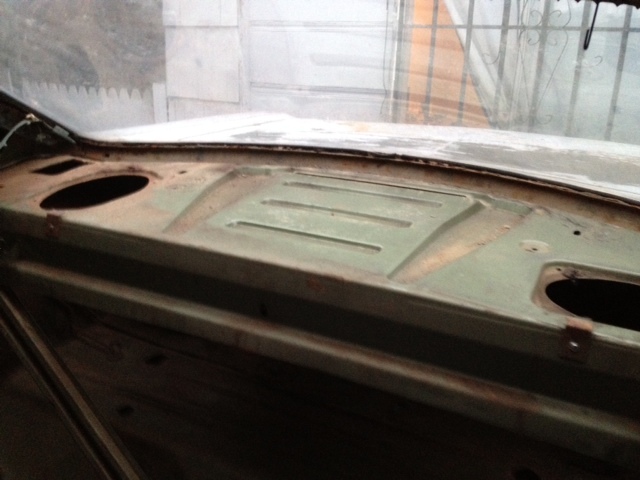

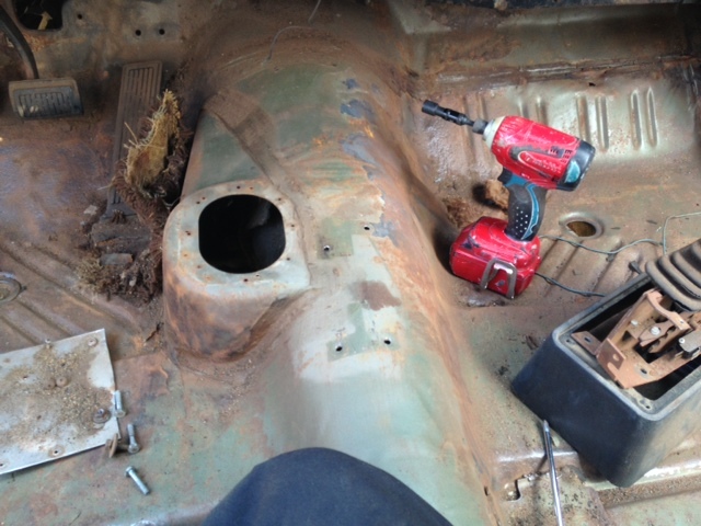

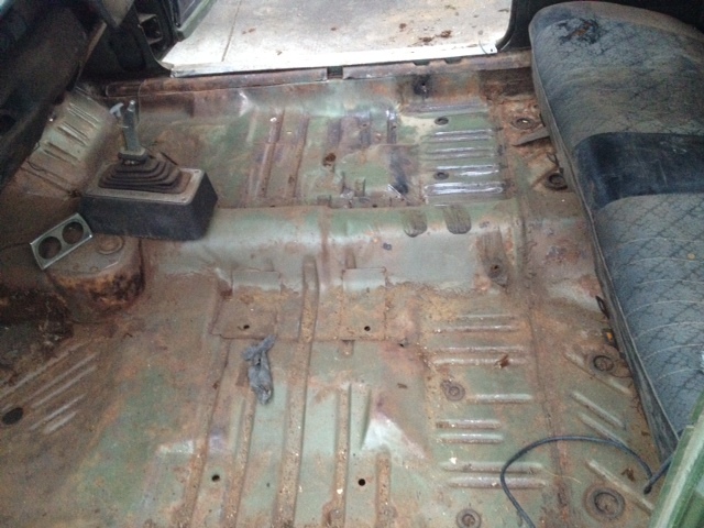

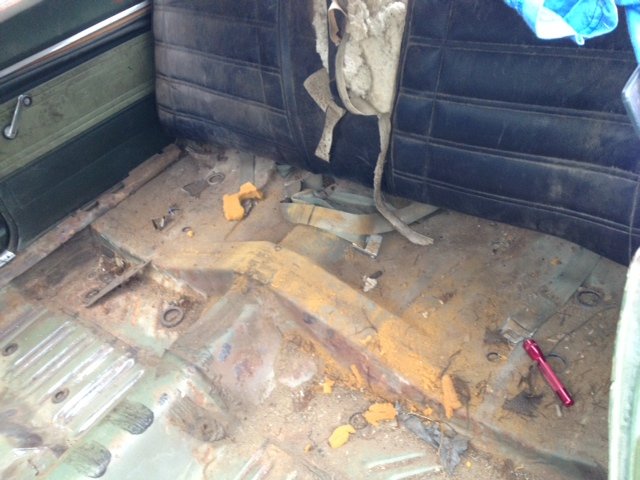

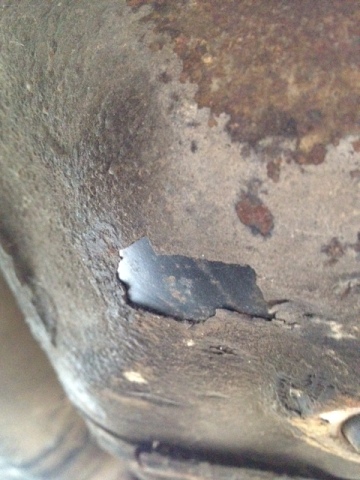

I stripped the car of it's interior and begun cleaning and finding spots I have to patch (Which I'm glad to say the floor pans need no replacing other then 1 or 2 puncture holes from god knows what)

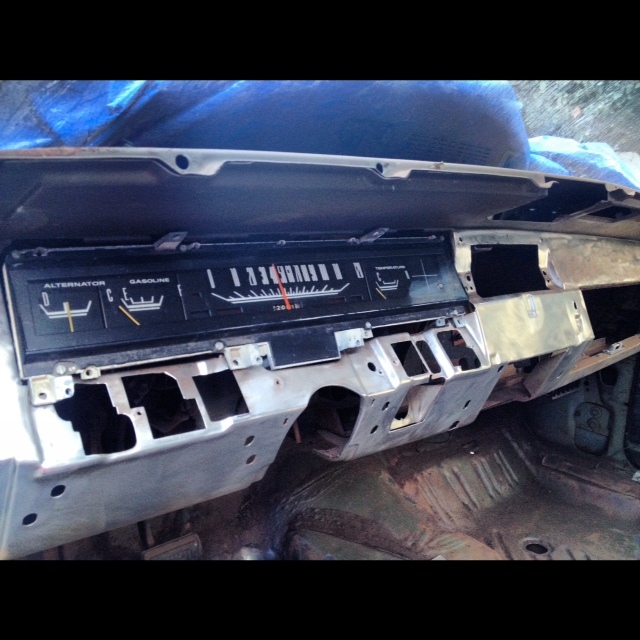

Cleaned up the Dash and bought this cluster for $30. Tempd it up for a picture and back in the box it goes.

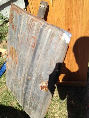

Dropped the gas Tank. Its going to get scrapped

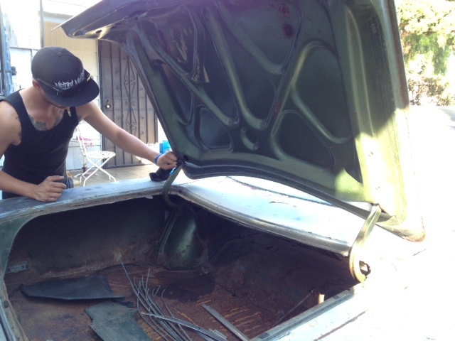

The trunk floor will need to be replaced. But the underside of it looks nice at-least :hello2: Doesn't matter though since its getting a full trunk floor replacement

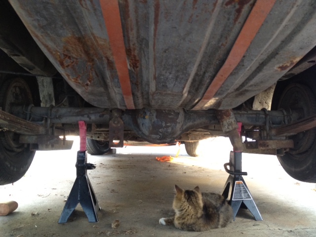

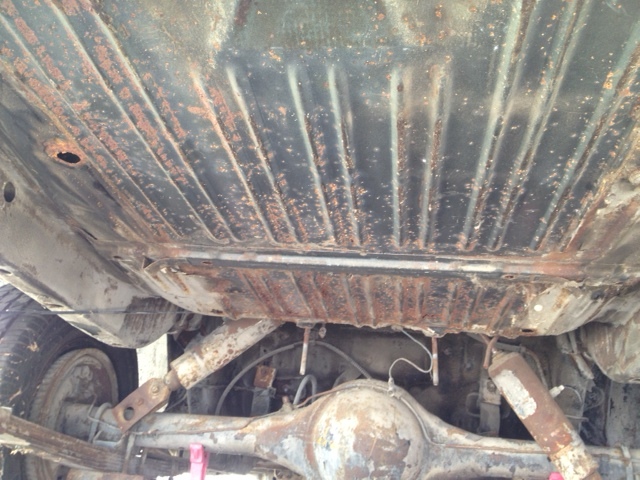

The whole underside of the car is covered in what I believe is a factory undercoating. Everywhere I peel the undercoating off it is nice shiny black

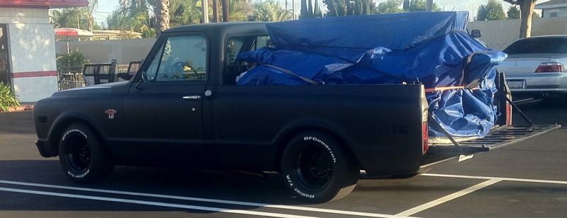

Oh and bonus picture of my c10 that I've been working on for around 2 years
Will be the main hauler for parts for the runner

The body is pretty solid. The roof is in great condition and I have already got it nice and shiny. Ordered some rust bullet for the floors and roof and will start that when it gets here. Due to living close to the beach Im going to do the rust bullet before I begin to patch the two little holes in the floor for peace of mind. The quarters although look solid do have a fair share of bondo and some rust in the common areas. So I plan on doing full quarter replacements.. I'd do a skin but not having to weld as much with the full quarter is appealing to me. Dutchman panel is a goner and will also need replacing. trunk is pretty nice but has a nice dent on the rear body line and someone added a wing or something to it in its past so it has 4 holes in the top and dents around them. I'm going to try and save the trunk lid by working some magic on it. Going to have to cut the bracing out of it to get access to the dent in the back of it. Overall the car had what I wanted. A super solid frame, underside of the car is super nice ,roof , interior metal is all perfect other then the trunk floor. And a nice rearend setup with the gearing I wanted. . The cowl needs replacing. It got ruined in the accident and someone did some shotty work on it. I'm a little of a perfectionist sometimes so I want it all done the right way. As for the name. I liked Charlotte the roadrunner. so that name has stuck.
