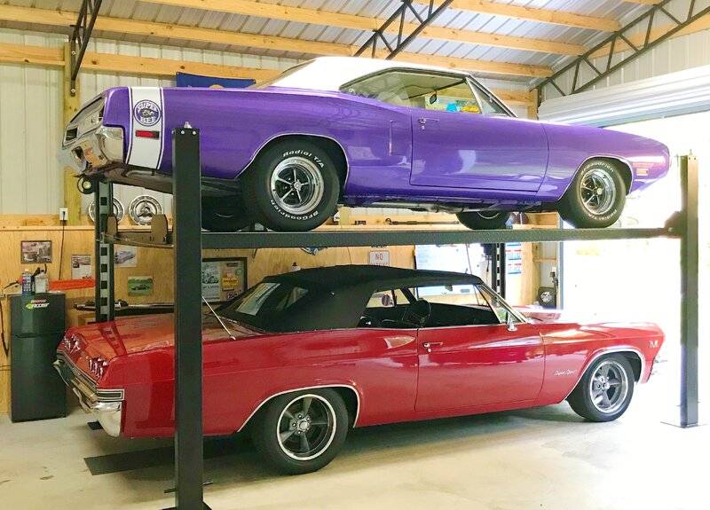

The walls in my shop are 12 feet. It's really a barn and the ceilings are 23 feet, got plenty of room. I can raise the car all the way up with the long-*** Coronet hood open and it's nowhere near anything. The hood is well above the top of the lift when open.

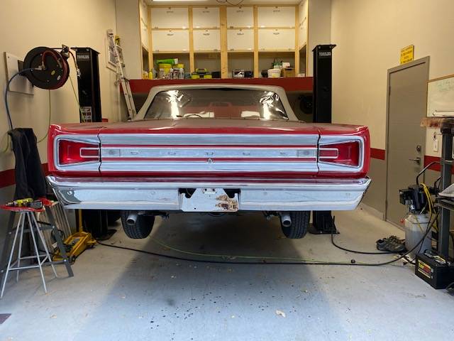

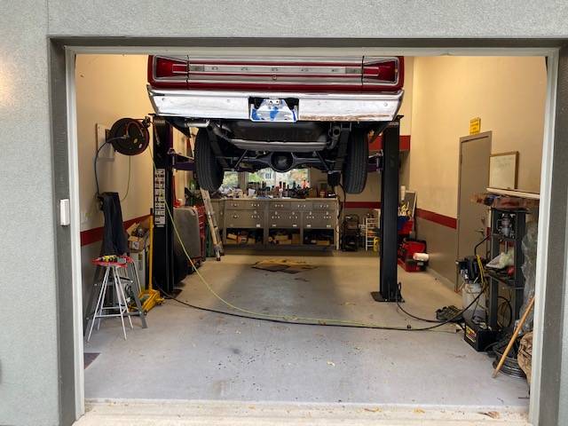

When I had this house built, I put in this lift. It is called a C-7000, which of course means 7k lbs. The Legs are movable in case you want to use for a truck or tractor I guess, though I doubt that I will move them. It has a detached pump which is for the moving part. I suspect that I will mount the pump and string the lines up high when this project is done. I had them pour 8 inches of concrete and put the rebar 12 inch on centers with more where the legs would go. It seemed to be a really good idea for strength, but we hit rebar on three of the holes when we drilled. We solved that, but it was a PAIN. The bottom of the Coronet is just about 6 feet from the floor. I'm 5 8, so it works for me. I fully agree with the above, if you are considering it, DO IT! It changes the way one looks at a project. Oh, it runs on 110V. Best to all. B.
Oh, I forgot. I have mine set at 110 inches to inside between the posts. The free standing posts allow for that kind of flexibility if you have a smallish or irregular sized garage. The legs, I think are 7' ish.

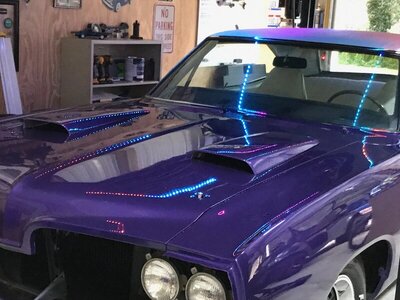

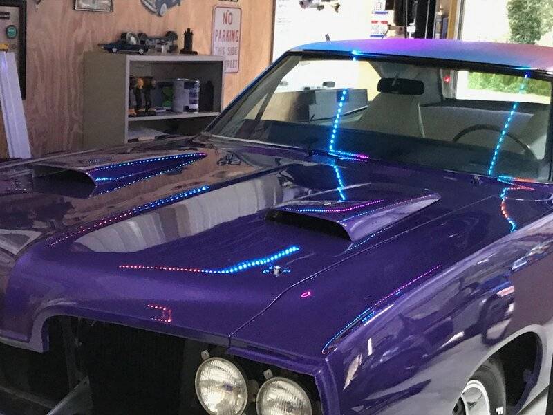

I cant be the only one who has LED lights so the lower car is lit up ...right....:realcrazy:
