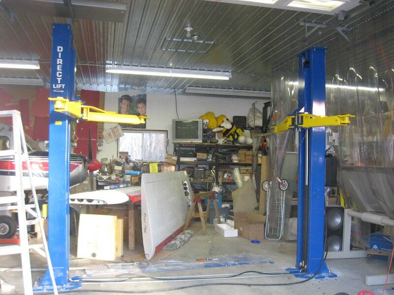

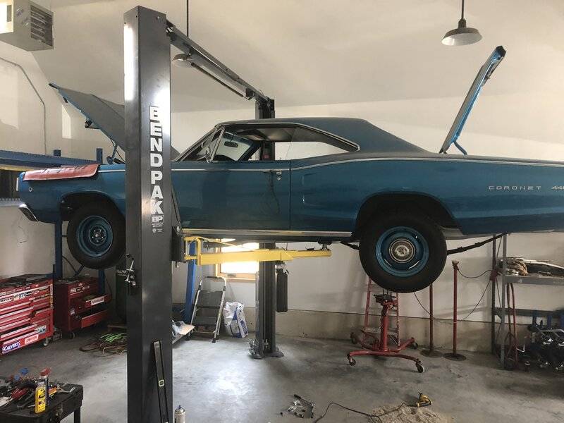

Paul, go with a free standing 2 post without the top cable crossing, you're just giving up room there. My shop is 10' 3" to the ceiling, my lift posts are only 9' something.. I'll measure them later and let you know, possible you can just stick the extra couple inches into the ceiling. I can walk under my cars, even the Bird with it's rear wing and I'm not lifting them to full ceiling height as I have a light tray in the way.
