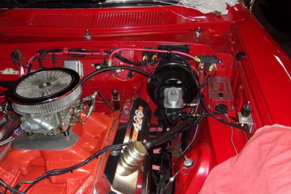

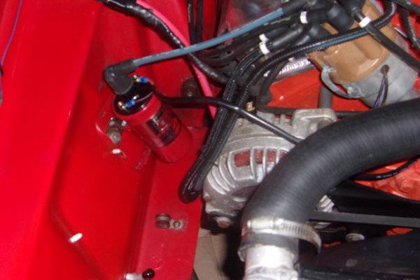

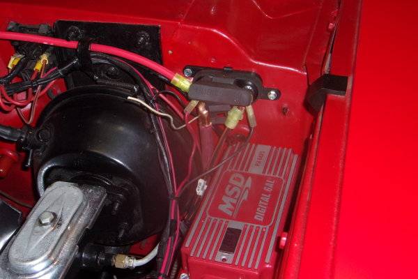

Finally installed MSD on my car.

Yes I got a good deal and an MSD 6A digital box. So I bought an MSD coil and installed and wired it up the other day. My old Mopar ign worked fine but with the MSD multispark at 3000 RPM and below I hope it will keep the plugs cleaner even longer. I could go all summer on the same plugs and rive and race on them. So it will be nice to see how it does as I have always planned on going to MSD when I got the money. Ron
Nice, let us know the outcome. I think you've got the best carb heat isolator ever made under that carb!
My best friend has a 6A on his hot 383. Loves it, runs fantastic.
Ehrenberg says there’s no horsepower in ignition, and I agree with his logic, but I know my buddies car run like a top. May not be more powerful but it starts and runs perfectly.
I've heard the "No Power in ignition" argument but I've also seen how much more completely an MSD burns a ragged mixture...
