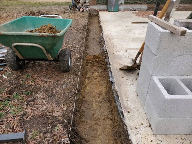

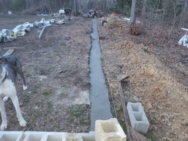

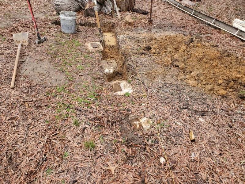

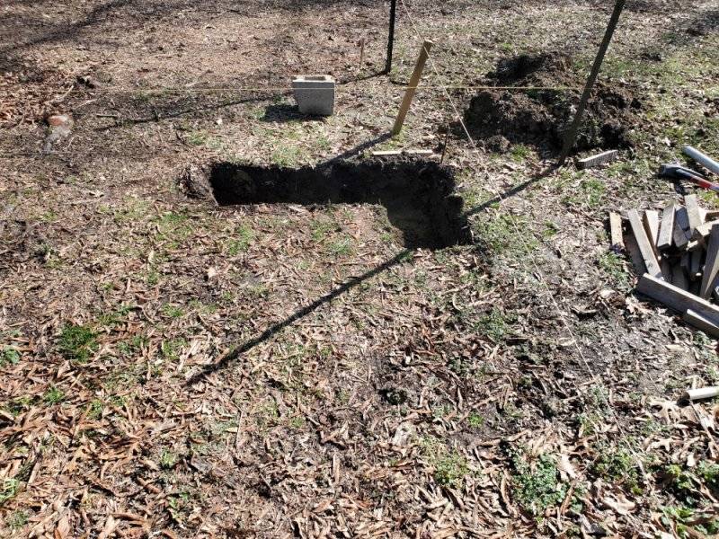

So my first step is to find and get the height of this corner of the shop . . . got my line laid out . . .

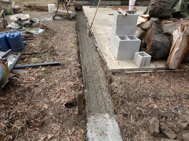

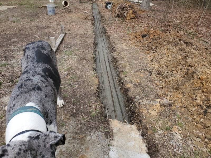

And digging some footers . . . putting them in the ground prevents the wood forms from failing on me . . .
In between the rains . . . I was able to get some footers dug and get this corner ready for concrete . . .

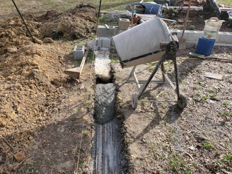

And got it poured . . . Of course, the inspector is checking on my work . . .

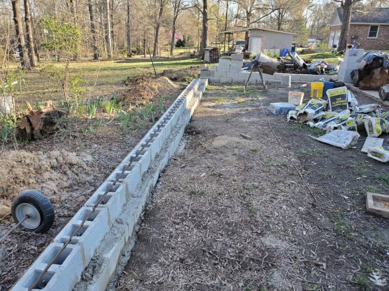

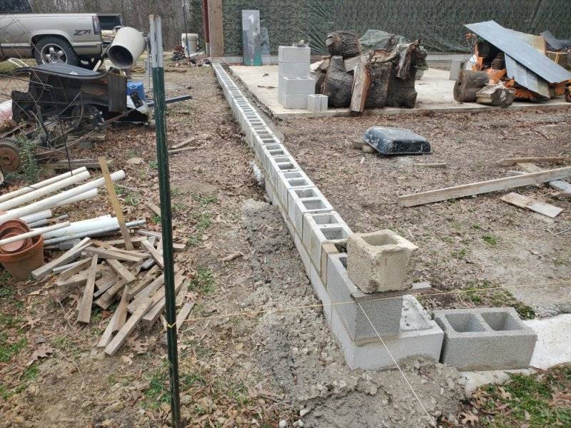

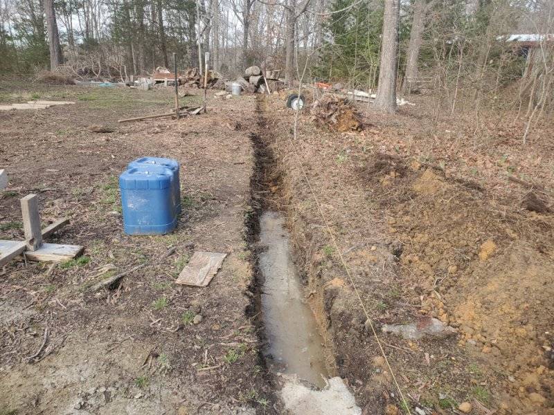

Back to the footers . . . continued the footers along the front side of the building . . . trying to get this level . . .
The step is 8" to allow me to place blocks for the deeper areas . . .

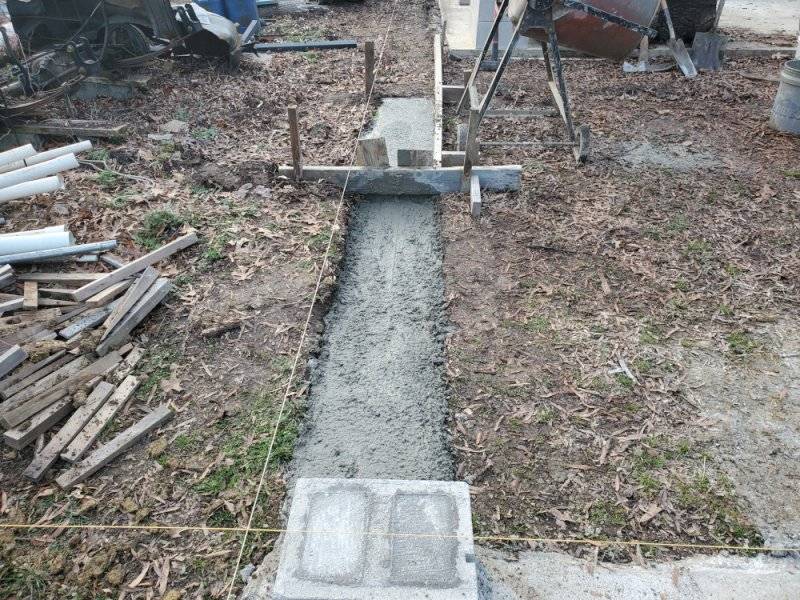

Got the corner bloc set so that it can be an anchor point for this whole side and hopefully get it level ( as possible ) . . .
Get the blockwork done on the deepest part of the foundation . . . and the block in the corner is pad height . . .
Another view . . . with the inspector in the way . . . of course . . .
Didn't think my ground sloped off this much . . . but this is now the building will set . . .
