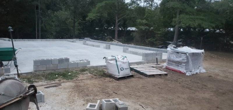

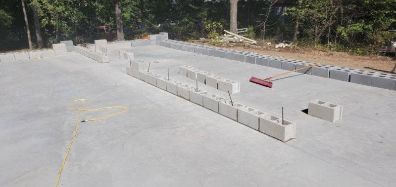

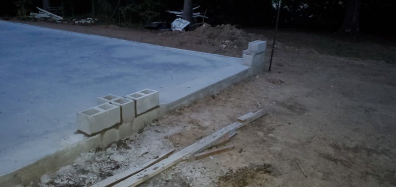

Started the beginning of the week trying to set up the corners of the blocks to help be able to run the blocks . . .
And the location of the middle wall - along with the for corner . . . both courses . . .
And wayyyyy in the back . . . the last corner of the shop . . .

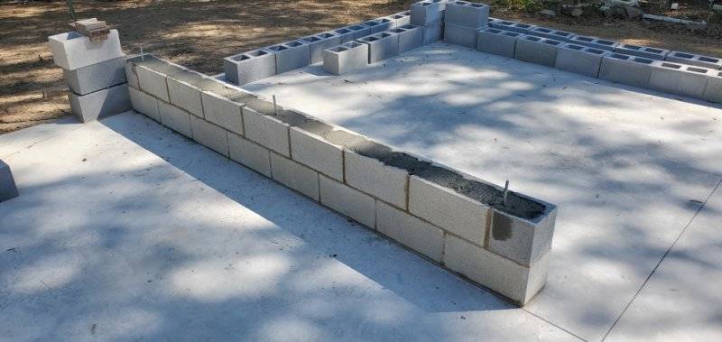

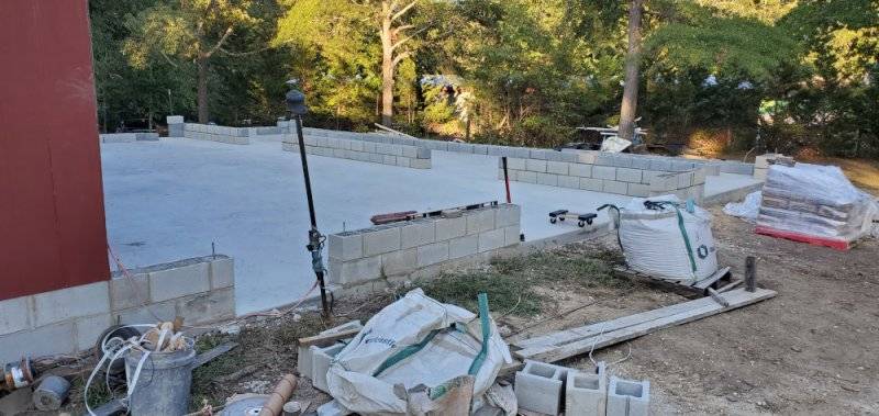

Prepping the site for the blocks, get the blocks all set out where they need to be . . .

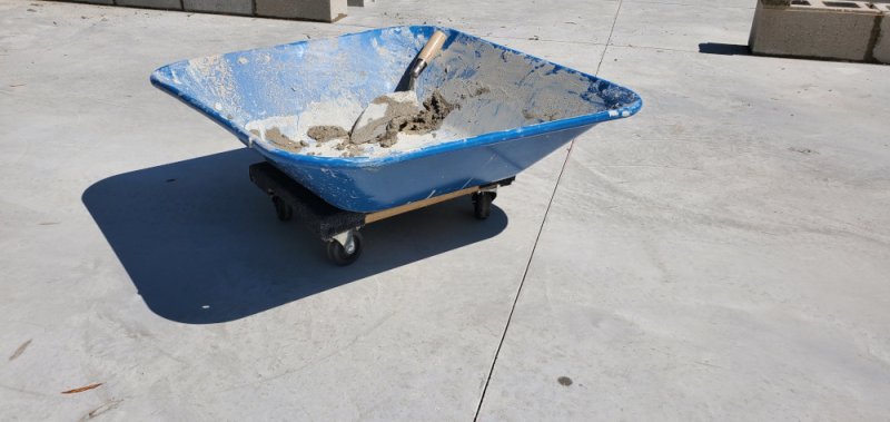

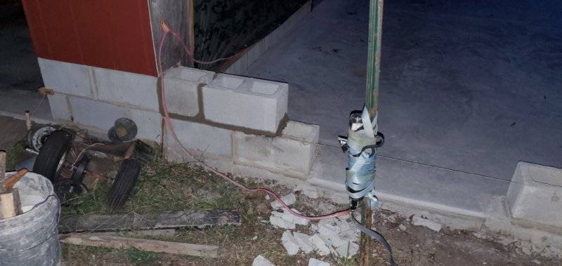

Had this idea for the mortar bin . . . and being able to move it around ( got a great concrete slab to assist )

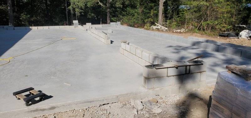

The middle wall is kinda important as it's probably the next wall to go up and get the center section built . . .
Both course have been set and they're getting poured full of concrete and setting the anchor bolts to hold the walls . . .
Middle wall is completed less the concrete inside of them . . . but it's starting to look like a building . . .
And if you didn't ALSO notice . . . the front wall of the shop is also completed . . . and also filled with concrete . . .
And . . . the anchor bolts are set in the wall too . . .

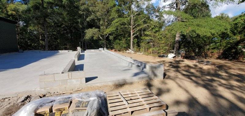

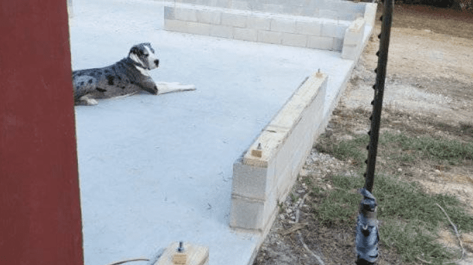

Another day . . . another day of progress on the shop build . . .

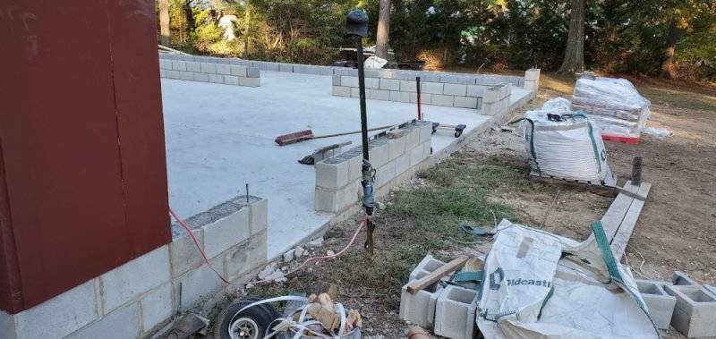

Gotta love it . . . things are finally starting to happen after that long foundation prep . . .
Got all of my center walls filled with concrete ( thought I was done with concrete )
- and got the anchor bolts set in the concrete for the sill plates . . .
- here's the center section of the wall
And the back section of the wall . . .
The first course of the wall on the far right is now set . . . ready for the second course tomorrow
- will be working on that in the AM when the site is in the shade of the trees . . .
( not like this first course that was done in the heat of the day with the sun blaring . . . )

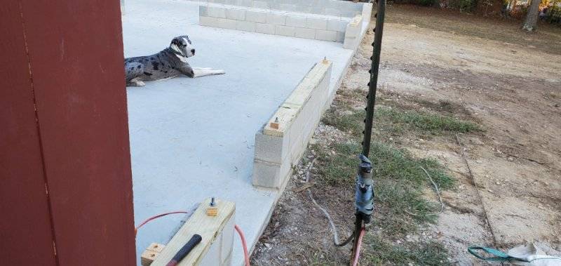

And last but not least . . .
The concrete slab has been Obie Approved ! ! ! !

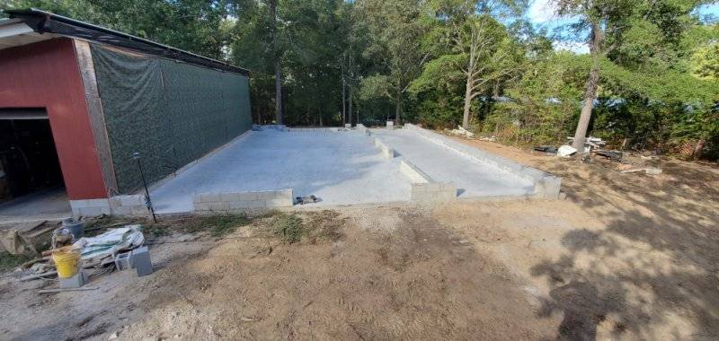

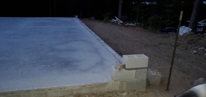

Now for a nice change of pace, but first, let's get up to date on the foundation . . .
All the wall have been set - except for the back wall - trying to figure out what I'm going to do there
( we'll go over it at the end . . . )

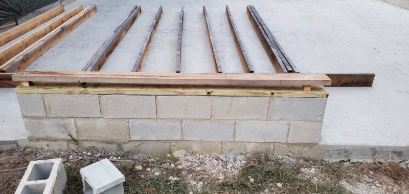

WOOD instead of concrete for a change of pace ! ! ! Cutting the sill plates with pressure treated 2 x 6 . . .

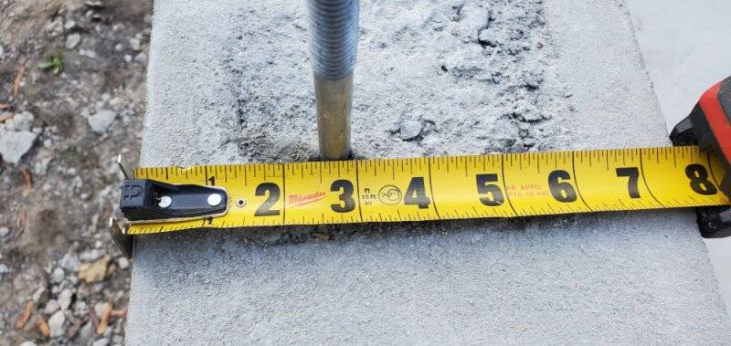

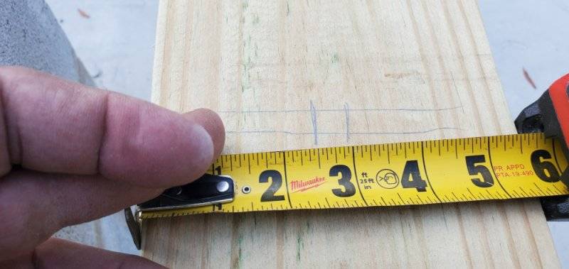

Here's how I get the hole to line up ( this can be a rea pain when you set the wall and they don't match up ! )
Cut it to length . . . stand it up on end, mark on both sides of the bolt . . .
Measure the offset from the front face of the building - 2 1/2" - 3" for the bolt . . .
Measure the same distance from the front edge of the board . . . that's the hole location . . .

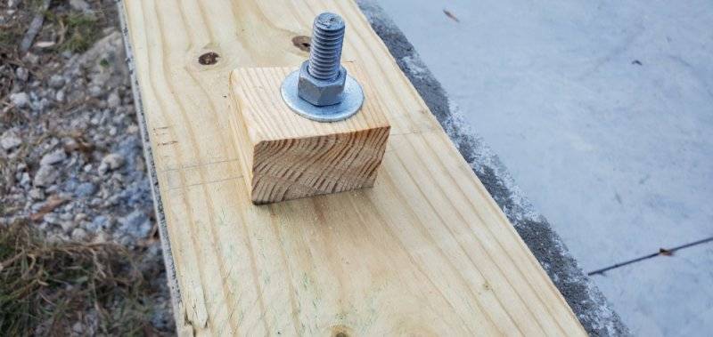

As for drilling . . . 1/2" bolts are drilled in the wood with 5/8" hole to give some wiggle room . . .
Now that I have them set, and they will sit in the sun for a day . . . I want them secure . . .
Cut small pieces of wood and drill holes to take up the spacing of the 2 x 6 at the bottom of the wall . . .
Tighten it down and let it hold these boards in place till the wall gets placed on top of them . . .
Got the first 3 sill plate set in place and bolted down . . . to hold them in place . . .
And - YES - the foam has indeed been paced under the sill plates . . .

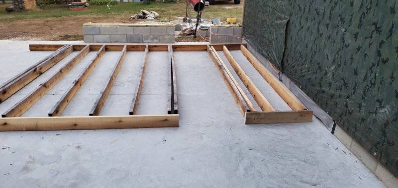

And now . . . working with EVEN more wood . . . don't know if I can remember how to do this . . .
Laying out the first 16' of wall - getting ready to have it built and set into place . . .
Went through the same process with the bottom 2 x 6s for the wall - and made sure the holes did line up properly !
And . . . tomorrow these boards will all get cut to the proper length and get put together . . .
And . . . hopefully . . . it'll get stood up and place on the sill plates . . . That'll be a great feeling ! !

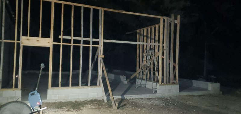

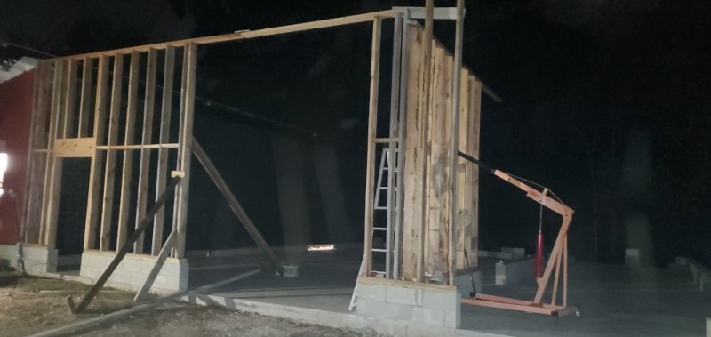

Under the lights . . . the first wall of the center section is installed ! ! ! Whoooohoooo ! ! !
Started on the wall when there was some light, but the light disappears quickly this time of year . . .
Still got some things to do, but it's up and in place . . . It was a good day . . . ( make the evening )
- need a 2 x 12 for the header over the people door and the garage door too
- a bit more framing above the headers too
Got hopes for a LOT more of this to be happening this weekend . . . and looking forward to it ! !
Thought that my tractor was going to be a huge help - but the backhoe did not help out as much as hoped,
it does not go high enough to be real helpful . . . will be trying the bucket on the next wall . . .
Once again - the trusty old Cherry Picker came to the rescue and got the job done . . .
- it moves buildings and lifts walls . . . even used it for an engine a couple times . . .

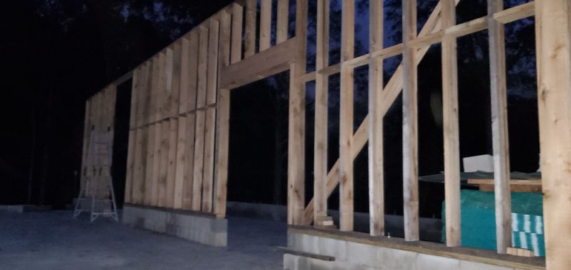

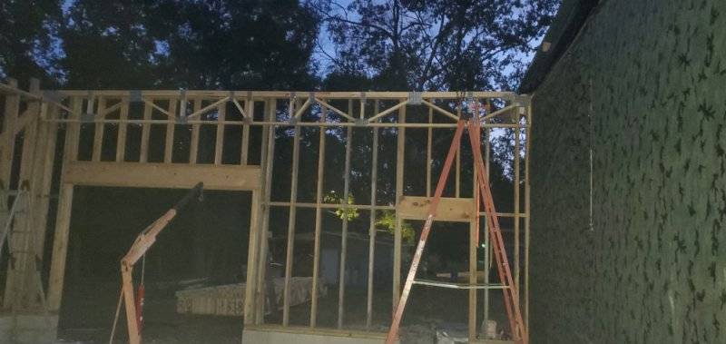

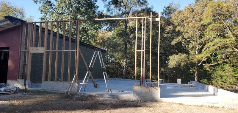

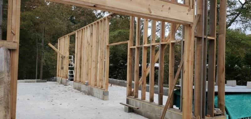

Was hoping to get more done this weekend, but tonight's effort sure helped out . . .
Had a pretty good weekend, and got some stuff done . . . but was hoping to get further on this . . .
Once the wall got stood up, the rest of the wood could be added ( less wood, less weight . . . )

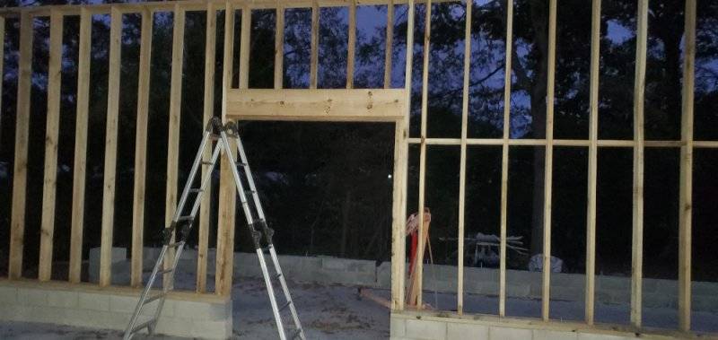

Working on framing in the doorway . . .
Think that'll work pretty good on the the top of the door . . .
Finish framing in the header and the studs above the door . . .
Next in line, is the other side of the garage door . . . only about 2 feet and then it's into the other lean-to . . .

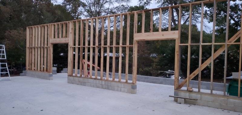

Speaking of . . . the end wall had not been fully filled with concrete nor set the anchor bolts in place yet . . .
And I thought I was done with concrete . . . Argh ! ! . . . but got that wall all done so that wall can be built too . . .
Got home from work about 6:00 . . . and got started on this wall - had not one bit of it done . . .
as the daylight left . . . had it ready to be stood up and almost in place . . . now all that is left . . .
IS to stand it up on the wall, and get the bolts properly placed into the bolt holes . . .

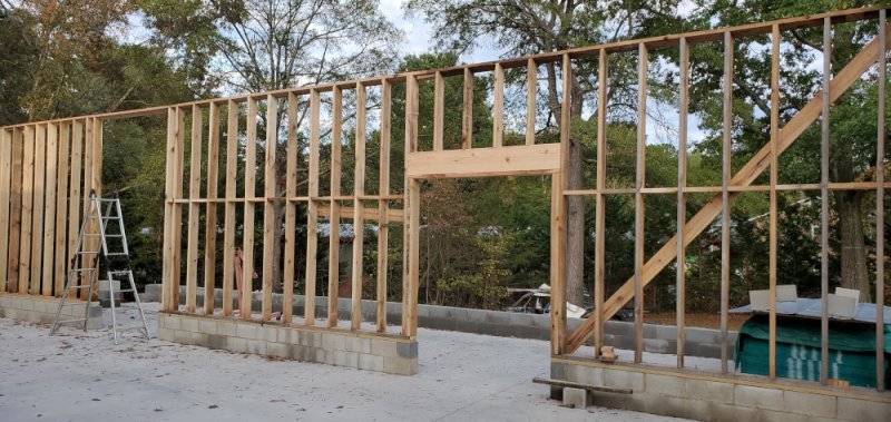

Not too sure which of these pictures gives the best perspective . . . but the wall is in place now . . .
This is jut a little different view to give you the perspective . . .
Lastly - added the cross boards to indicate an 8" door . . . was thinking a 10 x 10 . . . but thinking 8 x 10 now . . .
Got home from work about 6:00 . . . got started on the wall . . . by 8:00 had it built and placed on the cinder blocks . . .
CAN'T complain about that . . . Happy to be heading down that stretch already . . .

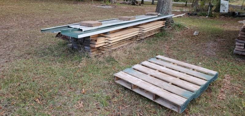

2nd Floor trusses are being delivered on Friday . . . might have some floor installed this weekend . . .

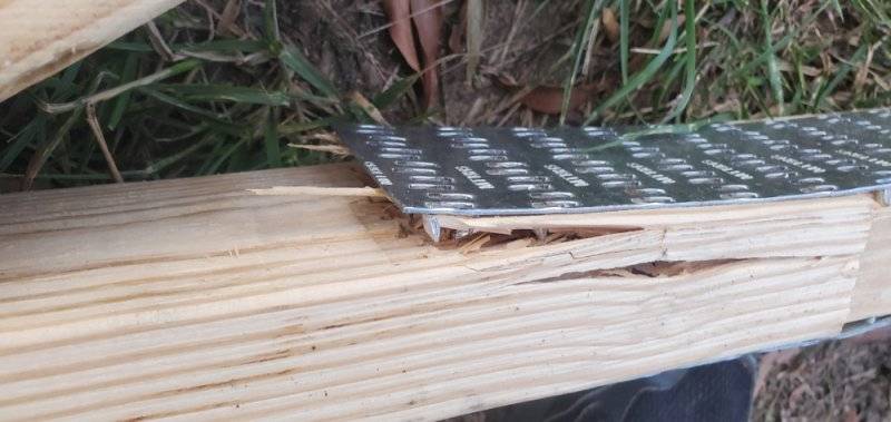

Good weekend . . . the good, the bad, the screwups, and fixing the screwups . . .
Still making progress, and making progress on the build . . . but things happened this weekend . . .

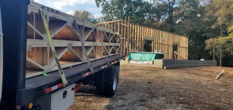

Trusses were scheduled to be delivered on Friday ! ! ! Very excited . . . could not wait . . .
Got started Thursday night under the lights . . . and got this panel installed above the door . . .

Then on Friday, the next section of the wall was built . . . and stood up - while waiting for the trusses . . .
Progress ! ! !
The pile of wood is slowly getting smaller as the shop is getting bigger ! !

Then on Sunday . . . got the last part of the wall built and stood it up in place ! ! ! The wall is up now ! !
Then . . . got the header built over one of the doors and the framing above it done . . .
Next . . . got the fire stops all installed in the center section of the wall . . . past the halfway point . . .
And the pile of lumber is continuing to shrink . . .
Just another look at the wall . . . and it's moving along quickly . . . Love this view ! ! !

Got the doorway and header all set up and in place . . .
Then got the remainder of the fire stops in the end piece of the wall . . .
All done, with the exception of needing a 2nd header across the top of this whole wall . . .
Tried a different view, but the 2nd header has now been installed . . .
With the rain in the forecast for tomorrow, they delivered the trusses today . . . at my request . . .
Showing up at the build site and ready to drop them off . . .
But in usual "mad scientist" fashion . . . things don't always go as planned ( he was quite pissed )
But we just grabbed them all and restacked them on 6x6 timbers so they're not sitting on the ground . . .
The fall caused a minor mishap and a minor injury to one of the trusses and the metal straps . . .
