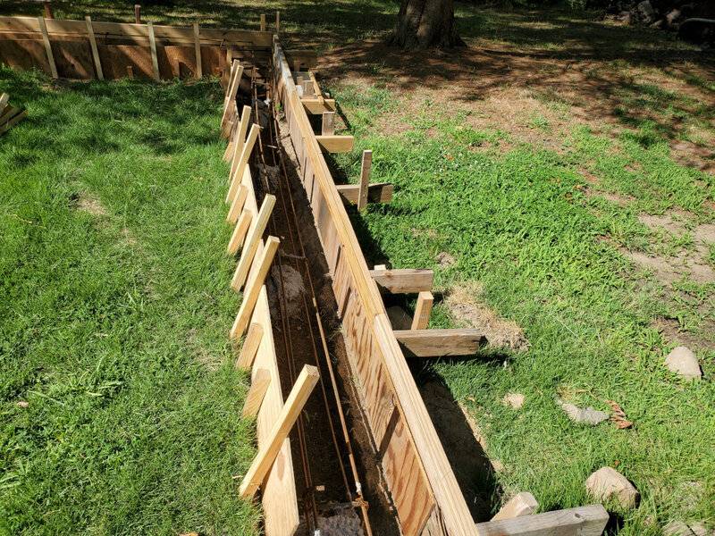

Got some more framing done, getting the inside edges ready for the concrete pour tomorrow
(note: looks like it will be Tuesday as the weather for tomorrow is looking very wet for my area)
This will allow me to get the inside edges high enough to hold the crushed gravel that will go in the center area . . .
If you look inside the openings, you'll see how I set the rebar cages in concrete to hold them in place so they won't move when the concrete is poured - sure hope that this is going to work . . .

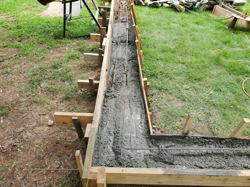

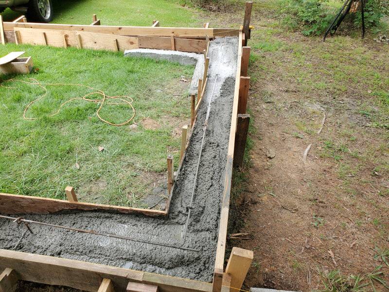

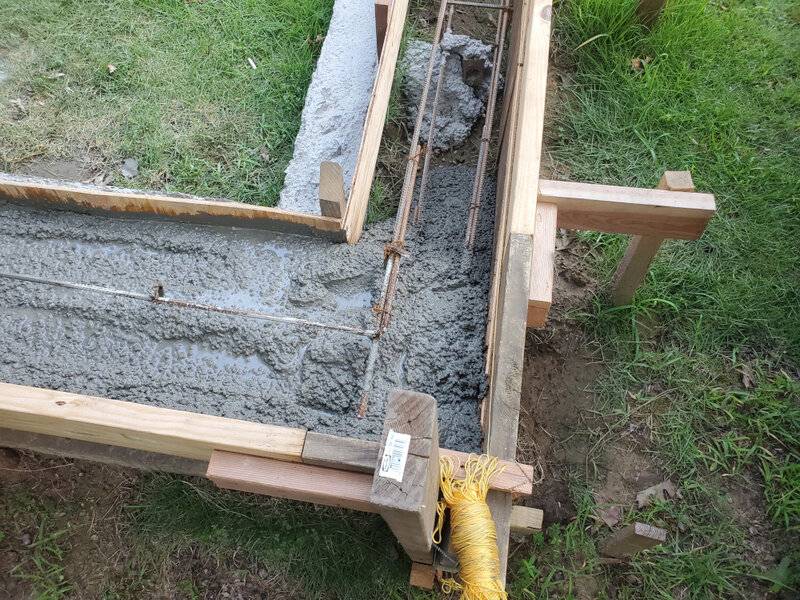

First 21 bags done . . .
21 bags is about 1/2 yard . . . so the next 21 will get me to 1 full yard . . .
( ignore the electric mixer in the picture )
Even made it a bit around the corner too

Note to self: If you're going to claim you used a wheel barrow and a hoe, YOU need to do a much better job of hiding the electric mixer and not have it in plain view in one of the pictures . . . dummy . . . LOL
Just messing with you guys ! ! !

It's 11:30 . . . and the next round of 21 bags is done . . .
Had a little Heart Stopping moment this morning when the Wheel Barrow and Hoe would not work . . . I mean, I plugged in the electric cement mixer and . . . Nothing . . . so I'm thinking . . . "Great - Now What ?" But it turned out that the wall outlet in this shop had a plug-in type and it was not making good contact (funny that it worked fine for 2 hours last night), so I pulled it out, re-seated the outlet in the wall strip, and everything is back up and running . . .

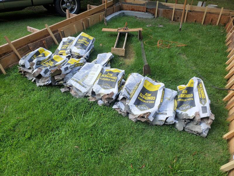

So, 21 more bags are done, that's one full yard of concrete . . . I'm starting a collection . . .
This 13' end - which 9is the deepest area of pour - is fully completed now . . .
AND I'm starting my way down one of the 50' stretches . . .
