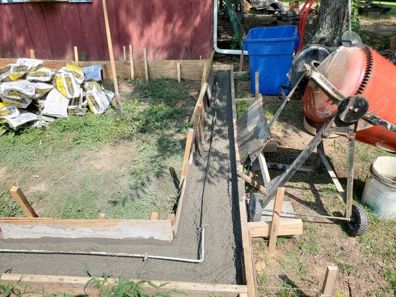

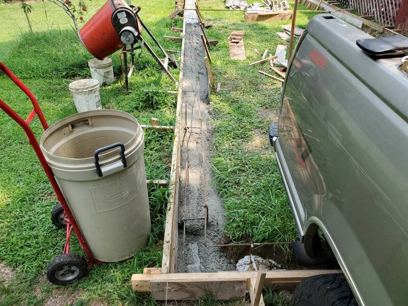

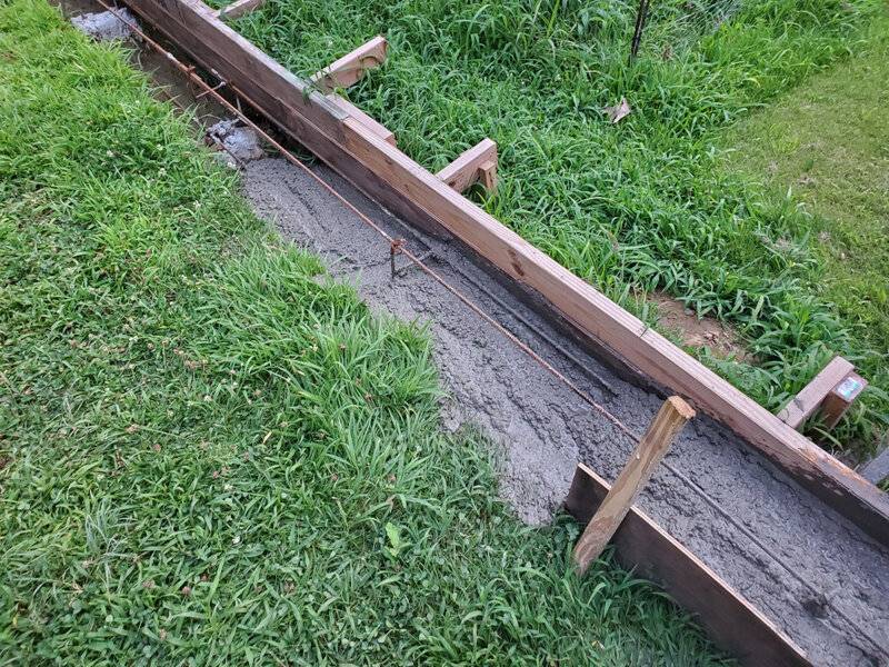

Just finished up another session of 21 bags . . . and this time I waited till later when the sun was behind the trees - BIG difference.

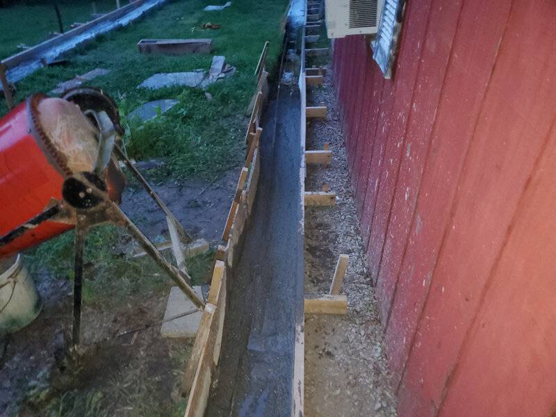

Got the 21 bags done in just over an hour . . .

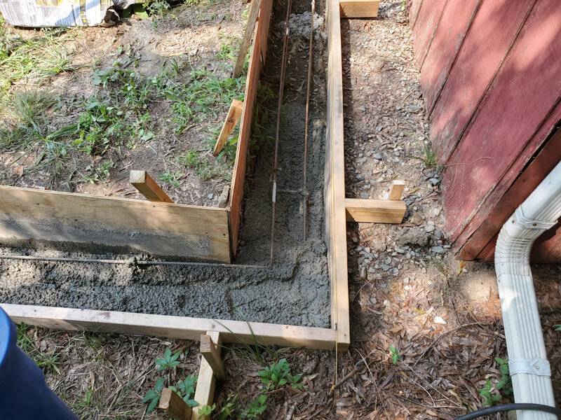

You can see how I stagger the height over a large distance to allow the next pour to (hopefully) better blend in . . .
Basically the money that I saved doing it myself almost paid for my lumber . . . Was it worth it ? ! ? ! ?
Maybe next time I'll pay someone to do it . . . But while I can still do it, I'm going to get 'er done myself !

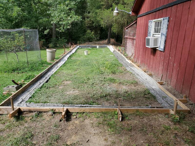

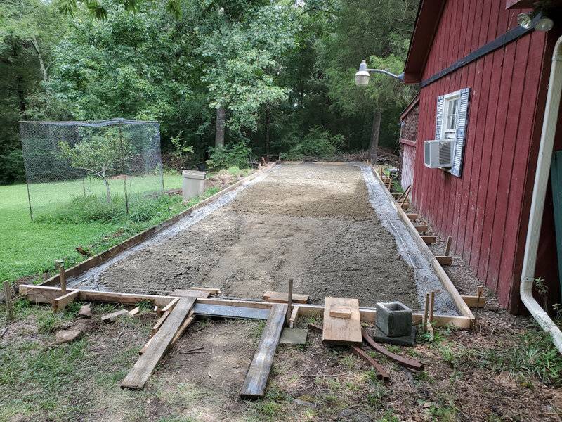

Got all the footers done now, next get the center section dug out and crushed stone in and compacted . . .
Sure glad to see this . . . 1 week in the waiting - and a bit of work to boot. What a great site !
Here's all 211 bags in the dumpster . . .
And . . . after cleaning up the area, it's sure looking nice . . .
The protruding rebar will have the wire mesh attached, so the slab and pad are tied together.
Concrete will go up to the top of the wood forms, so I'll have at least 4" on top of the existing footers for additional strength.
That will be happening . . . soon . . .
Final tally:
221 - 80 pound bags of concrete mix - 17,680 pounds
proof it shrinks
Actually . . . 1 yd is 45 bags, not 42 - 42 is a pallet. So I was 15 bags shy by buying pallets.
IF I would have bought 45 bags at a time, I would have been right on - and this was a WAG . . . Wild Arse Guess . . .

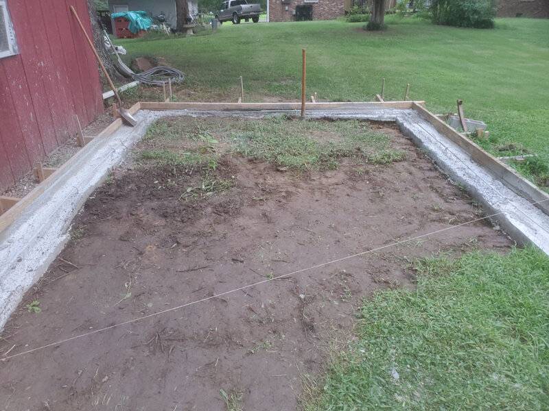

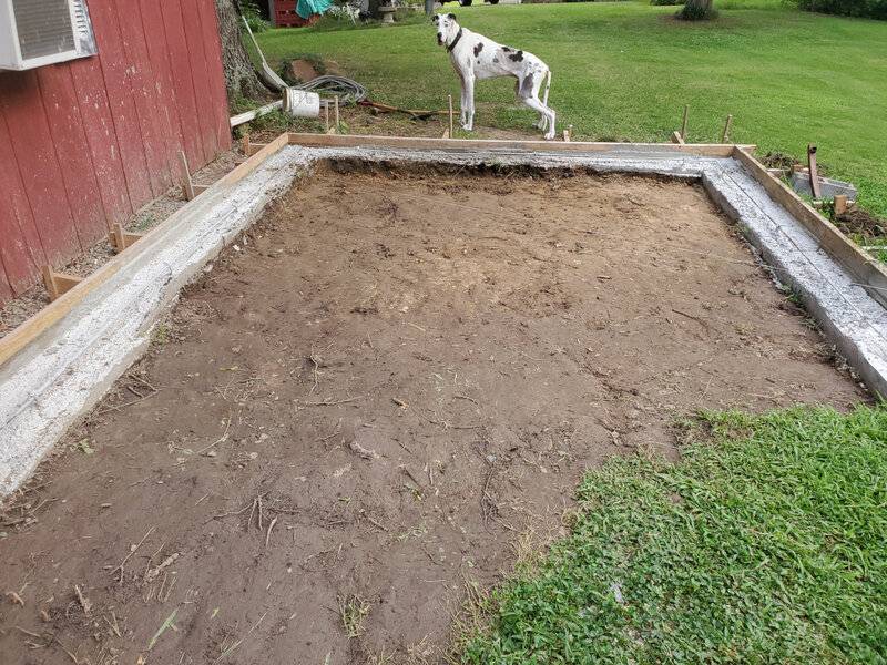

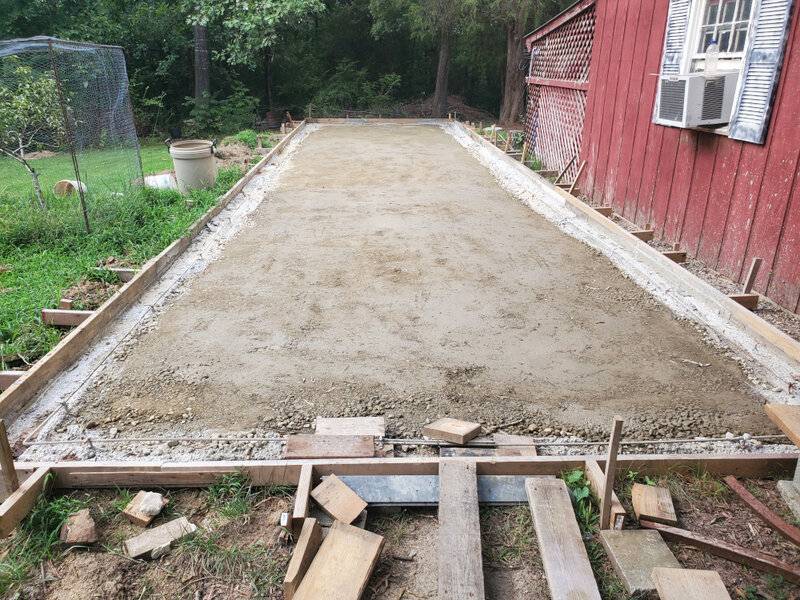

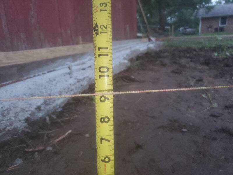

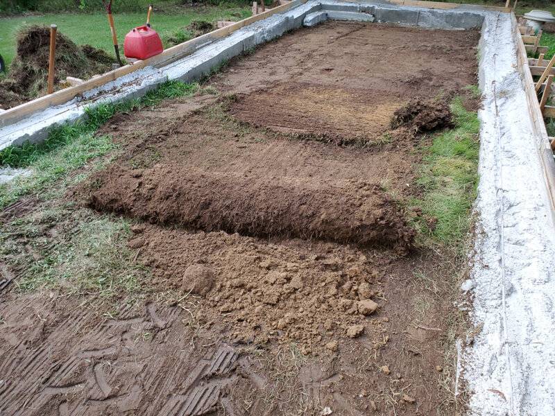

Looked up the "required minimum" of compacted crushed stone under a garage floor, and it says shoot for 4 inches.
By stringing a line between the tops of the wooden forms, it was easy to see that 3/4 of this area was already there.
So I started digging it by hand to not disturb too much of the ground below . . . and I made great progress . . .
In this area only 1" was removed from the top of the existing level . . . I'll take it . . . close enough . . .
After about an hours work . . . this is all that I have left to complete it - and then get the crushed stone . . .
Looks like that'll be happening by the end of the week . . . though we are expecting rain tomorrow
(that'll sure help to loosen up this adobe brick that we can get in the heat of the summer here)

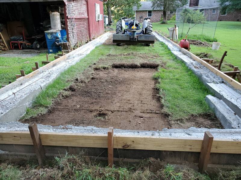

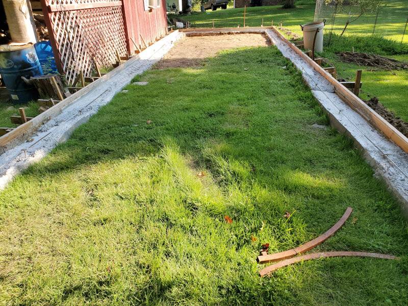

Yesterday I got all of the elevated stuff done . . .
The poor old man keeping an eye on my work - and inspecting it . . .
Got quite a bit of grass still there . . .
Had I known it ALL had to come out . . . I would have thought this through a little earlier . . .
My concern is the Rebar/wood forms that I've got protruding from the footers and "how" to get the tractor in side ? ?
But . . . I made it work . . . and if I can catch it just right, it rolls up in very big sod rolls . . .
Think I've got about 2/3 of this thing knocked out already . . . see the big sod roll . . .
Looking good . . . ran out of daylight . . . hope to get crushed stone delivered tomorrow, and the mesh will be delivered.

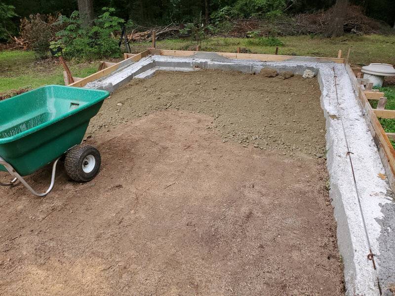

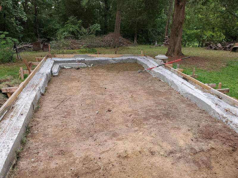

Got the entire pile of crushed stone in the footers . . .
Rented a compactor, kept wetting the stuff down, and compacting it . . . and I think I'm good . . .

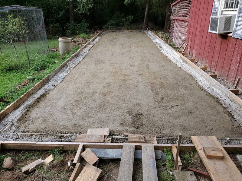

Ran some lines to check this for level . . . and I was NOT happy . . .
It might "appear" to be "okay" . . . but there was quite a bit of height differences . . .
Rented the compactor again and worked the lines the entire length of the forms to get it better . . .
NOW it has a pretty solid 4" depth the entire surface area - it had as much as 1 - 1 1/2 inches of difference in places
( of course all of them were high - which meant only 2 1/2" - 3" of concrete thickness . . . did not want that )

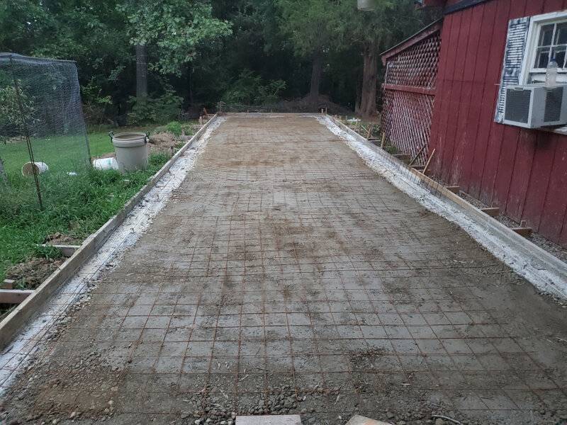

Plans for today . . . get all of this mesh wired into the rebar, wired together, stand offs holding it off the ground,
And ready for a concrete pour . . .
More to come . . . and hopefully a picture of concrete SOON ! ! !

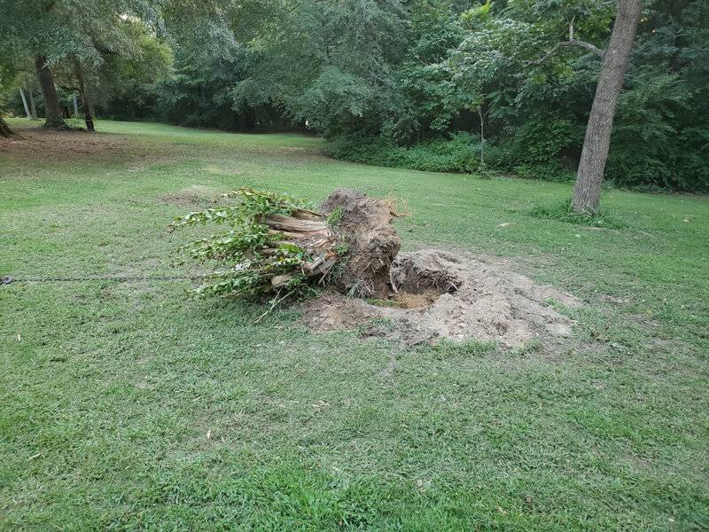

Well . . . that stump is massive . . . and the thought of digging it out . . . so it SAT . . .
Till this morning - rented a trencher and trenched around the thing . . . the I wondered IF it would come out . . .
My Chevy Silverado (with 370,000 mile on it) has been good to me . . . and it pulled (pun intended) through again . . . .
Had to make sure I could drag it out of the hole . . .
Now what to do with it . . .
Anybody wan a huge Crepe Myrtle root ball ? ? ? I swear, you can't kill these things . . .

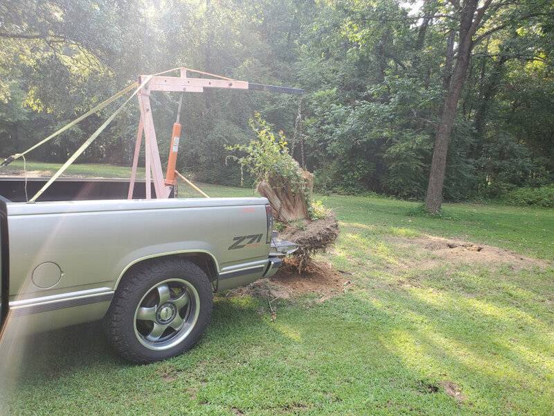

Needed to get the huge Crap (spelled that way intentionally) Myrtle out of my yard . . . so . . .
Red Neck engineering at it's finest . . .
It sure was heavier that I thought it was, and my truck was not too happy about it . . . either . . .
But . . . it's now moved and gone . . . FINALLY . . .
This was the same "method" that I used to move my Hemi and get it dropped into the Belvedere . . . and I'll have to do it again.
