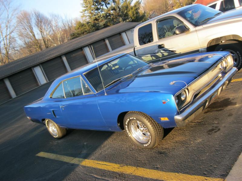

Looking forward to getting my first Mopar together here with ya'll! Been years of dreams and finally pulled the trigger on a decent start/driver '70 'Runner. Only three days in my garage and finding plenty to keep me out of trouble for weeks to months . . . IMG_0943.jpg
Want to rebuild the front end with the polygraphite kit from PST like I did to a second gen Nova back in school. Any Mopar particular warnings before I snap something?
