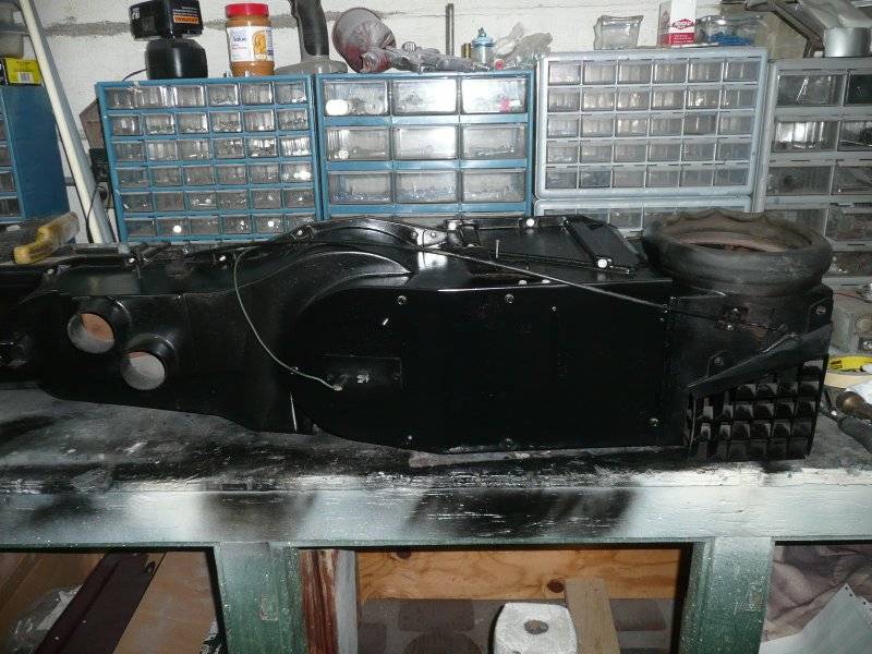

I was reminded of previous owners' shortcomings/shortcuts just yesterday when we had Fred out and about:
He had the heater box out and spruced it up some back in 2009 - but I was reminded yesterday that the main flapper
door in the thing is rotted out at the bottom on its' pin, so when you try to move it with the dash control, it just goes
wonky. I have to pull the box out and repair it properly now....which won't be easy, given my medical state.
I rigged a ball valve in one of the heater hoses a little while back to help with the situation...

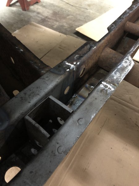

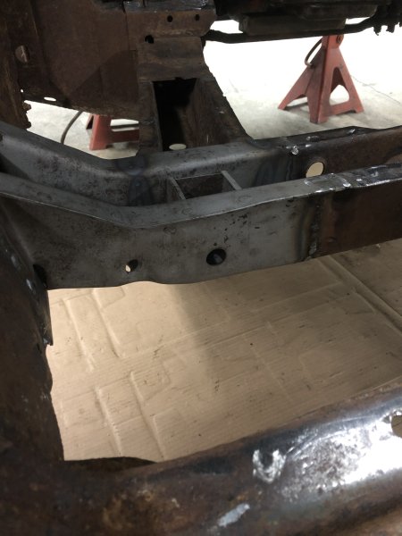

Back to car repairs, my RR had a bad drivers floor, and the very end of the crossmember was soft. What to do? I got a piece of original stub, cut out the offending end, grafted in the new piece, gusseted the inside, welded it inside and out, and to the front frame rail end, POR15, new floor on with plug welds, and called it a good fix. Mentioned it in a thread somewhere and got a reply that once the “abortion” broke and sent me in the ditch where I was to die, he would take it off my families hands and part the port piece of junk out, where it should’ve gone in the first place! Nice sentiment I think! That was 5 years ago, and I ain’t died yet!
