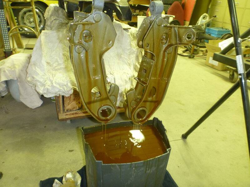

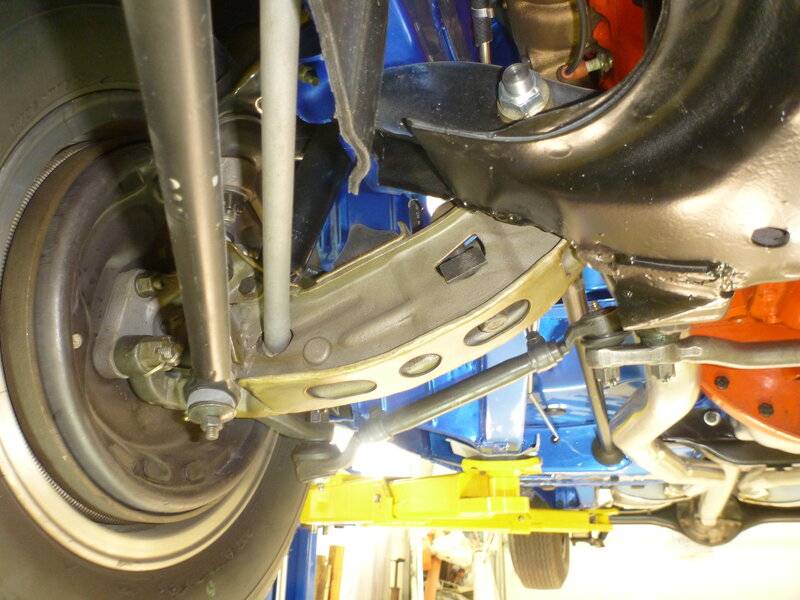

It’s like old fashion quasmoline. Used on guns and other items during shipping
Doesn’t that stay sticky? It’ll pick up road dirt right?It’s like old fashion quasmoline. Used on guns and other items during shipping
If you’re talking about Quasimoline, it’s a paint, that drys hard with primer underneath.Does it stay sticky? I like the gold finish too. Was going to ask about that.
Here’s the thread that I got the information from.Does it stay sticky? I like the gold finish too. Was going to ask about that.

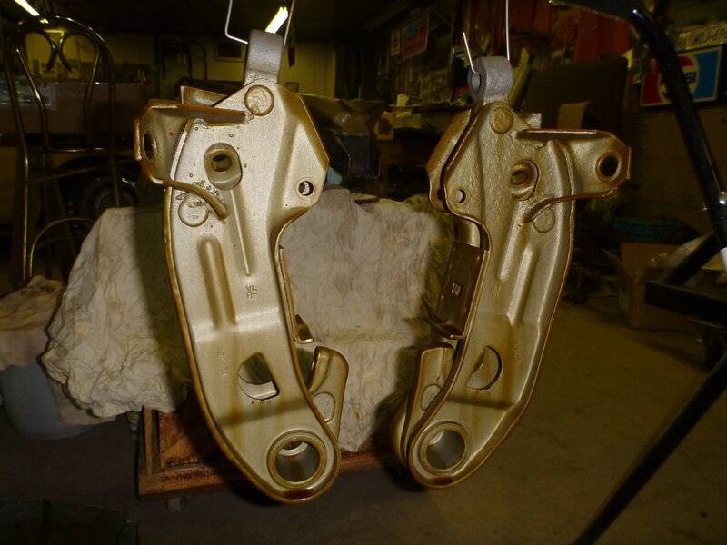

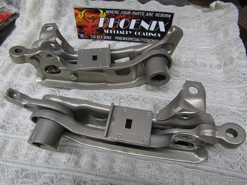

You don’t dip it, it’s a spray on.I just read RestoRick's product description. It says it dries hard, unlike the original product. It's pretty expensive to dip the way dadsbee has done, unless you're doing multiple sets of LCA's. I may go with SEM chassis black instead.
That makes sense, I actually like to find out if I can have it powder coat it that color.I've already done mine with SEM chassis black. I don't know how well SEM will hold up over the long haul but chassis black has unusually strong fumes.
I don't currently have the ability to spray anything. I'd have to dip like dadsbee.
I've thought about powder coating as well, but there's that rotating part the torsion bars slip into.
They certainly are pretty. Doesn't the part the torsion bar goes into, which is supposed to rotate, get glued in place when the powder coat dries?

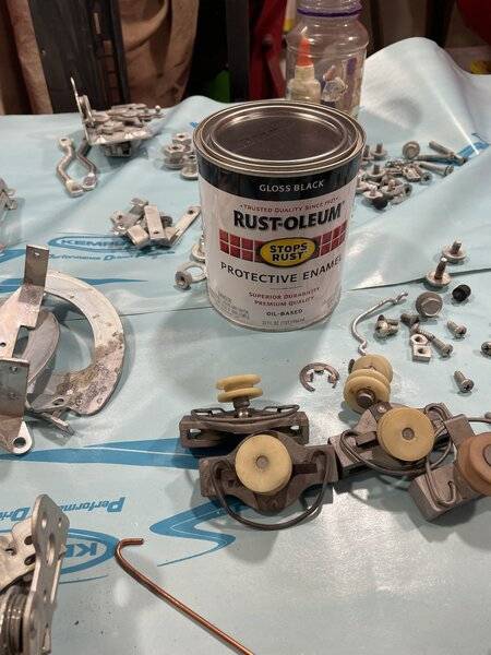

I’m getting ready to add a coat to door mechanisms and additional coat to k member
