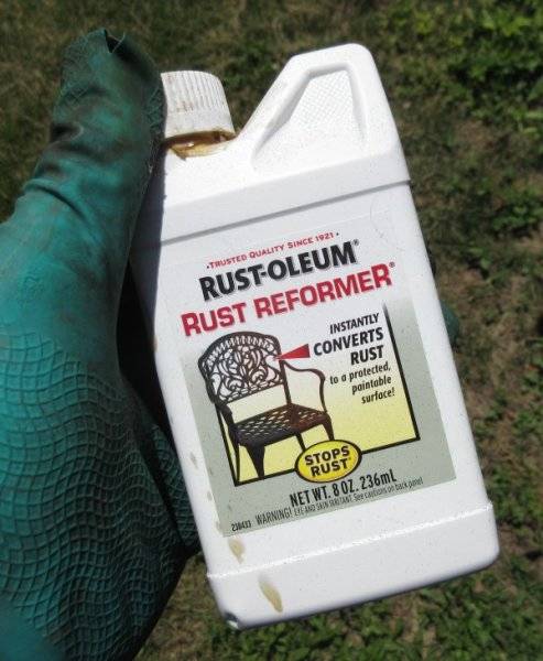

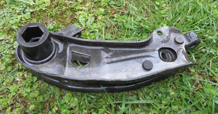

Almost there - I'm getting a black substance on the metal now, maybe it is time to change the vinegar?

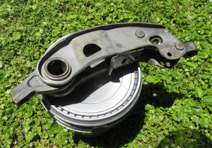

I've got a little damage from trying to get the torsion bar adjuster bolts out with my impact wrench -
Anyone think this is worth worrying about?
No your fine just soak the threaded bolt in rust buster. Second option heat the nut and remove bolt.

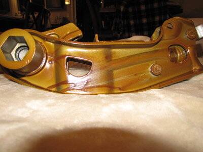

"Let them dry overnight . . ." I blew the rinse water off one of mine with a leafblower and then immediately followed with a heat gun, and by the time I had it dry it was already flash rusting.

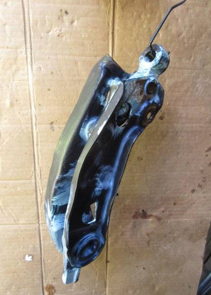

I got a surprise when I went to put a 2nd coat of Eastwood Chassis Black on and I found a can of Rust-Oleum Pro-Grade Rubberized Undercoating in my hand instead. It was going on a little funny but I thought I was putting the paint on too heavy trying to get into every knook and cranny. Well, it was a mistake but I have to admit that it doesn't look bad and will likely hold up longer. Now I've got to figure out how to treat the reinforcement plates. I guess I'll leave them bare for the welder and hope I can figure out how to prime/paint the portion that will be inside the LCA later - although there will be little to no access. Maybe the stuff for painting inside the subframe rails will work. I doubt it hits every spot.
All modifications should be done before any finish is applied. Your welder guy is gonna love you. LOL!
I'll remove the undercoating in the area that's going to be welded. After 3 months removing it under my car, it's my specialty.

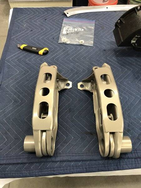

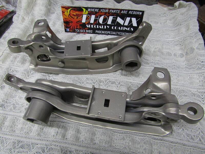

When it's done right, powder coating is only a few mils thick and will not interfere with your torsion bars seating properly. The insets CAN be blocked / masked off, but keep in mind any unprotected metal will eventually invite corrosion. This is the only Powder **** pic I got of @68Runner's LCAs before my camera battery died. He has more on his build thread.

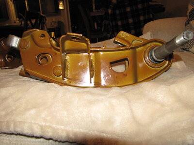

Have you got a picture of the bottom of that, so I can see how the reinforcing brace goes on?

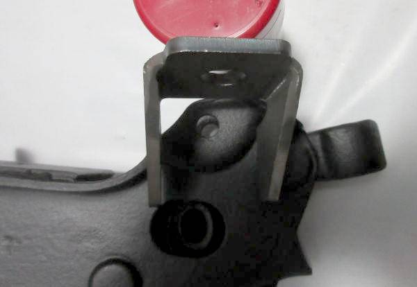

Have you ever seen one of these Hotchkiss sway bar brackets -
I can't quite see how that is supposed to go on. That 3/16" steel side is surely not meant to bend around the top of the LCA like the stock brackets do.
