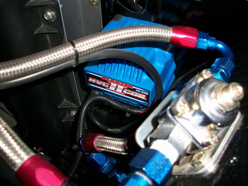

i put a set on my Hemi because the moroso's had been on and off so many times the ends were starting to fall apart. nice plug wire, they do seem to be providing a little hotter spark, between those and the blaster HVAC i added a few months before the wires i ended up going to one heat range colder on the plugs. between those two items it starts better and seems to run a little cleaner cruising around. didn't really see a noticeable increase in ET that could be validated. he did mine in person at the race track, gave me a pretty good deal. nothing wrong with MSD's or Accel's, i still use those also. my dart is a street car, i drive it all over the place.
