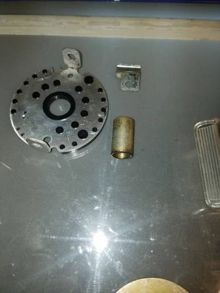

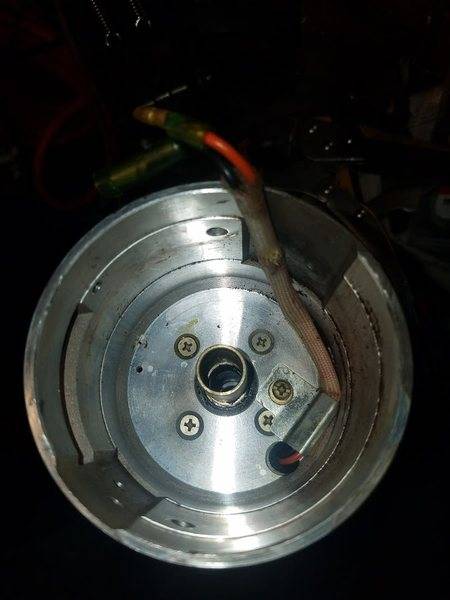

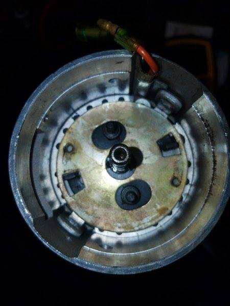

I have 2 of them, rebuilt one long story here are some pics of the guts if this helps or not
yes, definitelly pretty much the same kind of piece than the MP/Mallory one that I already have. REALLY APPRECIATE these pics. Maybe the plate for the pick up assembly could fit tighter, or maybe not...
Nice look the wires coming out from underneath the dist assembly, and well... bearing instead bushing. I'll keep in peace with the one I have at this moment for loooong time.
what? it is bushing! not bearing!!!
maybe easier to service it! neat design thought!
MORE reasons to keep the one I have for LONGER time LOL
lol yeah I kept thinking where is this bearing thing coming from that's why I looked for more pics I had hope it helps.
yes, I was told it was bearing!!! maybe the RTR is ?, dunno! But I'm not into the RTR deal. The RTR is a nice upgrade for those originally points ones helping on the stock look on engine bay without any module around, but I'm happy with my module on engine bay, being 74, is the way it came out.

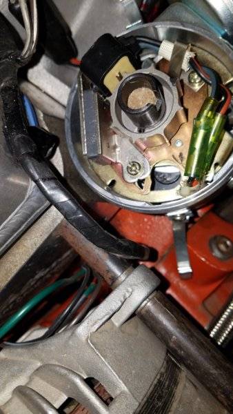

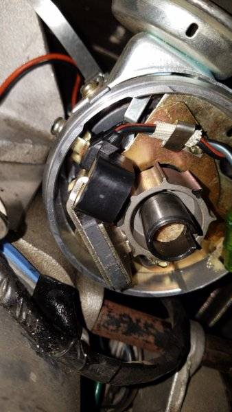

The MP/Mallory is pretty much the same mech adjusting setup than this Firecore. Is the one I already have. The diff with this, is the MP/Mallory setup is built in on same stock housing and bushing, and this firecore got a new and neat housing design, but working the same than the stock
RTRs are dist with ign control built in, no exterior ignition boxes.
this is the interior of the MP/Mallory built. And replacement pickup coils doesn't even need to be cut, since the hosuing is the same stock one
The ONLY advantage I can see on the firecore is how the bushing can be serviced. as I stated... REALLY NEAT
