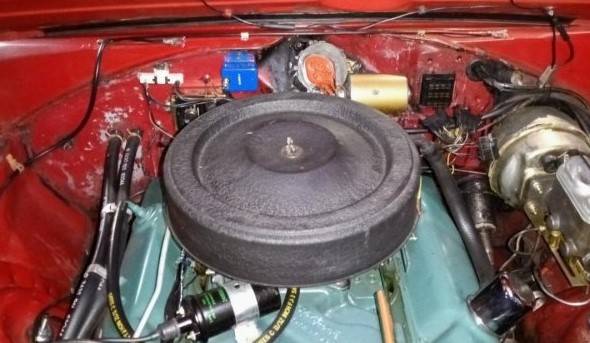

Excellent results with Lacquer thinner, green scrubby pad, toothbrush and Dremel tools (wire brushes & 180& 280 buffing pads). I'm halfway there and am very pleased with the results.
you are way to aggressive with scrubby pads, 180 and 220 grit, and wire brushes. Also the lacquer thinner is harsh.
Ok, so what would you do.
Napa 4810 brake cleaner will remove paint. Paper towels pick it up, any tough or thick areas a toothbrush will loosen.
You know he's not trying to strip bare, right ??
Yes I’m well aware, but his results are getting him to bare metal. This brake clean will not remove paint with hardener, it removes cheapo rattle can paint.
Thanks, guys, for the input. I spent a lot of time searching the web with various google searches but never found a post or video that showed using lacquer thinner. Many sites just said use this, use that...etc but never showed any before & after pic's, or how they achieved the look they were looking to get.
Now, I will say that using the various chemicals probably got me some of the bare metal in spots and I know that I may have been too aggressive in some areas, but it definitely was trial & error. I will say it is possible that some of the bare metal may have already been there from back in the day when it was repainted Red. Then someone came along and put the Black on top of the Red. No idea what that Black paint was but it's definitely hardened as well as getting baked on with the engine heat.
At the end of the day, I like how it's come out and hell if I decide to paint it with a rattle can someday at least I have a better surface to work with. That Black firewall looked like hell.

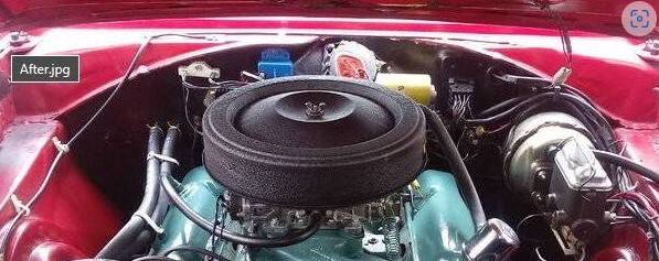

Spent a wet raw dreary rainy day in the garage tackling the other side of the firewall. As the area is much tighter to work in, used a small spray bottle with lacquer thinner in it. Really worked out well to spray/soak the black paint & continued to use my Dremel brass wire brush to scuff off the black thick paint.
Pretty much have it all done but have some areas to touch up and hopefully will be sunny next weekend so I can work outside & wash the engine bay down to clean it all up & then shine up the firewall.
