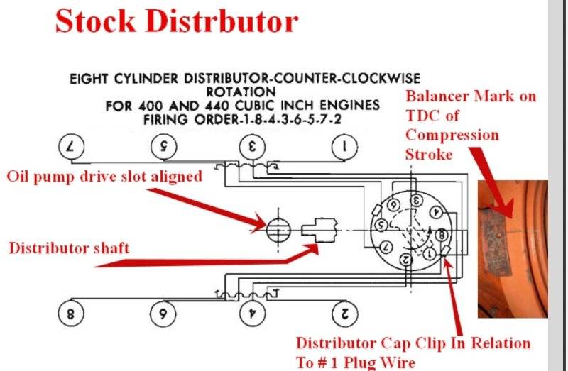

I noticed though that with the stock cam still in place the dots on the Timing Chain matched up, and the Timing marks also were on "0"... so that was good however the dizzy on the distributor was pointing at the "7" cylinder, not the #1 cylinder. Why is that?

Tomorrow I am installing the new cam. I have to then make sure the dizzy is pointing at #1 at TDC correct?

I just thought the distributor needed to pointing at #1 cylinder when at TDC.

Are you sure it wasn't aligned up with #6 instead of #7, One and six are companion cylinders. You likely were 180 degrees off. You were looking at 1 at the bottom of the exhaust stroke not the compression stroke.

Best results for align the distributer is if you shoot for the 2nd pic. Where #1 is doesn't really matter as long as it corresponds w the cap. It's just easier to follow this so the vacuum advance isn't in a bad place and you have to resequence all the plug wires..
