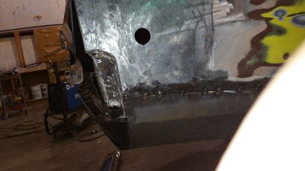

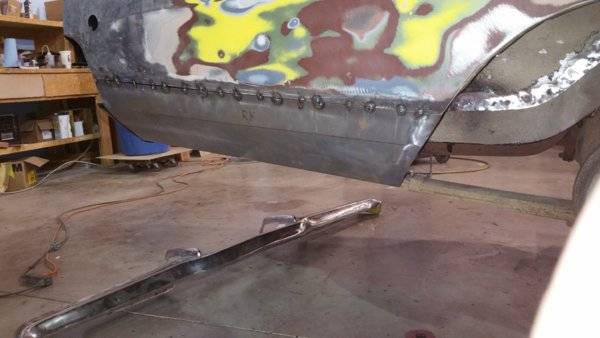

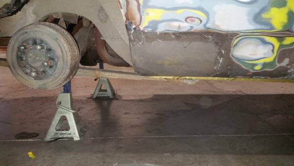

Time for my weekly update. The work is moving right along. The quarter and wheelhouse patches are done and tacked in. You can see the repairs to the inner wheelhouse in the second picture. The left wheelhouse needed more work, but the picture didn't turn out. I continue to be impressed by his work. The quarter patches and wheelhouse repair patches were fabricated by hand.

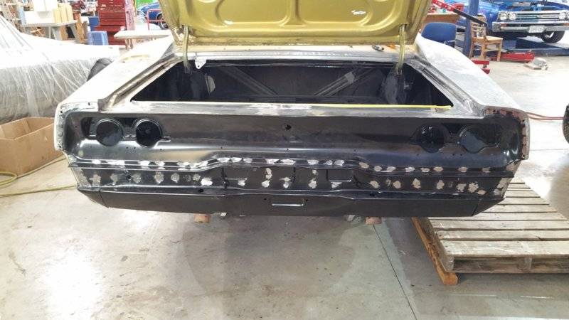

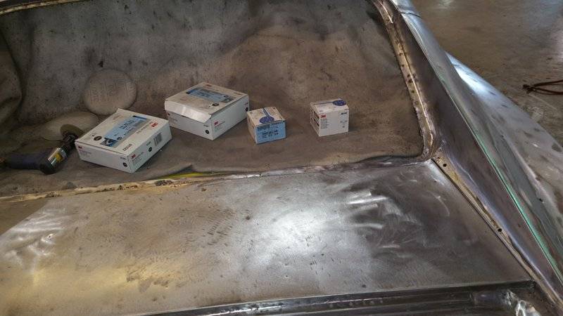

The trunk is almost done and he has the lower valance and tail light panel mocked up for final fitting.

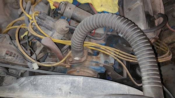

Since I want to use a serpentine accessory drive, looks like I need a new water pump housing.
Finally for this week, given I want to stay with manifolds, it looks like the factory plug wire routing is my best bet. Casting number on the manifold says 70-72 383-440. The date stamp on the motor is 'J', so it's a 73. I wonder if I should order the plug wire looms for a 68. 70 or 73?

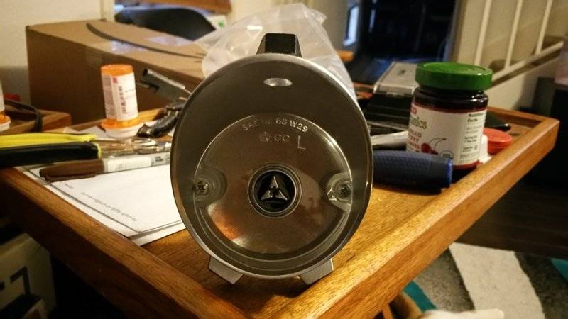

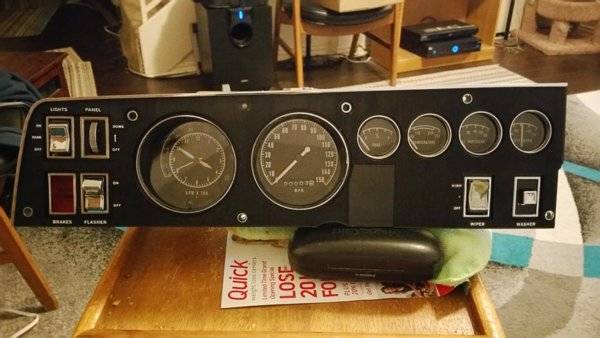

I'm working with a shop on my 68 Charger restoration, but I'm trying to still do some myself. I just finished the instrument panel. Nicest looking one I've ever had. I will say getting the defrost block off plate in was a pain. That and the bezel had tons of ejector pin flash I had to remove. The grill restore is next. Still shooting for summer!

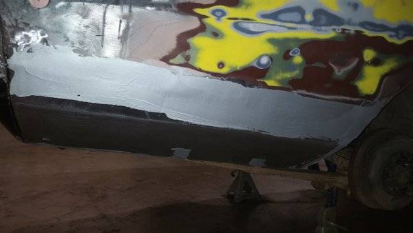

It's been a while since I had any progress, the shop has other work and the honey-do's have not helped. I got the front turn signals redone and have been amassing the new disc brake parts. The car should be in first primer coat in a

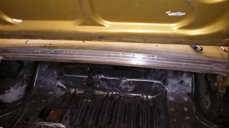

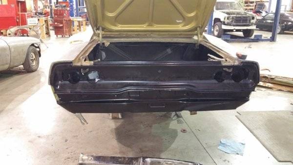

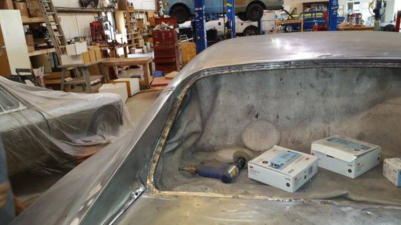

I stopped by the shop today and the rear is almost done. These pix do not do Jerry's work justice. He replaced the upper trunk gutter, and made the repair part by hand. The work fits perfectly and I couldn't be happier. He even saved the sequence number stamp. The panels are all welded in, touch ups and seam sealer are next. There are a lot more pix, here is the link:

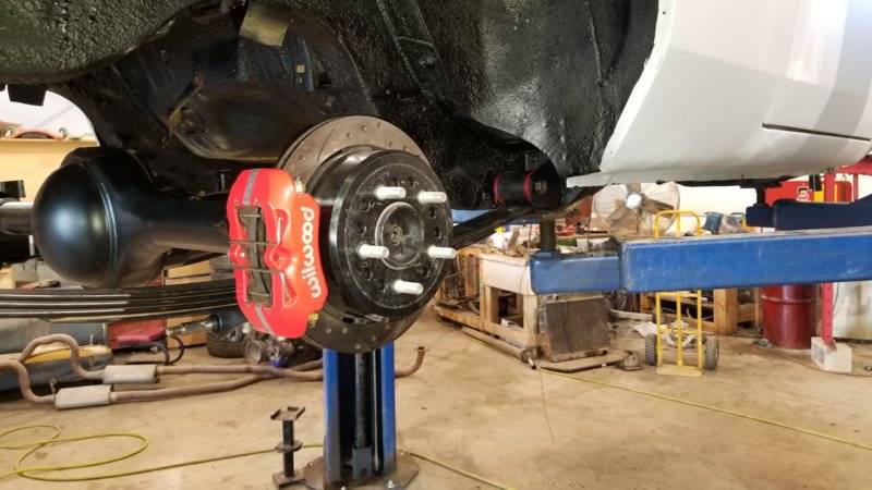

This was waiting for me when I got home yesterday. Slowly getting it together.

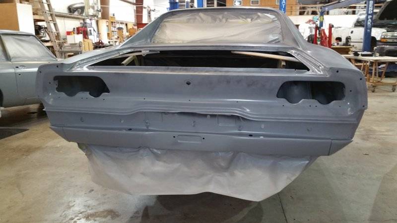

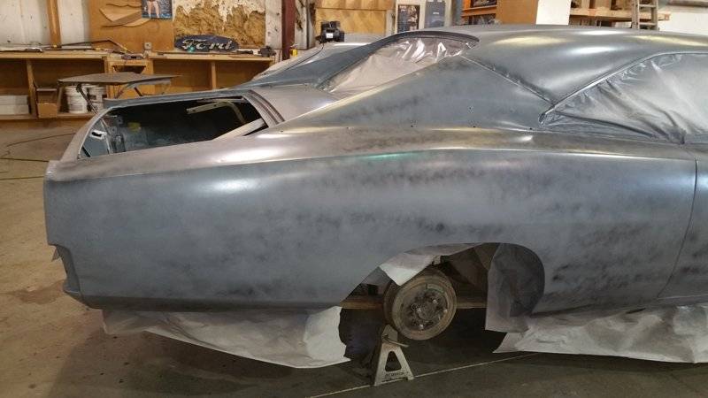

The car is finally in it's first coat of primer. Lot's more work to do, the interior is being worked on in parallel. Engine will be dropped off soon and I'll go through it while the shops presses on with the other work. Exciting times.

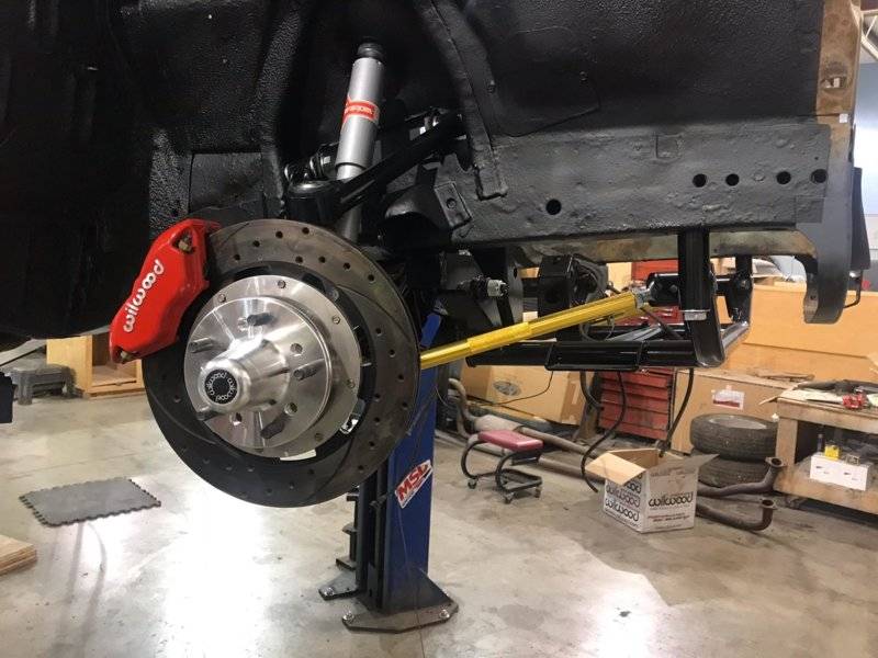

It's been a while since I've posted so here's a small update. After removing all the front suspension and K frame for cleaning and painting, it was obvious a lot more than upper arms were needed. I couldn't get a deal worked out for a K frame (mine was bent and strut rod mounts hosed), so I went with QA-1. In order to use that part in my 68, the newer sway bar, links and lower arms needed to be changed. Might as well add the strut rods too.
