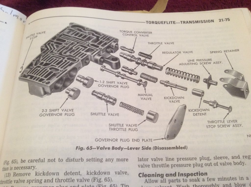

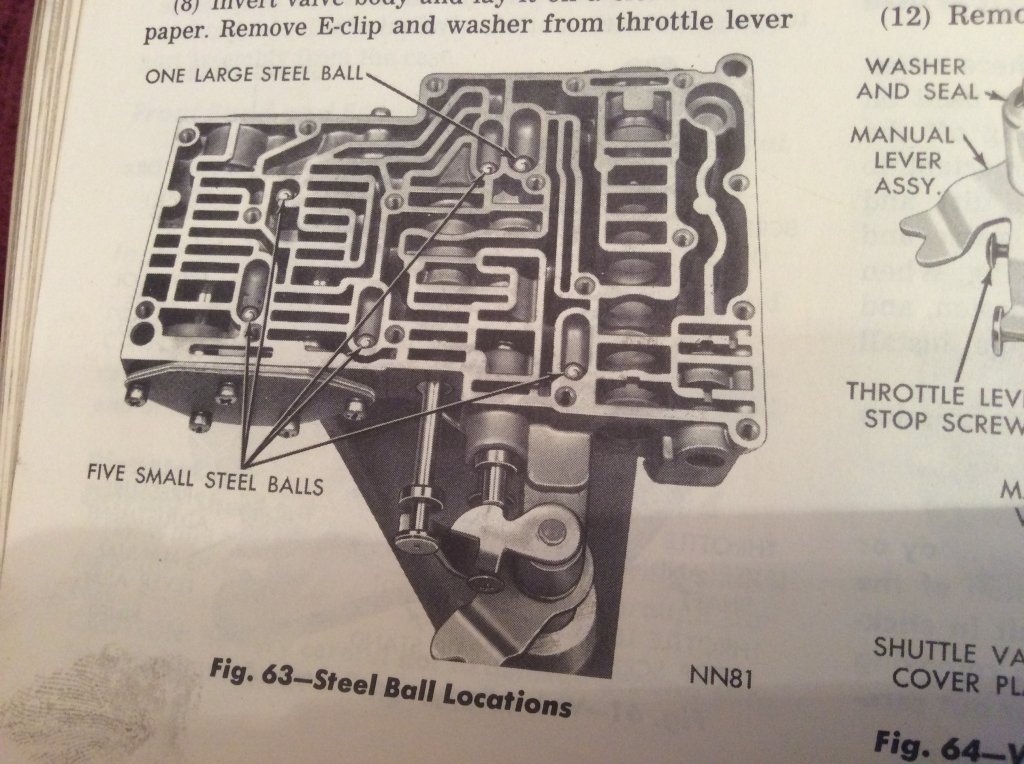

No gasket in valve body just a few balls to lose and they aren't attached to you. If you have been driving the car and owned it before it started it probably a stuck valve or a weak/broken spring if I remember. Will post valve body pictures tomorrow if I don't remind me. Think I posted some on earlier post. The pump sucks fluid through valve body to pump and there is no check valve, to the and I think to converter.

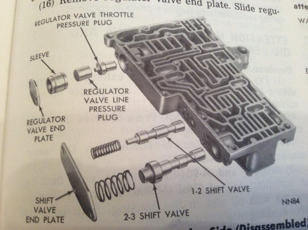

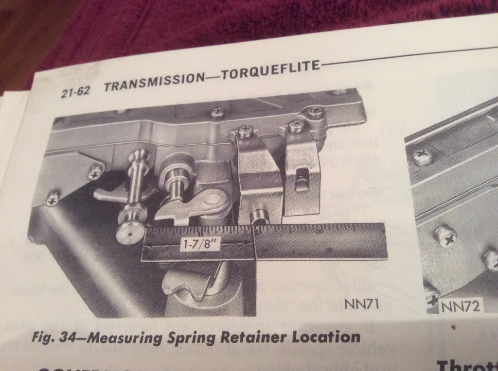

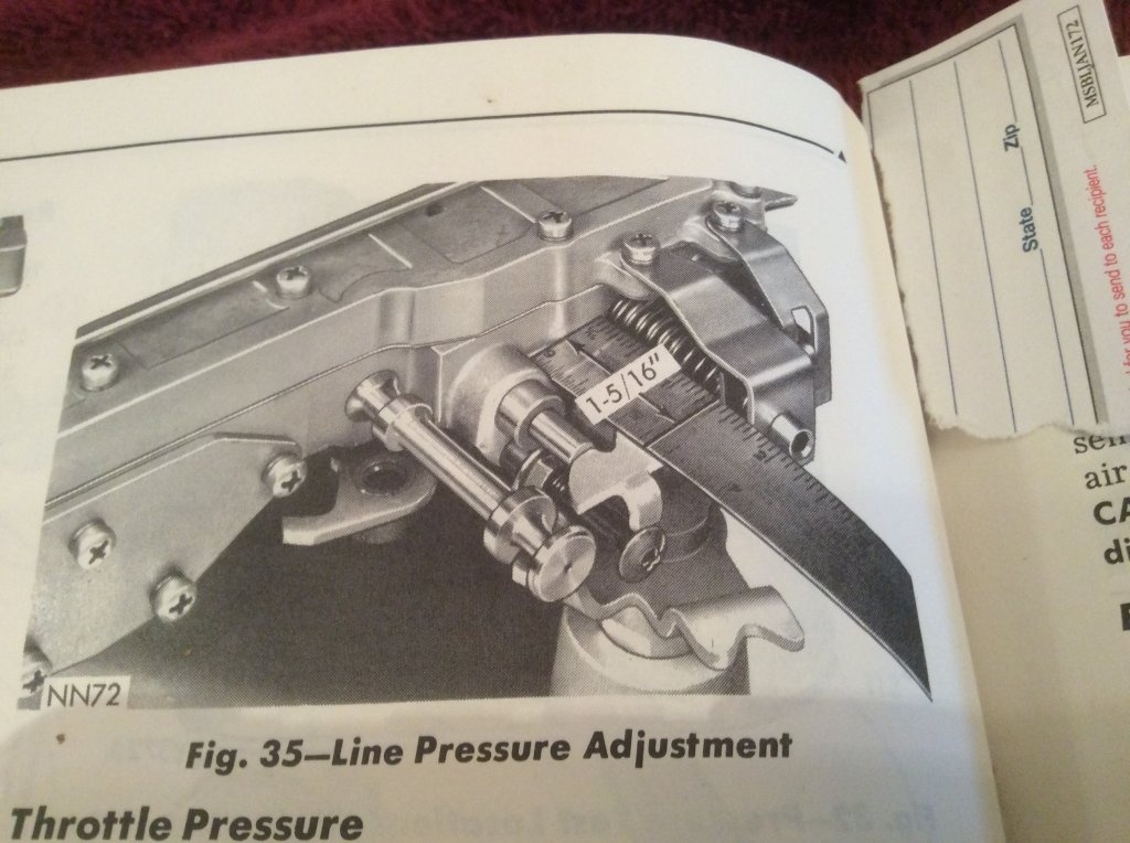

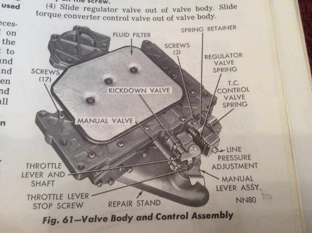

I'm loading 6 pictures of valve body the third picture has the Torque converter control valve with spring. My opinion this is your problem with converter drain back. You could call this a check valve. Gummed up or spring weak or broken? Maybe miller can comment on this. If you need pictures or text of something else let me know. Only problem sometimes with text file size can be a problem.
Could easily be. But, it's all just parts and pieces, two by two stuff. Get the right parts, and put 'em in right. First thing you must know is the year of the trans, and is it an A (small block), or B (big block). Guessing a 727B?
Much of the parts are same, some no, some are year dependent. There will be some parts, depending on year, sorta hard to find. Used parts...some good, some not, you have to decide. Just like your slightly used, whiny pinions.
The page photos Blacker posted are good, but you will need pages for the year you have!
Suggest you read some on dealing with a shift body. Must be absolutely clean. Sharp edges on the valves, and they are a close fit. No scoring/scratches on the vale bores, on and on...?
