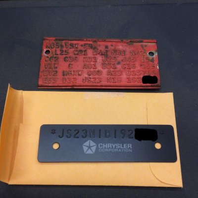

With proper documentation and proof you can get a new VIN tag here. My example is below. It came with a project I just got. The fellow said it was a lot of emails and phone calls and showing the build sheet, fender tag and body stampings (proving the car is real). And it wasn't cheap. By no means am I implying yours is a reproduction, just pointing out they can be remade.
http://www.datatags.com/
