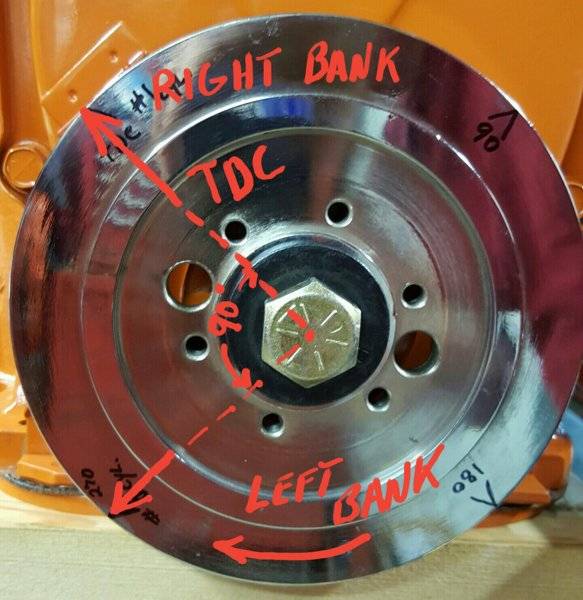

And here's another tidbit.
When priming, start with TDC crank location. This location lines up the oil passages in the cam with the right side head passages to the rockers.
Turn the crank clockwise one revolution and stop at the 270 degree mark and the oil passage in the cam is lined up with the left head passages to the rockers.
Are you sure it's only 90 degrees of crank rotation to line up the other oil passage in the cam? Cause that's only 45 degrees of camshaft rotation. I'm a little unclear on this. I had a hard time lining up the cam on my 451, to get the passenger side rockers to pre oil. Although the drivers side oiled right away, as I had the crank at TDC of the firing stroke. Also, be sure to turn the drill counter clockwise on a big block, to get the pump going.
Gary, I belive you are correct. It would be 270* to line up the oil passage for the left bank.
I only have done this twice, trying to find a definite way to line them up. Once when I was assembling the engine, once right before the cam break-in. Having to rotate the engine while priming takes two people and I don't always have that option. I'll edit my post.
I'm thinking that if you have degreed your cam this will be off that much also.
Next time I take the valve covers off for inspection, I'm going to document the whole procedure.
