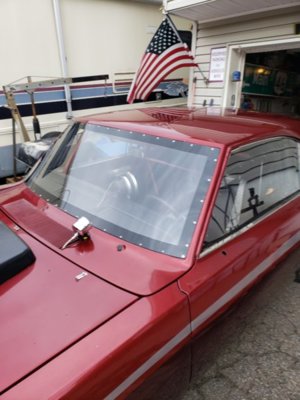

After looking over the car and thinking a bit, I came to the conclusion that a very rigidly mounted aluminum seat as compared to my stock cushy seat was what I was feeling.
I found a couple of " weak links" with the lexan install.
I need longer screws in the bottom of the windshield where I couldn't reach to put bolts in.
Side window outside gaskets didn't work out, so I'll push the bottom of the windows out from the inside of the car before next outing.

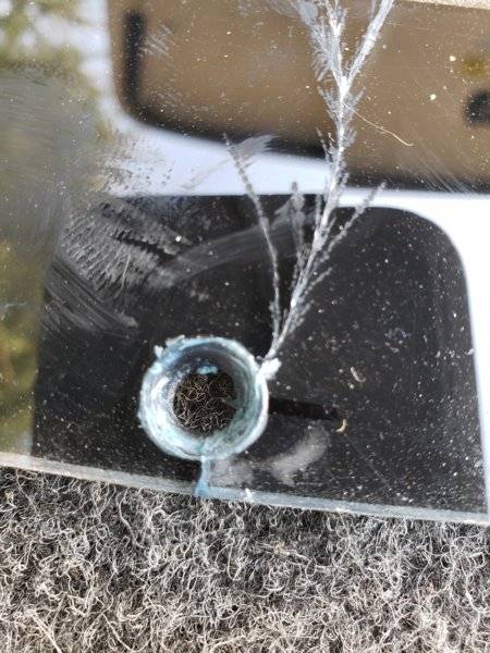

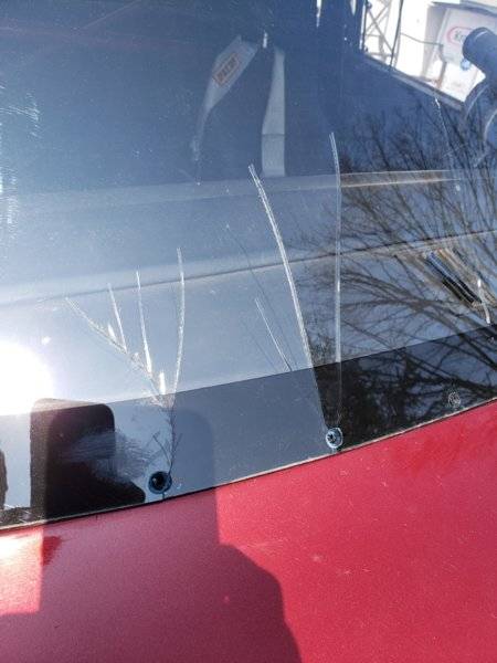

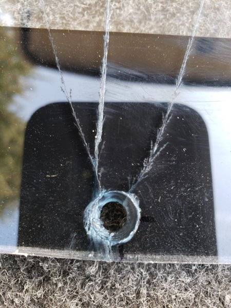

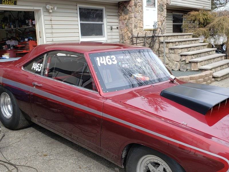

So I found what not to do to secure your lexan windshield.
After going to the track the other day I found some of the bottom screws loosened on my windshield.
I drilled the holes on the bottom a bit too large. Stupid mistake.
They were snug but the vibration loosened them up.
So, I decided to put some loctite on them .
A couple days later, went out to the garage and found this.
Lesson learned.

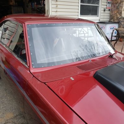

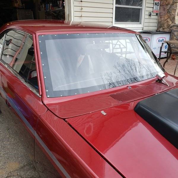

I bought another sheet of Lexan and made another windshield.
This time I offset the bottom holes and drilled them smaller.
I feel 100% better with this one.
Lesson learned.

Can you get a nylock nut on the back side too
if you have access
so it doesn't have to be so tight
& won't have the bolts/screws backing off either
just curious
I have nylock nuts on top and on the sides, I just can't access underneath so I had to use screws.
Nothing is real tight. If you look from the side, there are no waves where its bolted.
I oversized the holes a bit in the lexan and used a countersink bit to have them sit flush.
